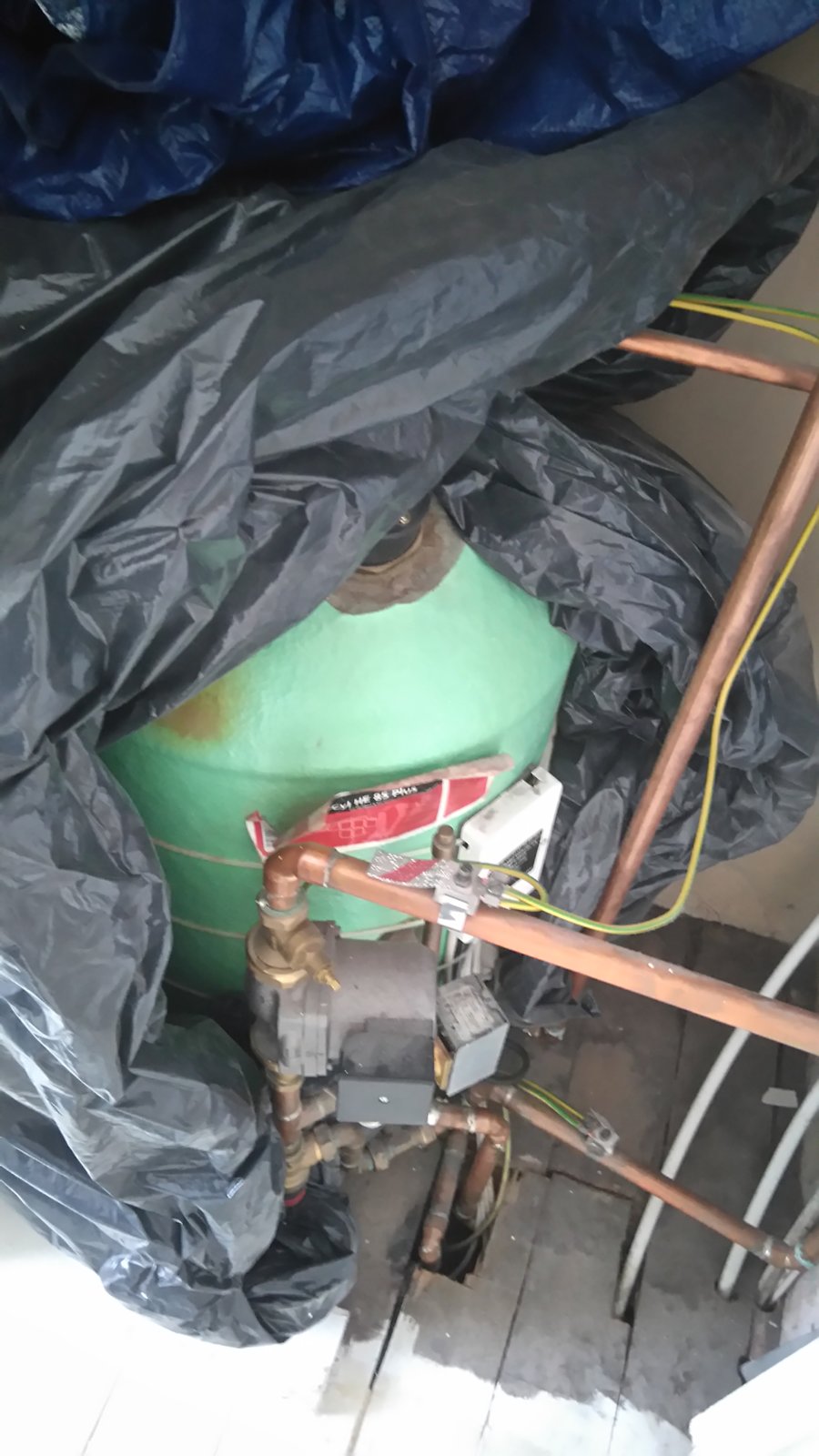

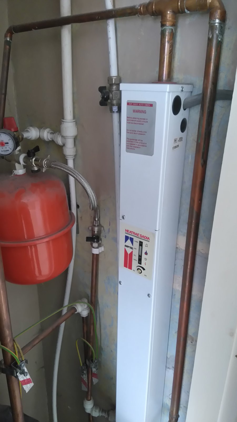

DSC_0839.JPG DSC_0839.JPG DSC_0841.JPG hello,,,I viewed a property today and it had an electric heating system,,,a heatrae sadia amptec,,,like a long white box with a pressure tank and copper cylinder,,,ive never layed eyes on one of these in my life and was wondering if any of you lads knew anything about them??? are they any good etc??? do they cost a fortune to run compared to a normal gas combi???,,,anyone ???

I've installed a few and can't say I'm impressed, but equally, they have not been any more problematic than any other cheaply produced appliance.
It's just a length of copper tube with a heating element wrapped around it and some hastily cobbled together circuitry to control temperature, pump and safety.
I have carried out a few repairs on them and usually the PCB, they are easily replaced but very expensive, they seem to work Ok just really expensive to run, the installation does not look very good though and a few problems with it, no supposed to solder onto the boiler tails, should only be compression or push fit.
Also I cant see any way the air could get out of the unit , it should have an automatic air vent at the highest point, never directly above the unit though.
