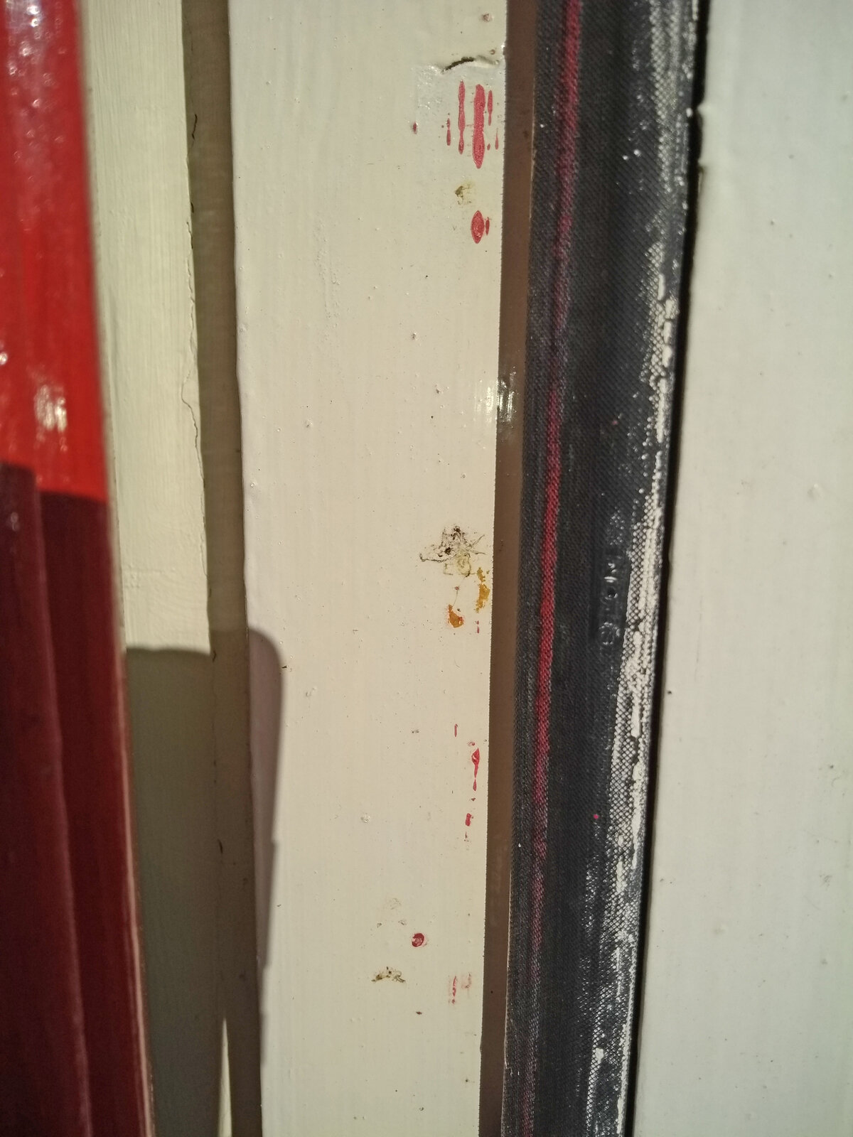

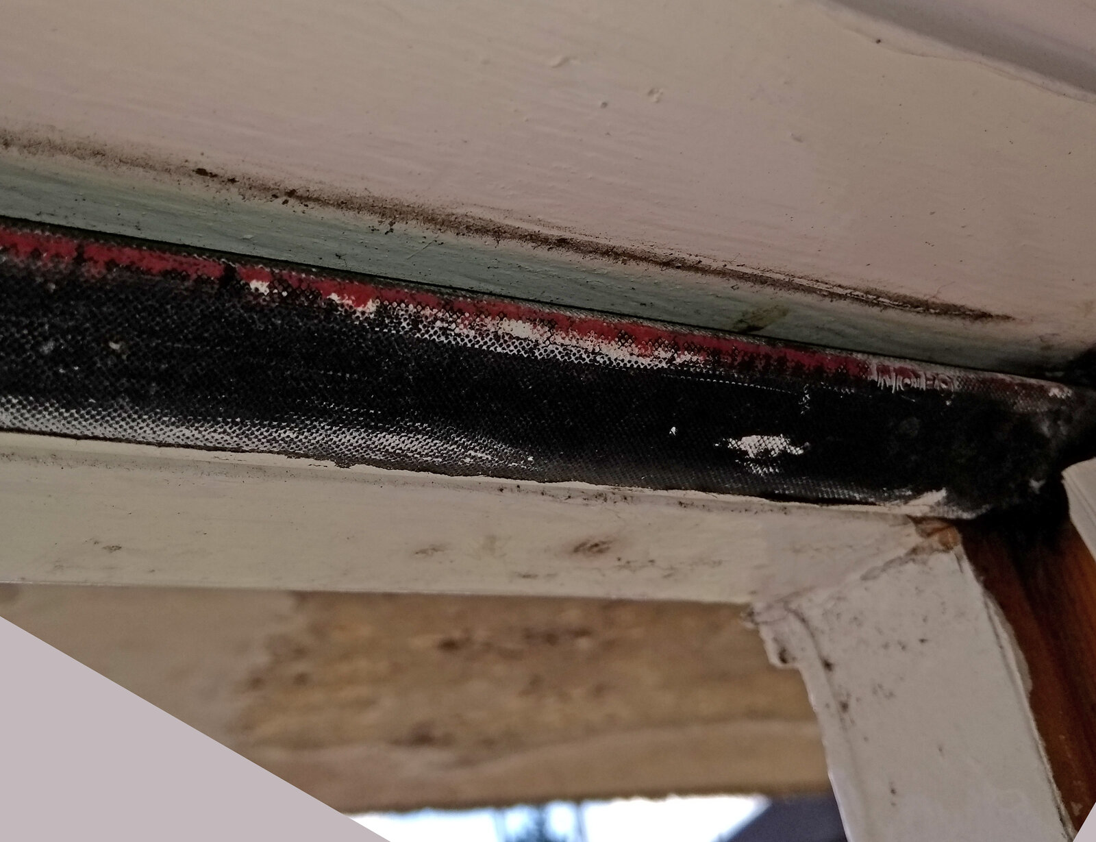

These are the seals in question. When the door is open, they are pretty substantial and actually uncompress to around 20mm from the timber frame. At the side of the door where the original seal is missing, when the door is closed, there is a 10mm gap where the original seal would have compressed and sealed - and that of course is way too big a gap for any modern foam seals to handle. The door is actually faced with steel. So I'm thinking on balance, it probably is the sort of seal I've already found but any other thoughts/confirmations appreciated. Thanks!

That seal in the frame looks like a Schlegal aquamac 21, its a plastic coated foam seal, its a early form of composite door in that its steel faced both sides around a timber core, quite common on 80/90s new build and social housing, IG doors made loads of these, might even have IG stamped on the hinges
@crank39 Just googled it and I think you're spot on. It had something printed on the sealing face but it was so faint, I couldn't make sense of it - and I see QLON in some of the photos I've now found. The social housing makes sense in this case too. What threw me was the bits of foam that aren't missing had worn on the sealing face giving it a shiny almost metallic appearance.
That's me sorted now I think - thanks.
