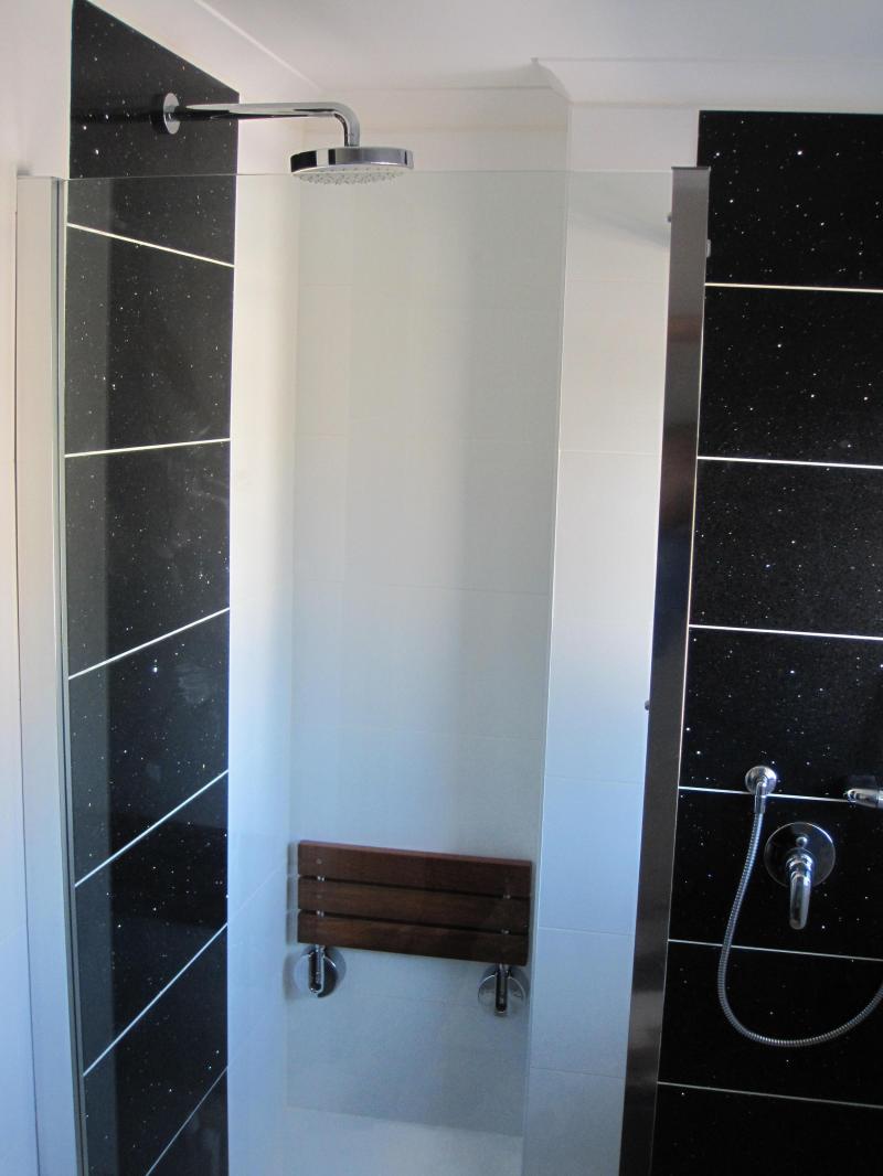

Thank you both for your replies. That has given me the confidence to do the job now. I must admit I had never heard of "Tanking" before but once I read up on it I bought a kit today and started to install it this evening.
I'll post some pictures once finished. :LOL:
