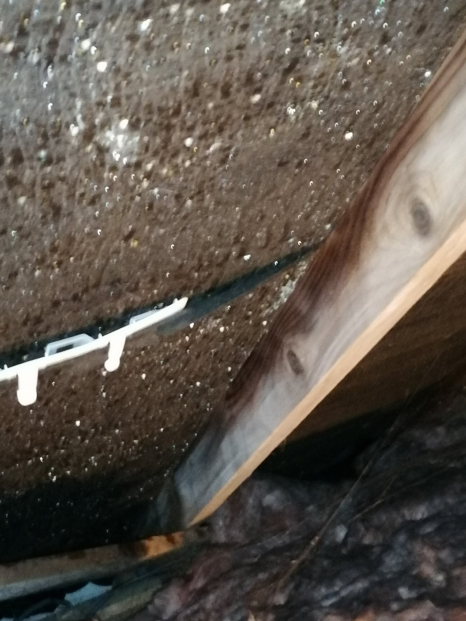

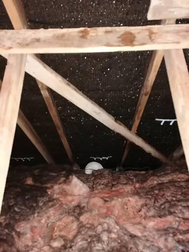

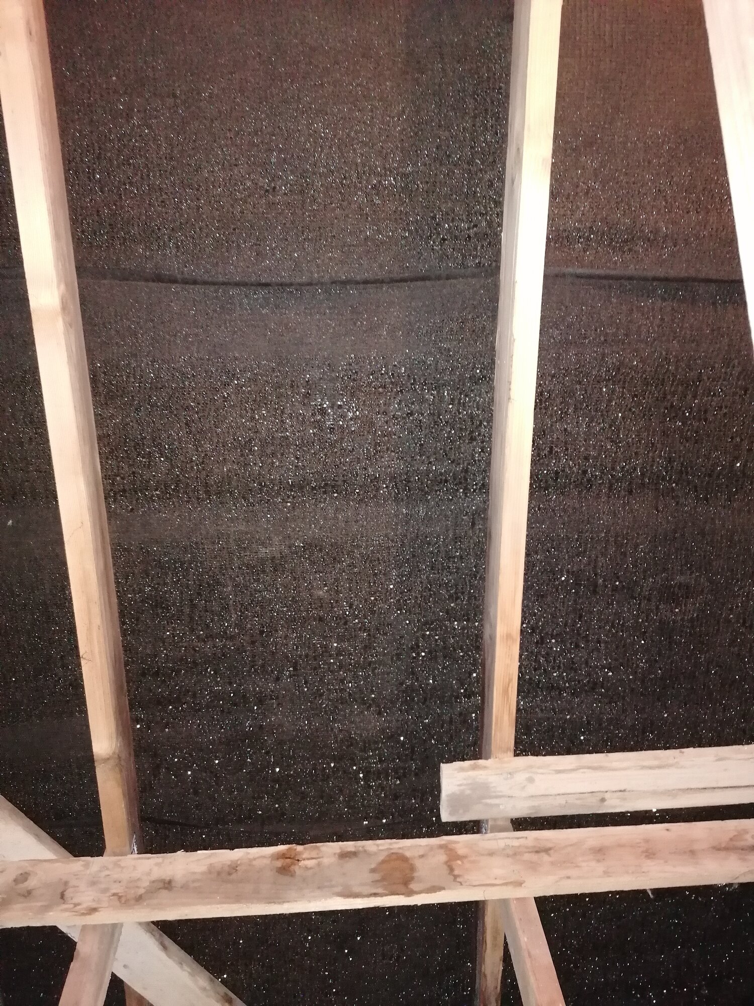

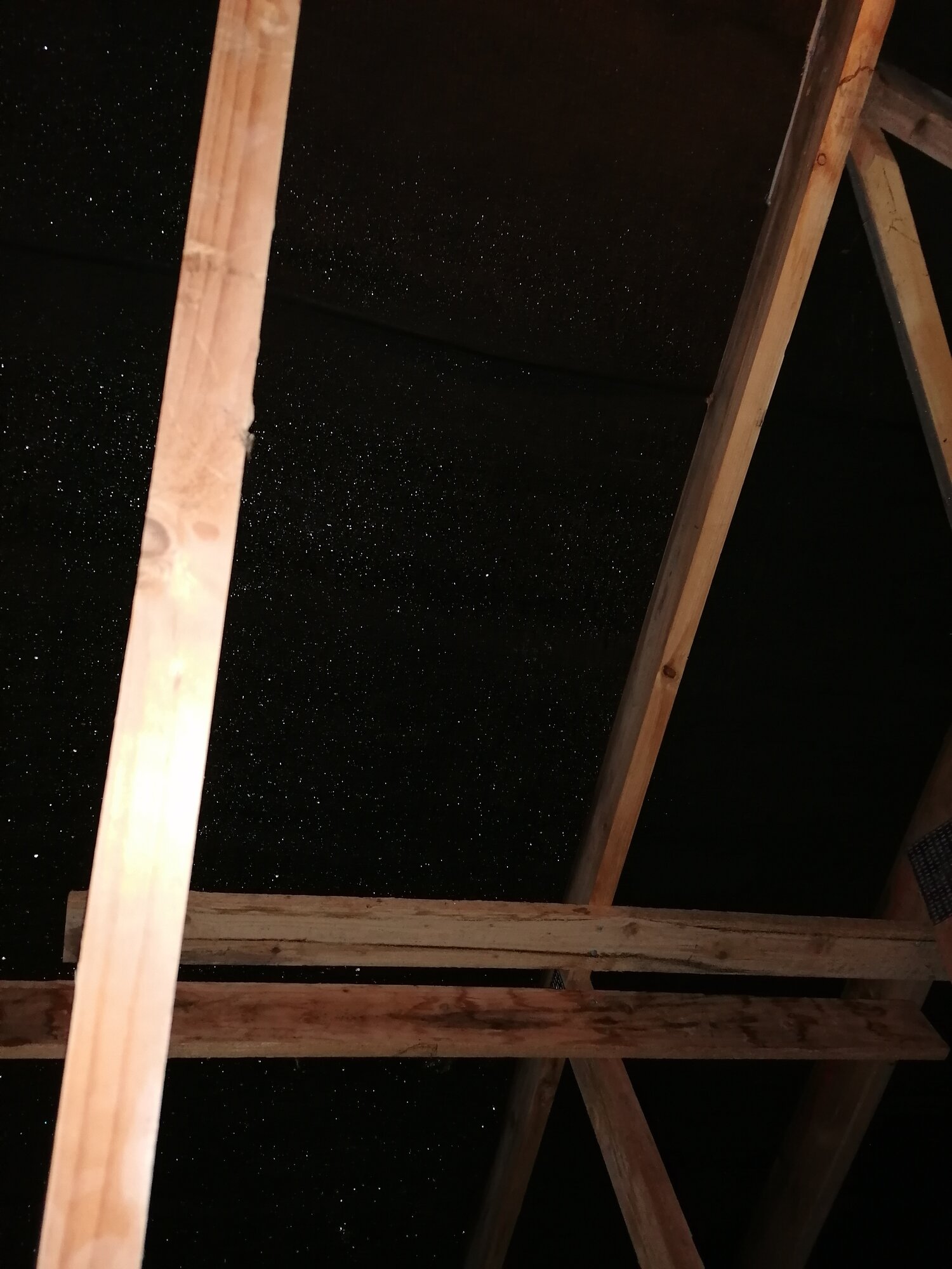

This is my first post and I'm hoping to get some advice on a case of extreme condensation in my loft. I've read the various threads I could find, but wanted to get your take on the solutions I've been offered by several roofers before taking the plunge.
I live in a small, two bedroom detached bungalow, that was built around 20 years ago. I moved here last Winter and when I first moved in, I discovered a major issue with condensation in the loft. It was across the entire length of felt, but only on the side that doesn't get any sun in the Winter. It was also more localised above the two coldest rooms in the house - the bathroom and kitchen.

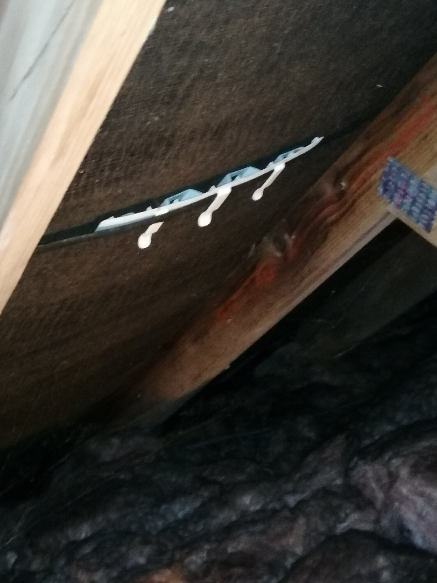

Towards the tail end of last Winter I installed throughout the loft some basic air vents that slide in between the felt folds and open it up to allow airflow. This significantly increased airflow and reduced the condensation problem, but did not eradicate it entirely. Prior to this, the entire half of the roof impacted was dripping wet and my insulation, beams and few boxes I had put up there were drenched. After the vents were installed, it reduced it to a point it was okay and then Spring was on its way. It seemed to dry up and I hadn't paid it any more thought.
I'd since forgotten about it, then last week a damp patch appeared on my ceiling and I popped my head up for a look and again, the felt was absolutely soaked through and dripping. Not as bad as it had been previously at its worst, but still soaking in places. (I'll try to include some some photos in the thread. They're a bit murky, but the lighting isn't the best up there.)

have you got holes in the ceilings, for example for downlighters?
an extractor fan is better than an open window, because it sucks steam out of the room. depending on wind direction, a window can blow it into the house. please explain why you think your extractors are wrong.
what is that white thing near the back edge in your last pic?
show us a closer photo, with the insulation pulled back please.

As above - moisture you are producing in the bungalow, is making its way up into the loft. I would begin by adding a proper extract system in the kitchen - a properly installed cooker hood, venting outside. Insist lids are used on all vegetable boiling pans, which will release less moisture and save fuel. Likewise the bathroom. Open windows only help, if the windows are on the lee side, sucking moist air out.
A dehumidifier will not help much placed in the loft, it will be too cold up there to work well, one downstairs though might help and make the house feel warmer. They do not vent outside, they just circulate air, collecting moisture from it. Some collect it in a tank, if you don't mind emptying the water collection tank often. Better is one which can have a small plastic pipe attached, so they constantly drain. I use one in our utility room, for frying clothes combined with a fan, it drains via a pipe into the dish washer drain stand pipe.
Overnight internal temperatures falling to 1/2 of 20C (10C) suggests your insulation system is not working very well at all, if true. My heating is set to come on during the night, if the temperature inside falls below 16C - it never gets that cold as to ever fire the heating up, even with sub-zero temperatures outside, as now.
If none of that works, you might consider adding an extract fan in the loft, again of the lee side of the bungalow.

I've had a couple of roofers up there this year to inspect at various points and they said the bathroom fan's trunking was not well fitted and needed looking at, as well as needing an improved unit. I just stopped using it altogether and the condensation was reduced, although not fully stopped. The white thing you can see in the photo is the bathroom extractor fan pipe. As for the kitchen one, I must admit, I am modern man and rarely actually cook and certainly it's rare that I boil anything, so the window usually suffices haha.

the insulation is either scattered or rolled onto the ceiling below. it will pull back so you can look at the extractor hose.
also, in daylight, with the insulation pulled back, please photograph the eaves. is there a gap you can see daylight through? how big?
You can get roof vent tiles, that fit in place of the roof tiles rather than the ridge, that will give greater airflow in the loft. When I moved into my bungalow the loft was really stuffy with a leaking roof and tears in the felt.
Roofer removed damaged tiles, slid in new felt to overlap the torn felt, fitted 4 roof vent tiles and replaced 12 cracked tiles. £500 quid all in.
Having been on the roof it was worth it to save me going up there, but proper vent tiles will be far better than your slide in the felt vents.
Check for leaking extractor fan vents. I had this in an extension - there was no ventilation in the "breathable" roof felt, and the kitchen extractor was leaking into the loft.
Sealed the pipes and added loads of flap vents, and all OK now.
Properly sorting that out, ought to be at the very top of your list.
Even when not in use, could moisture be escaping up through the extractor fittings/devices and into the roofspace if not fitted correctly?
If there's no mechanism to stop air flow when the fan isn't on:
- If the vent is near the top of the room, warm air will rise up it into your roof space
- If there is a breeze then it could be pulling air up it into the roof space
