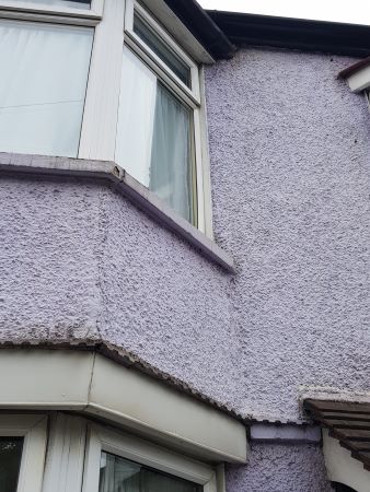

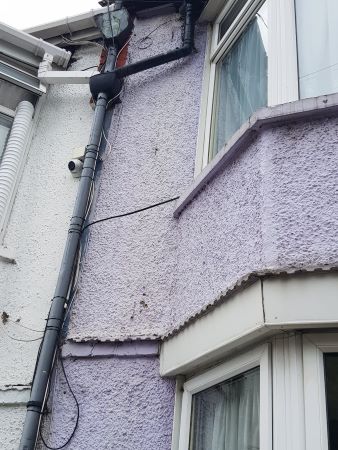

Can the helifix bar be fitted internally inside home as well ? All the videos / presentation show helifix bars fitted only externally and on plain brick walls.
One of the builder has told me they will install 3 helibars outside and 3 bars inside as well to make it more strong.

Why is your builder installing Helifix bars? Have they actually identified and diagnosed a genuine the problem or are they just telling you that you need them because of some minor cracking?
You need to replace the ground floor bay window with structural bay posts. Trying to "glue" the inadequately supported masonry above it together will not solve your problem.

Just to be clear, the crack is on the first floor bay and not on ground floor.

And ta @JobAndKnock for linking that pic. OP- the upstairs bay is only supported by the posts between the windows on the downstairs bay. The window fitters not bothering with structural props in there or not packing them up properly is the usual reason for saggy or cracking bays.

Sorry, I am not very technical. What should I do now ?
