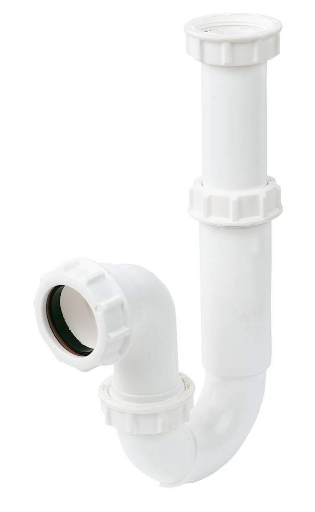

my name is Sue and I'm having trouble with my sink. Well, two things really.
I'll start with the first thing which is the trap. I fitted a new sink into a new worktop, the result being the new waste trap is now about two inches further from the wall than the old one was, and about an inch higher.
(sorry too old to do metric!) :)
I'm not sure if I could extend the trap downwards using an extra little section just under where the two wastes join together, above the final U bend bit, but I also need an extension bit going out towards the pipe that's in the wall, and I can't find the fitting I need for this - basically a straight line section with a 32 inside pipe surrounded by a 40 outer bit iykwim, that goes onto the waste outlet. (compression fitting? I think it's called).
Either that or I need to extend the outlet pipe itself so it comes further into the room - is there a simple way to do this for a bodging amateur? Or do I need to replace the entire outlet pipe and the pipe that it's fixed to which leads down to the outside drain?
I'd really appreciate any help with this...thought about using one of http://www.screwfix.com/p/universal-compression-flexible-waste-pipe-32mm/86148 these, but have no idea if it would work.

Would one of these: http://www.screwfix.com/p/telescopic-p-trap-40mm/28038 be of any use?
28038_P
It should solve your inch height difference and if you're lucky it may just swivel into the correct position for the waste pipe.
If not then use a short length of pipe if to the existing waste with a compression or pushfit waste connector.
Thanks so much, yes that looks like it would solve the height discrepancy. Excellent.
Not sure what you mean about the push fit or compression waste connector, that's what I can't seem to find anywhere - have only tried B&Q so far though as was stuck indoors till about 6pm. Will go to a proper plumbers tomorrow and ask...I saw a McAlpine swivel nut waste extension online and thought that might do it. (rjpryce I think).
Will deffo go for the telescopic thing though as well, many thanks.

With a short offcut of pipe to connect between the trap and waste, if that P-trap won't reach.
Proper plumbers' merchants will have all these. You might be lucky at B&Q, but if it's anything like my local one, they invariably run out of things.
