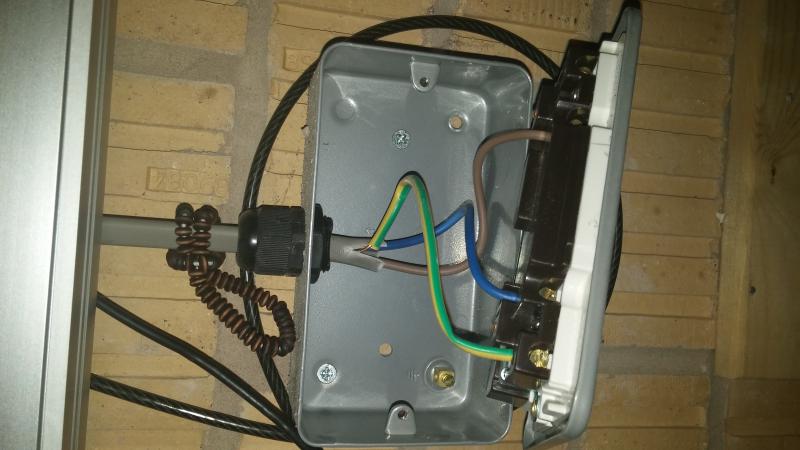

Thanks for your consideration in helping me. I am a bit of a newbie when it comes to electronics however i am competent at doing my own DIY. I have purchased a Weatherproof Double switched 13A outdoor socket to install on the side of my garage () i have also purchased some 1.5mm 15 Amp 3183Y 3 Core Flexible Cable to wire it into my garage.
My garage had electric sockets and lighting installed by an electrician which ran from the house and connects to my main circuit via some sort of fused boxed, thats about all i know. My question is can i wire this double socket into a plug and just plug it into one of my socket in the garage? Creating some sort of weatherproof extension lead for my garden tools? I don't think i can spur of the garage socket (something i have never done) as i believe this is a spur itself?
thanks for your advice.
Socket Purchased
Cable Purchased

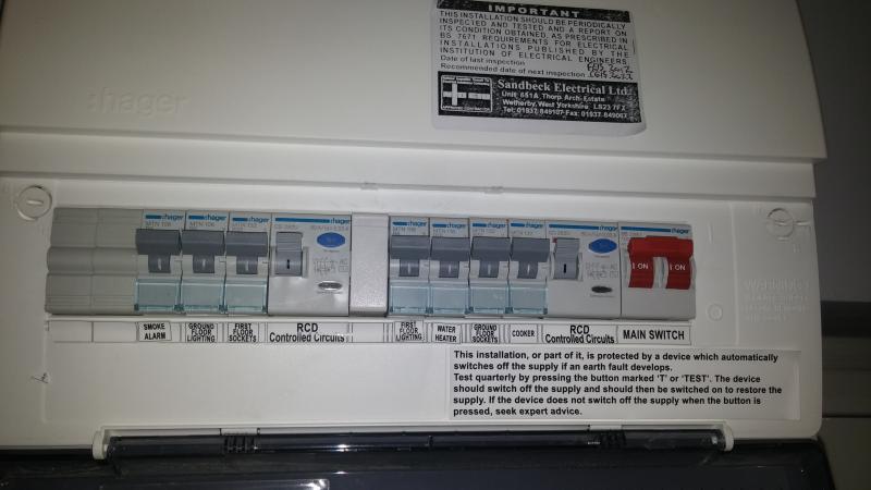

Ha-ha i will pray that my first go at a spur does not kill me, yes the photos do seem excessively large - i will take a photo of my fuse box and post a more suitable sized image when i get home. Thanks for your response.
So, it seems that all of your circuits are RCD protected.
So, with the garage circuit being supplied through the 13A FCU you will be OK to install that socket using the cable you mentioned.
Do drill out the drain hole in the bottom of the socket back box and silicone well if you are feeding the cable directly into the back of the box.
