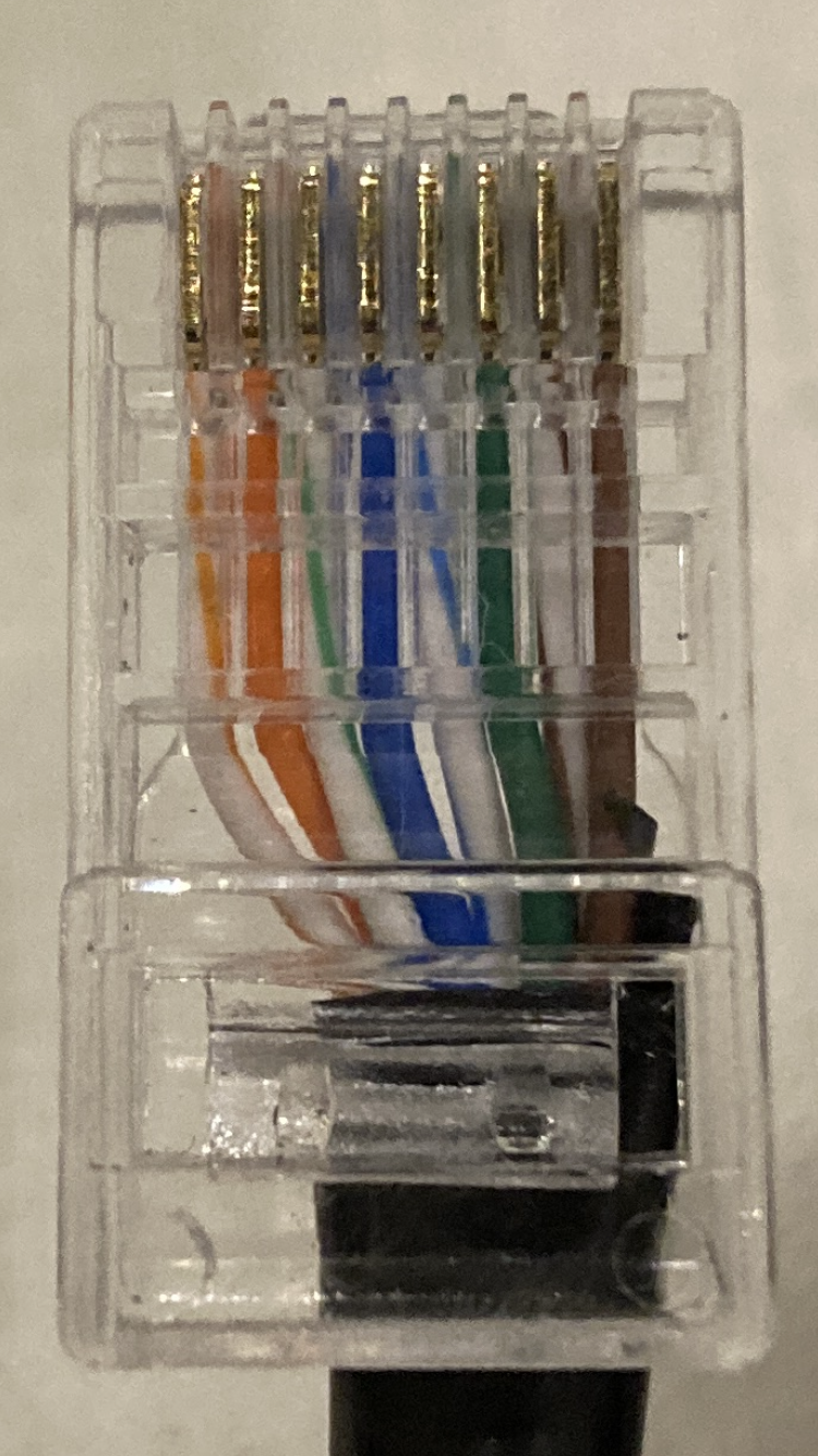

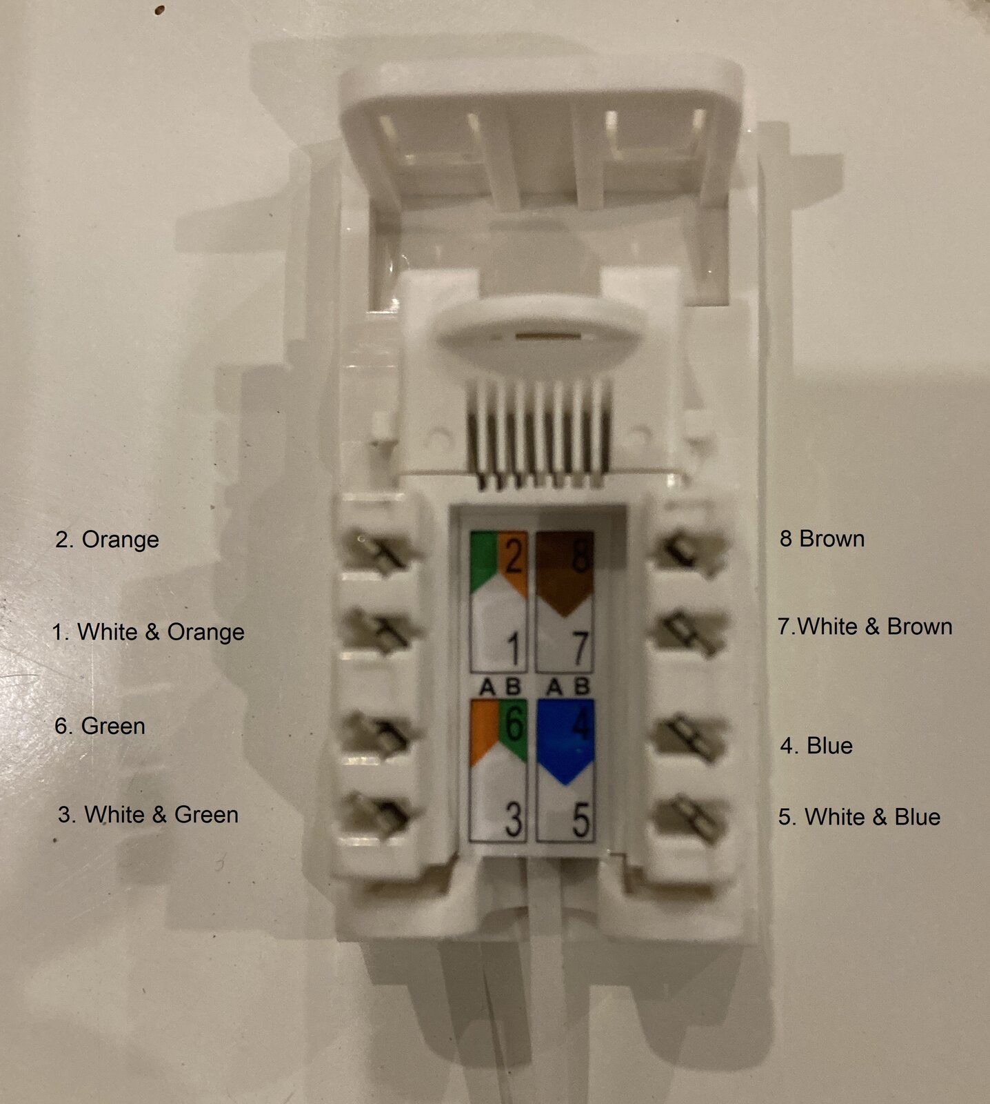

Could I just double check my understanding of the wiring before installing the cable and single faceplate this weekend.
After installation - In the absence of a proper RJ45 tester is it worth checking the continuity with a long piece of wire, or just connecting a laptop and do a speed check - on the assumption it won't do any harm even if there was a bad connection?
Ray
Yep, your connections look correct for T568B
