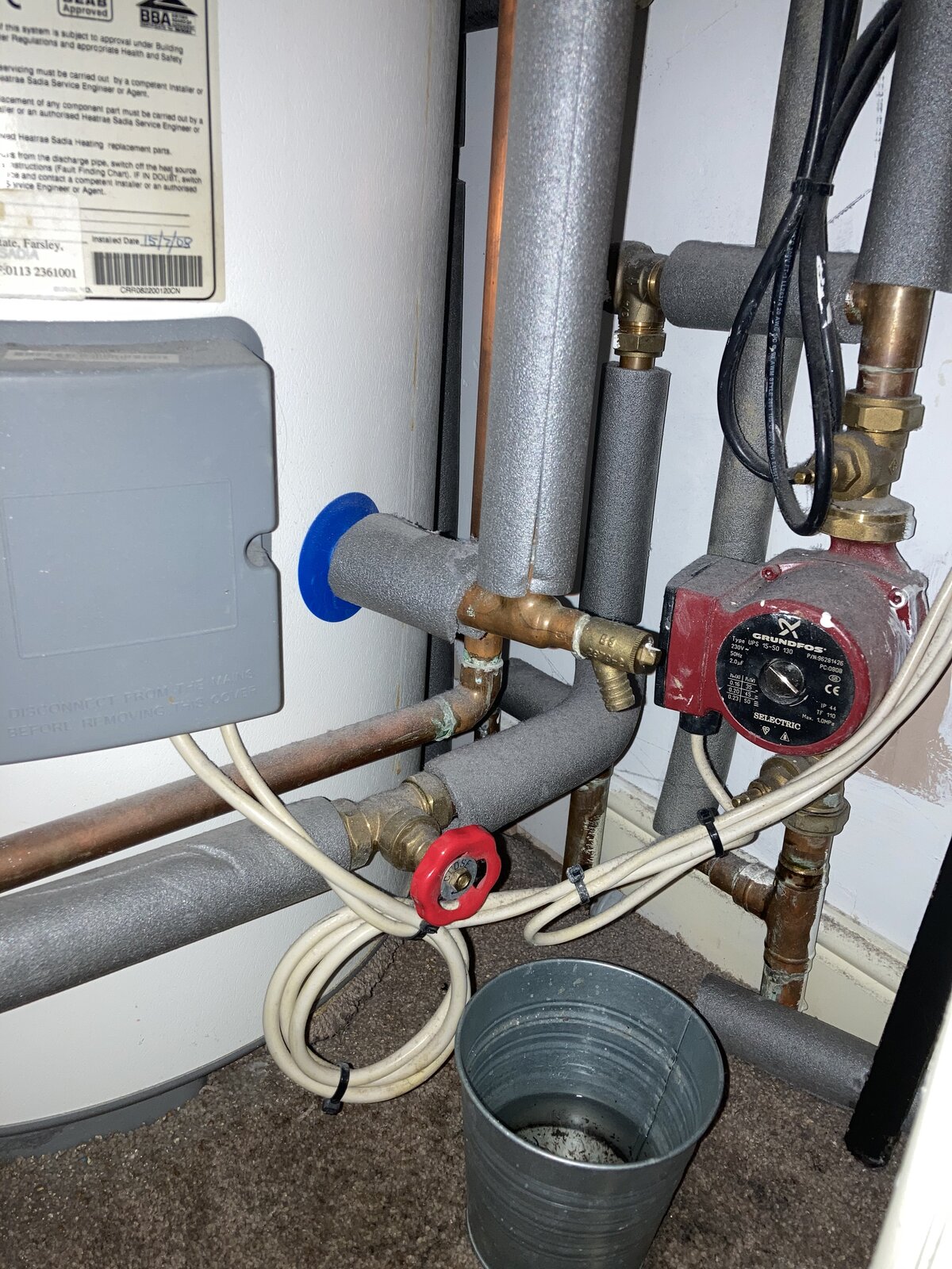

Hi All,
I’ve got a small drip coming from our baxi Megaflow Heatrae Sadia as you can see from the photo.
Is it possible for me to fix (very basic Skills!!) or should I get someone in + how much should it cost.
thanks in advance
Can see you've got a tub of water there but that's about it. Where's it coming from?

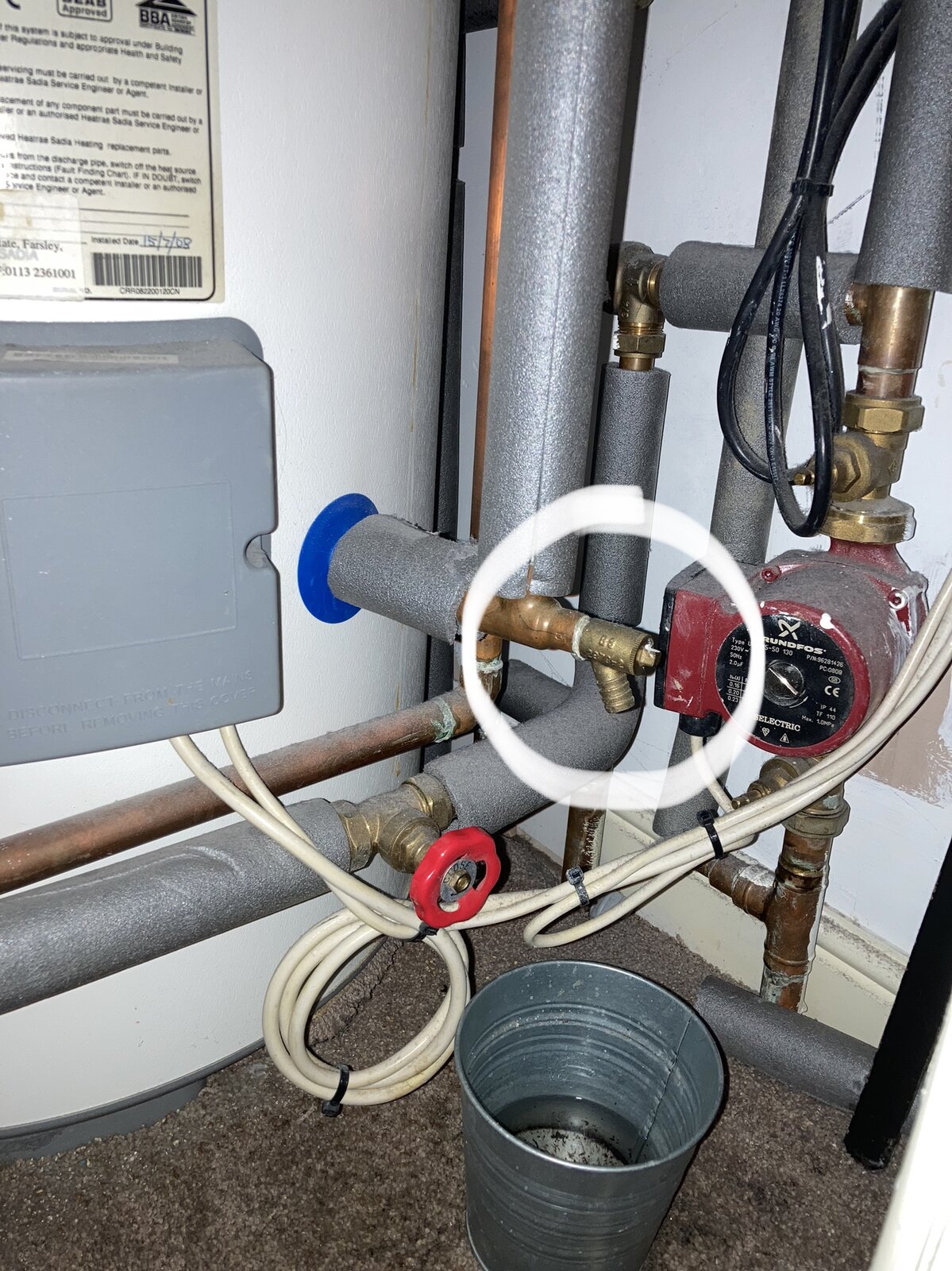

It’s a fairly slow drip but that might fill up in a day. I’ve circled the picture to show where the leak is coming from

Turn the square bit on the end clockwise about ⅛ of a turn. That should cure it
