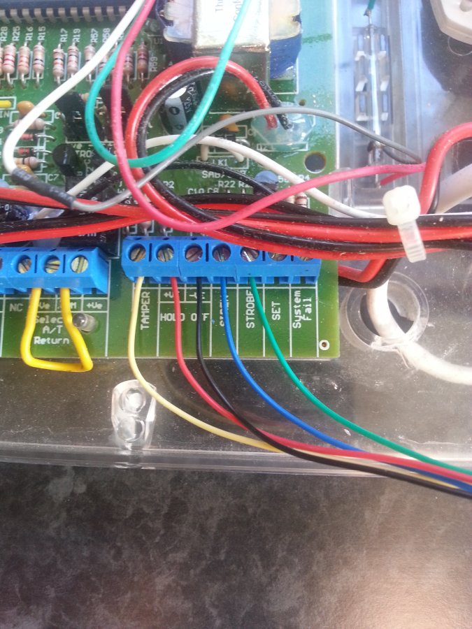

I have a Scantronic 9448 wired alarm system installed (i know quite old) Its been fine up unitil the last few days ..
The outside bell box has been making random chirps and the strobe has been flashing..Even when the alarm is not armed the bell box has been going off .The Tamper light on the main box has not been triggered either .All the leds are light up like normal ..
i have checked the fuses they are all fine (2 of Them) .the only way to stop the bell box from making any sound.i disconnected the wire from the main board aswell as the strobe wire..
The thing is the alarm still arms and works as it should ,but with no sound from the outside bell .i have checked the wires in the bell they all seem fine and well connected no condensation inside the box.

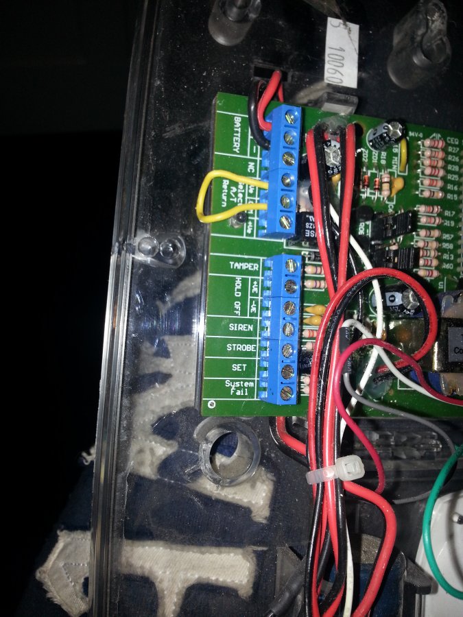

I have another bell box from another alarm thats in great working condition. Would it be worth trying the different bell box to see if the one in use is broken or could it be something else.

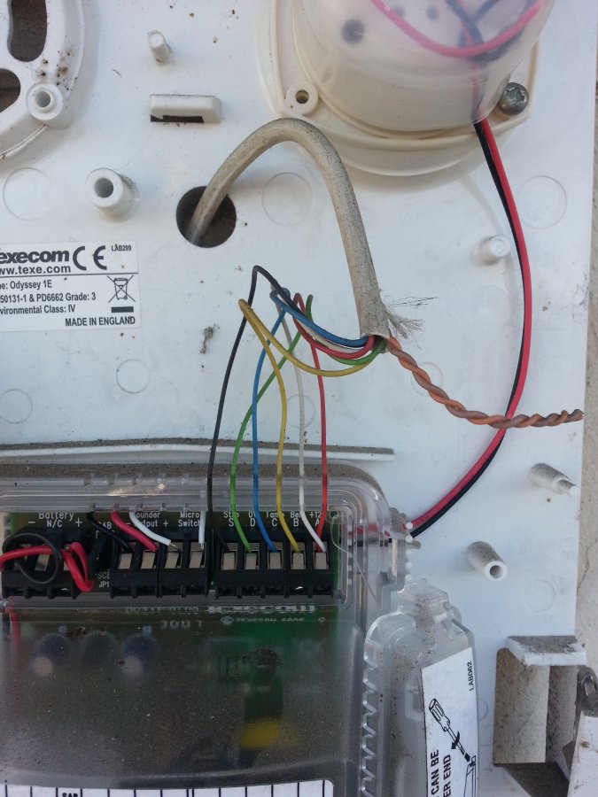

Trouble is im not sure about the wires as the other bell box is marked different i have attached 2 pics of the inside of both boxes .pic 1 is the one in use pic 2 is the newer box that might be worth a try to stop the above fault.
If anyone here can give some guidance to wire the newer box with the existing wires i would be grateful..

The odyssey bell could have a faulty piezo sounder
If the wires under the piezo cover are glued into the sounder then that bell box could be faulty
Texecom had a faulty batch or piezo sounders across all rangers of there bell boxes.
The other bell box is older than the Texecom.
A = positive 12volts on bell
B= bell trigger
C=Tamper return
D= o volts on bell
S= strobe trigger
Connection in 9448 for bell box
+12v = A
Ov bell = D
TR =C
Sw-bell trigger = B
ST strobe =S
Other bell box
Hold + =+12volts
Hold- = 0v
Siren = bell sw- trigger
Strobe = ST
Tamper = TR

Thank you very much for the reply.. My next question is..
Would it be worth trying the Odyssey Bell box to find out if my Texecom box is the cause of the problem.. I don't want to throw money at it and find out its not the cause i would rather put it towards a new system. (catch 22 I know) if the Odyssey box works I will buy a new bell box if you say these are unreliable.
So what I don't understand is the wiring as the Texecom has 2 wires going into 1 terminal. Would this be the same on the Odessey box?
Would it be possible to tell me what colour wire will go into what terminal on the Odessey box just to be sure.. Your help is greatly appreciated.

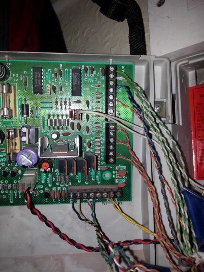

Post photo of bell wiring in control panel

So back to my first message on here .As i have another bell box im thinking of swapping them over to see if the fault lies with the bell box or not..
i have attached 2 pics again one showing the wiring of the panel and the other of the bell box im gonna try.
Please can you advise as what terminal the wires connect to in the bell please .
im guessing in the bell
strobe = black
siren = yellow
Tamp = blue
Not sure of the green and the red/white which go into the same terminal on the panel.

you could use your multimeter to take a reading in the control panel.
Bell positive+ and bell trigger - .if alarm unset then you should have no voltage between the 2 terminals,if you have voltage in unset mode then panel faulty ?
Excuse my ignorance. By bell trigger- and bell positive is that the white and red wire terminal and the yellow wire terminal in the panel.?
I am getting my head around this slowly. Don't get me wrong but I love this kinda thing it's also a learning curve
Yes that's correct
Set multimeter to dc voltage
Put red meter lead on red/white terminal and put black meter lead on yellow terminal if you have voltage 13v then panel faulty?
You could also check strobe output as well by putting black meter lead on black wire terminal.
When the alarm is unset you should not have any voltage on the trigger output.That would explain why strobe and bell are ringing in unset mode?
Hope this helps sort problem,finding faults can take some time and is a process of limitation.
