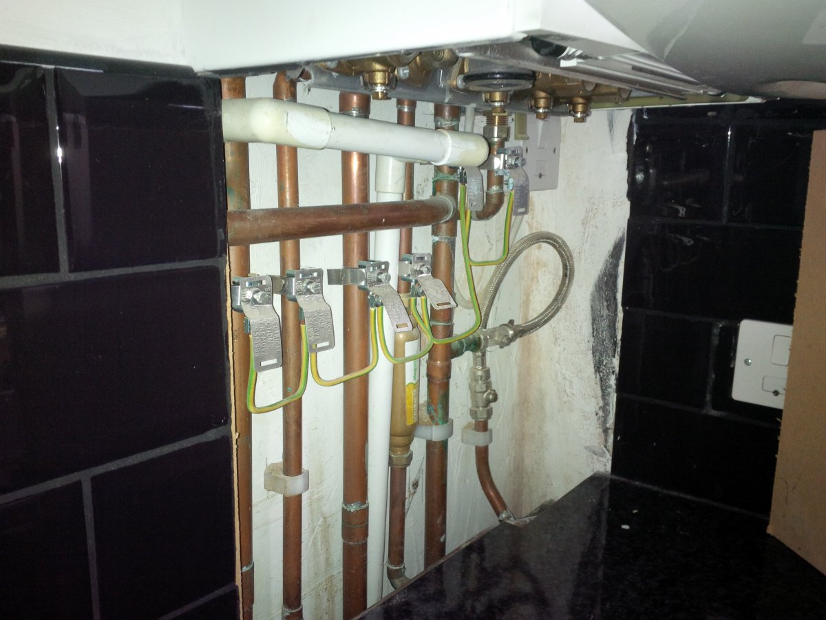

Hi guys
I have the above boiler - the booklet says Worcester Bosch 24i/28i Greenstar Junior Combi Boiler on it) and recently ordered a large key for it, only for it to plunge me into more confusion.

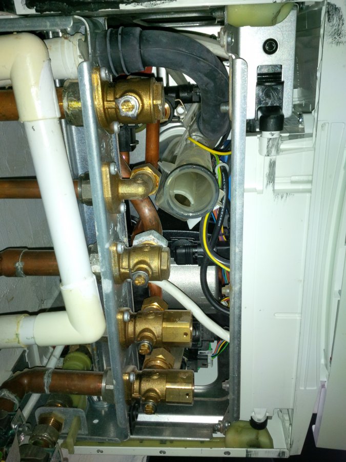

The large key wouldn't go further up that white-ish pipe (due to there being a curve on the inner side of the pipe), plus I couldn't see any water tap nearby either (all photos attached)
Any help or steps that you can advise me of will be much appreciated....it's really starting to stress me out.
Thanks in advance

The large key won't fit because you don't have a worcester filling link... Look round for a couple of valves linked with a braided flexible hose. Before you use the boiler refit the cap that you have removed and do it properly or get an RGI to do it for you as without that cap your home will fill with products of combustion..
You can see the braided hose in the 3rd pic, open one valve and then gradually open the other till the needle on the gauge reads around 1 bar... Then close BOTH valves

A lot of Worcester combis do use those keys, I think that they were an optional extra. Yours just hasn't got one.
The sump bottom of the condense trap is missing therefore open to atmosphere. I suggest you leave that boiler well alone til a GSR engineer has attended and replaced whats missing

That's the first time I've heard of anyone trying to use the filling key in the condensate trap!

You should really get that checked by an RGI before you use your boiler again - you've removed the bottom of the condensate trap and unless the cap is absolutely correctly refitted you'll end up with flue gases leaking into your room. The water that fell out when you removed it also needs replacing before the boiler is fired up again
