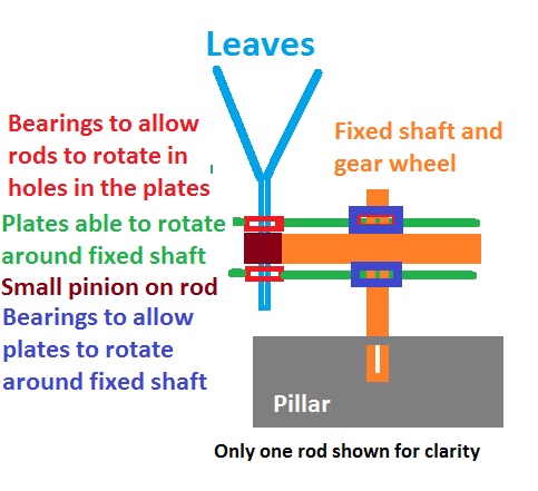

Morning all, I have been challenged to build something "arty", I'll do my best to describe it and what help I need (all measurements are approximates).

I think I can do the bottom bit, the metal disc which rotates in the top of the pillar with 3 rods protruding out of it.
So, my question is, how do I make a 2ft long 1cm metal rod which spins for the top half only?
Oh, and as it's arty it's got to look reasonably good....
Have the bottom part of the rod hollow (a tube), this would enable a thinner rod (which is connected to whatever makes it spin) to then connect to the top spinning part of the 1cm rod.
I have no idea nor can picture this thing - but it's arty so that's not so unusual for me :)
It appears to be a wind driven mechanism, with the three shafts fitted with pinion gears to drive them around a fixed central gear wheel as they rotate
Something similar to this but with ball bearings ( two per rod ) keep the three rods in place and able to rotate
and maybe constructed like this
Designing the leaves to be effective "sails" to rotate in the wind could be a difficult task. Google savonius rotor and then adapt the half can shapes to leafy shapes
The gears only keep the rods in synchronised motion ensuring that leaves on one side of the pillar are facing and therefore catch the wind and those on the other side are edge on to the wind.
The left side is a fixed tube, the right side is thinner when in the tube with a bit the same diameter as the tube, the bit inside may be a flexible shaft.
When I proposed the gears to synchronise the three sets of leaves I had assumed the leaves of one rod could clash with leaves on a different rod if there was no means to prevent them clashing.
Looking at the video is is clear that each rod in the example has it's own "airspace" for it's leaves and that these airspaces do not over lap each other.
