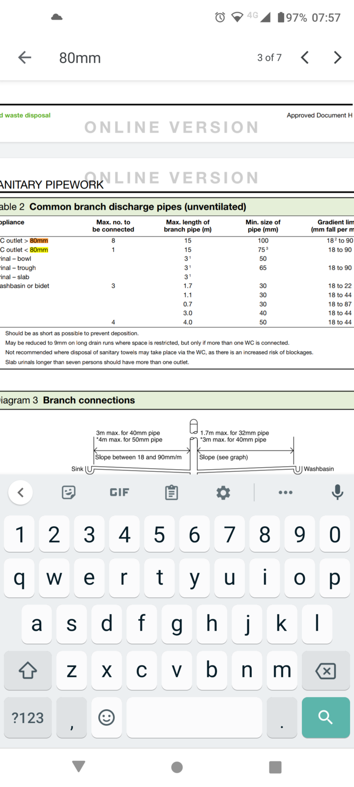

82mm soil is available, might help a bit, as will trimming the floorboards a bit for the first metre. Setting the pipe run straight is critical (a string line and plenty of timber supports).

I believe you can only have 1 WC on 75/82, so you're back to 110, but you can reduce fall to 9mm/m if more than 1 WC.

OK, so back to 110mm but, with a significantly shallower fall of 9mm, as its two bathrooms connected.
Strangely enough, that means I've got enough fall even on the 7m run
7" joist = 177mm
Soil Pipe = 110mm
Leaving 67mm for fall.
Min fall for 2 WCs on one soil is 9mm per meter
9mm x 7m run = 63mm
So I've 4mm spare, but that doesn't allow for collars, the fact it has to be dead straight etc!
