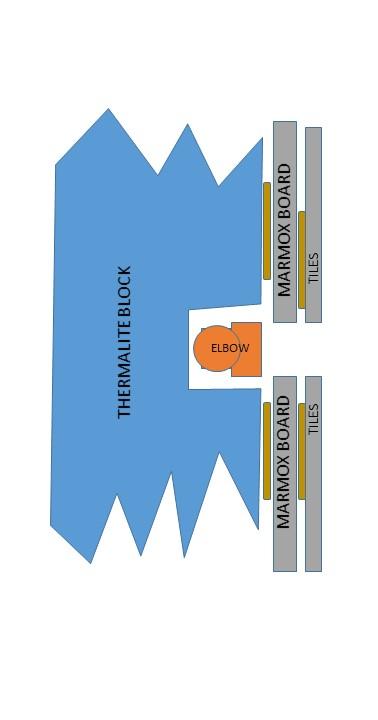

I've been refitting my bathroom - part of this is to install a shower with a concealed valve.
I've channeld the pipework into the thermalite block, and then overboared with Marmox. problem is, using the Grohe shower outlet elbow, and once the tiles are on (which I haven't done yet), the G1/2" connector on the back of the elbow will not reach the female side of the wall plate elbow concealed in the blockwork....how do I extend this to make it fit?

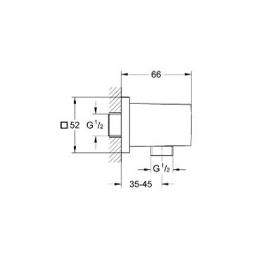

Using this elbow...
Which has the following dimensions....
And a diagram of the wall...

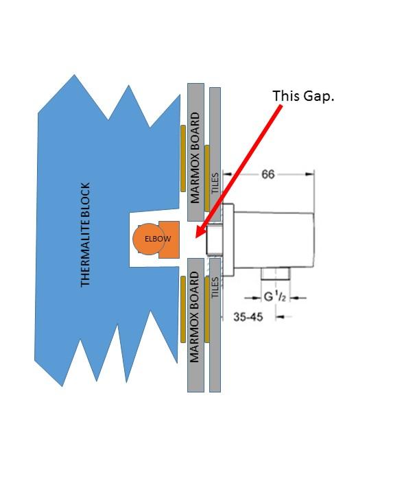

And then to fully describe the issue....

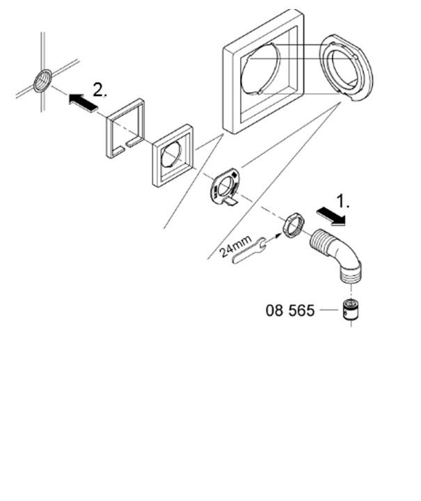

Below shows a blow up diagram of the Grohe elbow...
So as you can see, it's a Grohe design, not just a nipple.
The Grohe fitting instructions seem to suggest that the female part of the wall plate elbow (currently concealed in the blockwork) should be flush with the surface of the tiles, but I cannot see how I can acheive this - and I don't really want to be taking the Marmox off the wall again.
Any advice greatly appreciated.
