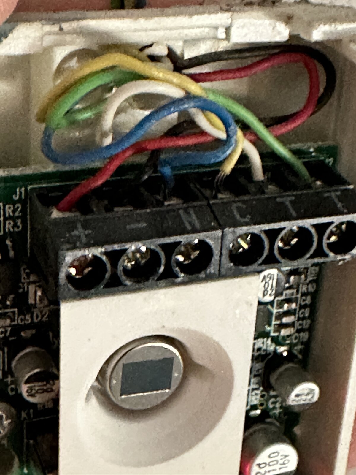

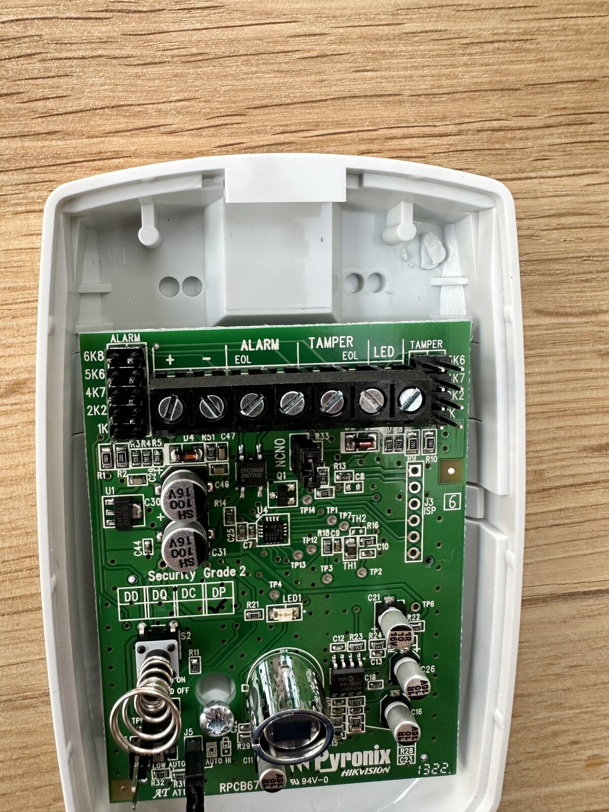

Hi All,
I am trying to change old dated pir after decorating, typically the new pair purchased is worded slightly differently.
Can anyone please advise :unsure:
Pictures are attached, for reference the new pair is pyronix KX10DP
Thanks in advance..

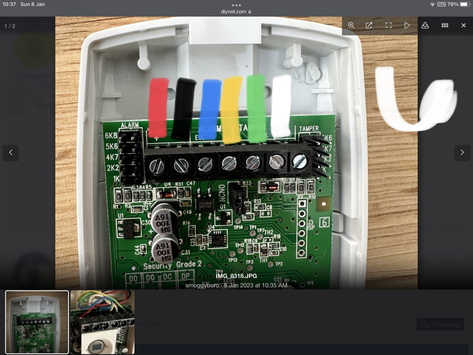

Last terminal on the right ( new pir ) not required , also no jumpers required
