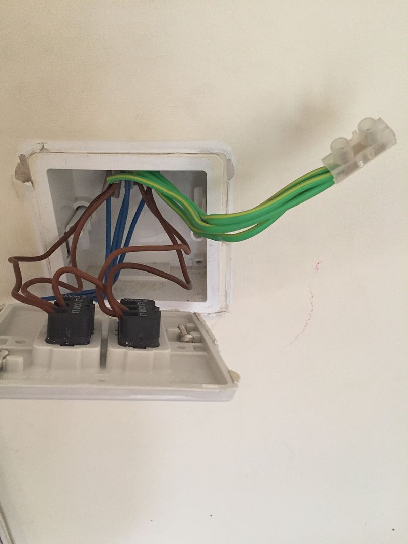

Hi all, I hope someone can help.
Im my living room there is a total of 3 lights. 2 controllled by one switch. and the other by the remaining switch.
I want to fit a dimmer and they don't resemble each other at the back.
Prior to disconnection of the original it looked like this:
And the back of the new one looks like this:
Thanks in advance!
You probably want to put both of the wires that are currently in "COM" into "L" on the new dimmer (discarding the link wire) and then L1 to ~1 for the other two wires.
The faceplate also requires the earth wire to be connected to it, as well as a link to the backbox.
As above, com cables to to L on dimmer, discard link wire.
L1 of each gang to ≠1 of each gang.
Metallic dimmer requires connecting to earth and earth proved as continuous.
They want directly connecting to the the metallic switch plate earth terminals.
They look in good condition, but unfortunately just a visual of them does not confirm continuity, as you have a metallic switch it is very important that earths will work in case of a short to the plate. This needs electrically testing, if you have a multi-meter you could do a r1+r2 test.
Also note the minimum and maximum loads on each gang of the dimmer, do your loads comply with these.

I take one out of the block to earth?
No they all need to be together to help keep continuity throughout.
So you have two options all three conductors in to earth terminal on switch plate or a length of earth between the connector block and the switch plate leaving all the other three in the connector as well.

If you cannot check the continuity of the earth/CPC, I would recommend one for safety reasons, it is important that earth continuity is in place, especially when metallic accessories are being installed.
I look at the sine wave with arrow through it and hesitate at giving instructions. I looked for Holder dimming switches without finding any diagram but with these switches.
The sine wave with arrow through it is a data connection to the other switch of a pair.
I would say follow the instructions that came with the switch. Today there are far too many cleaver switches to jump in with standard wiring diagrams. Switches have for years used their own standards some using com others using L1 for the same terminal. The fact it has 5 terminals plus earth does seem odd normally two switches will have there own supply even when on the same plate if it needs a link then that is external to the switch.
To have a line and wire it seems that the switch is being used as a junction box and it supplies the next switch as well as the lights using USA stile of wiring. In the USA the switches have larger terminals to take the extra wires you may have a problem with switches in the UK taking that many cables.
As said likely L is common and sine wave with arrow through it 1 is supply to lights but that is a guess. Guessing is not good enough you need to read the info that came with the switch. You may have picked up a slave rather than master and it may not be suitable.
