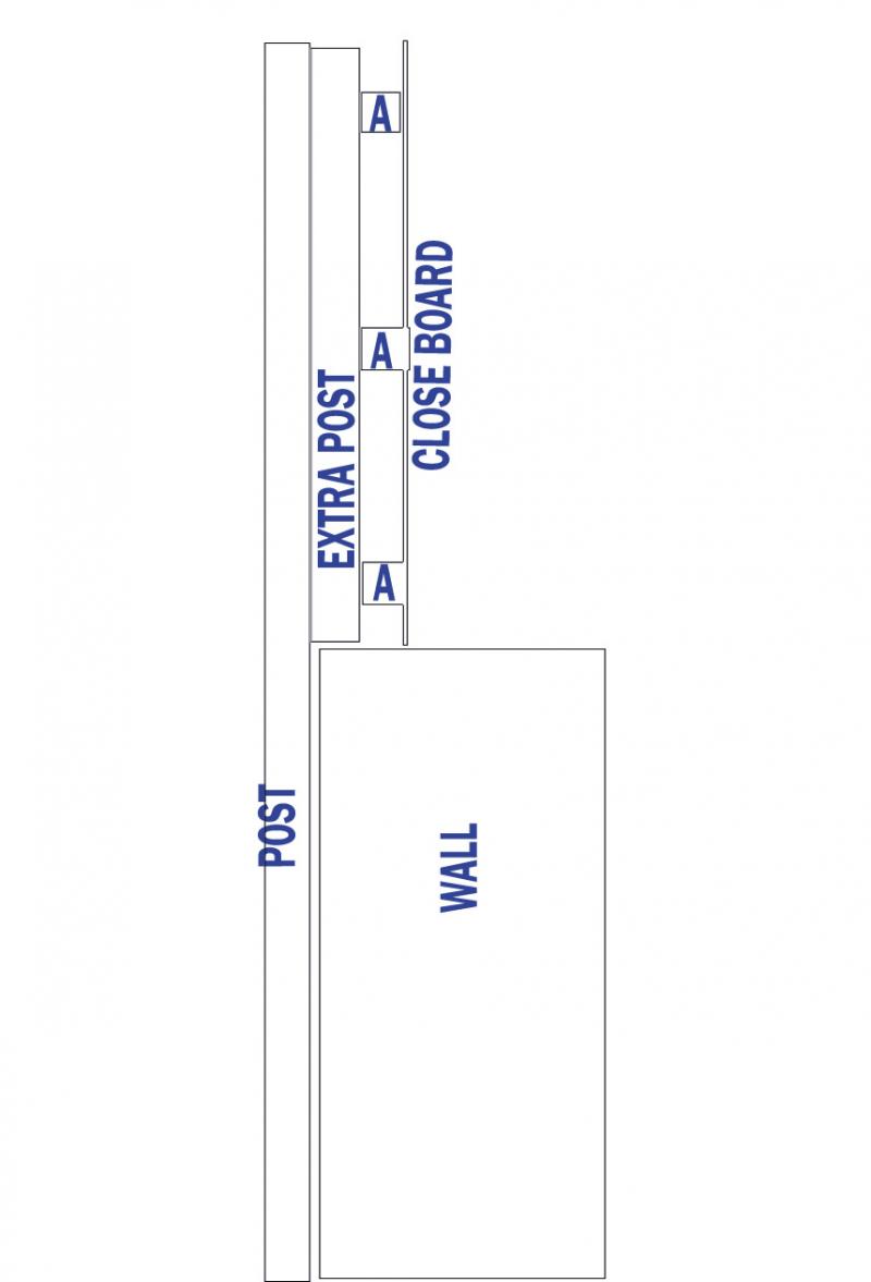

Use pillars that go up alongside it, you can put extra short bits of post screwed to the main posts to extend the post over the wall so you can put on arris rails that will put the close boarding directly in the middle (or edge) of the wall as you'd wish. (if you get my gist).
Edit: Just noticed you saying it will be 6" high.
For that, given that it will be on top of a wall that I am assuming is higher than 6", you will need planning permission as you cannot go above 6'6" without it.
How about this naff picture that just took me 5 mins to draw, then 10 mins to get my 13yr old son to come downstairs & show me how to do it so I can save it with the lines showing :D

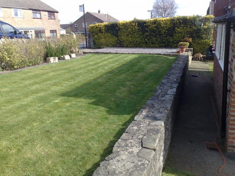

Many thanks for all your help. With a bit of luck this is the wall i'm on about. If i put post up one side it's going to look horrible with the posts showing and i won't get posts long enough? If i go down the other side i'm gonna have to dig up my lawn? It sounds like the boltdowns are a none starter so it looks like i'm gonna have to go lawn side!! Just to clear up the fence will be 6' going down to 5' and visable from both sides.

i would definetly go down the lawn side. with a bit of care youd never know youd been there if its done well.
Hi,
I've taken your advice and decided to go down the lawn side. The holes are nice and neat and haven't damaged the lawn one bit!!
