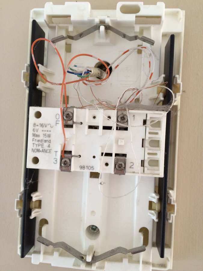

Here's a picture of the insides....
Seems that the chime box does have a larger wire feeding into it and then only a couple of smaller wires attach to the chime itself.
Is that what it looks like to you?
There is no transformer in that chime box. The white cable(s) are telephone type cables, often used for door bell wiring. One will be going to the transformer wherever it has been hidden and the other to the door bell.

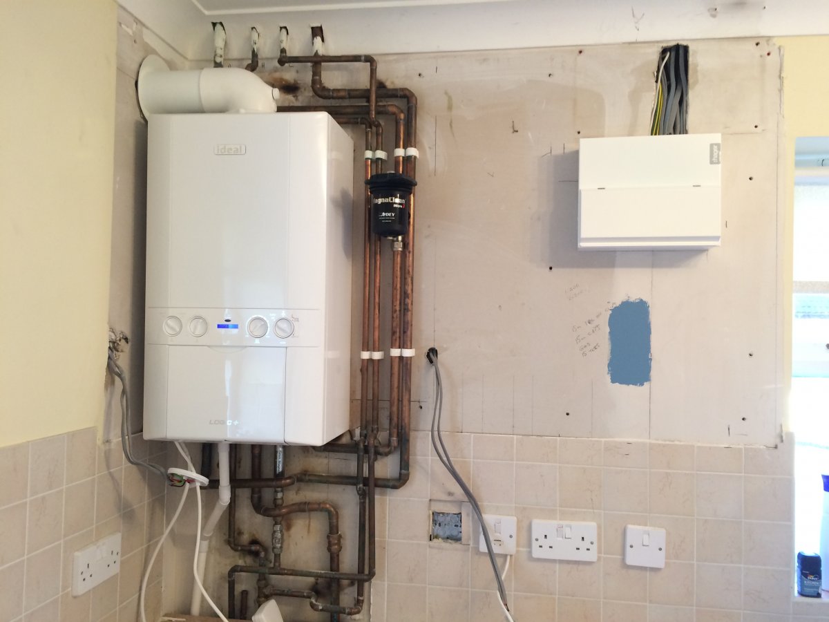

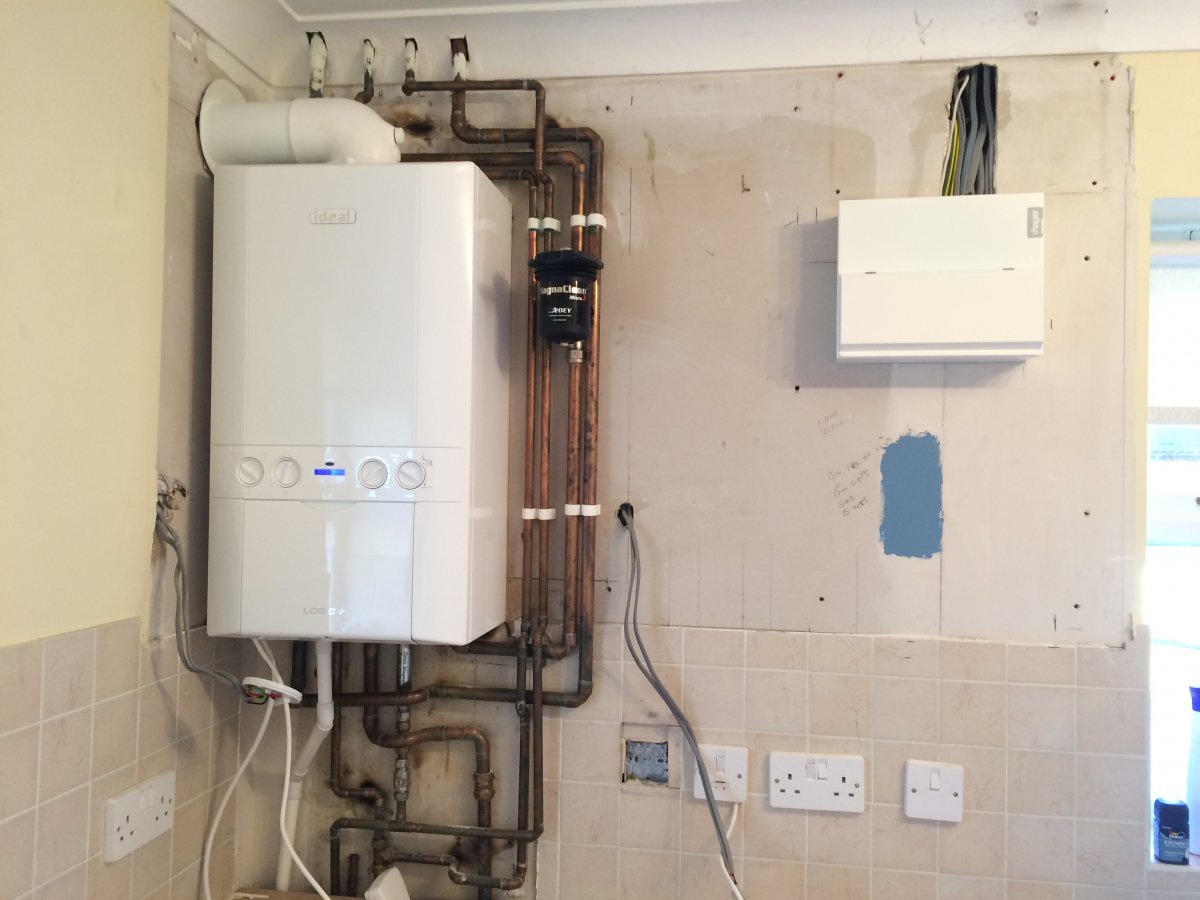

I'll try that thanks. I've managed to find a picture from just after the new consumer unit was installed just before the kitchen was fitted (attached).
There's a white cable going up from the consumer unit.
Is this likely to be the door bell wire? If so does this help find the transformer?
If transformer still can't be found could the mains cabling be capped off by accessing the consumer unit? That way we could just install a wireless door bell and forget about the hard wiring.
