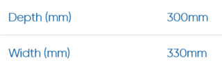

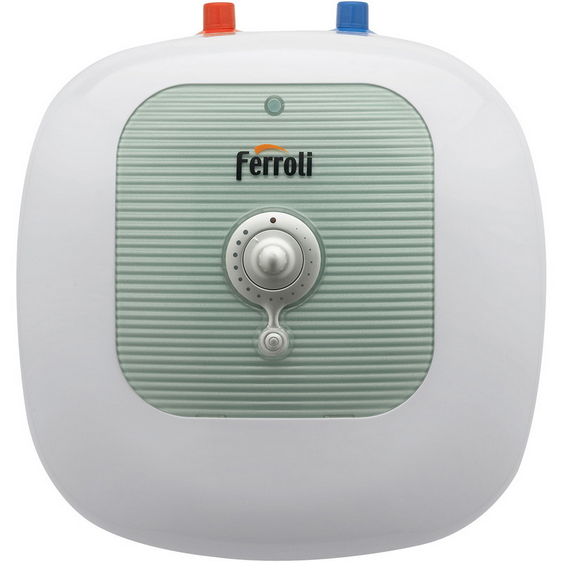

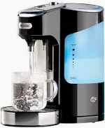

The new ones seem to vary in size 5 to 15 litres. A quick google came up with this 2 kW version 1725779861428.pngI also have a problem, my pipe work is too long, and to get hot water I have to run a lot off, but heating water is in summer at least free, the solar panels do it, in winter the oil central heating does it, I have three outlets used, and clearly these things only serve one outlet, but the size puts me off, 1725780348291.png it all depends if over or under sink, and we have a window behind sink so can't be over the sink. Gas water boilers are still made, but the price is silly, what I tend to do, is boil a cup of water to take chill off, these 1725780648981.png are fast, it takes 60 seconds to boil a cup of water, and 60 seconds to run off the cold water, so makes no never mind which one does. And is fitting a local boiler worth it to save 60 seconds?
Thank you for such a comprehensive reply! Ericmark. I think though I will probably have to get one fitted, as I'm sure during the colder months the normal tap water will just be untouchable with how cold it is! We're currently just using a kettle but not sure if it's worth getting a 10l one which just keeps the water hot all day (as its a waste) or an instant one which seems a bit more economical as we're not going to use that water overnight etc
