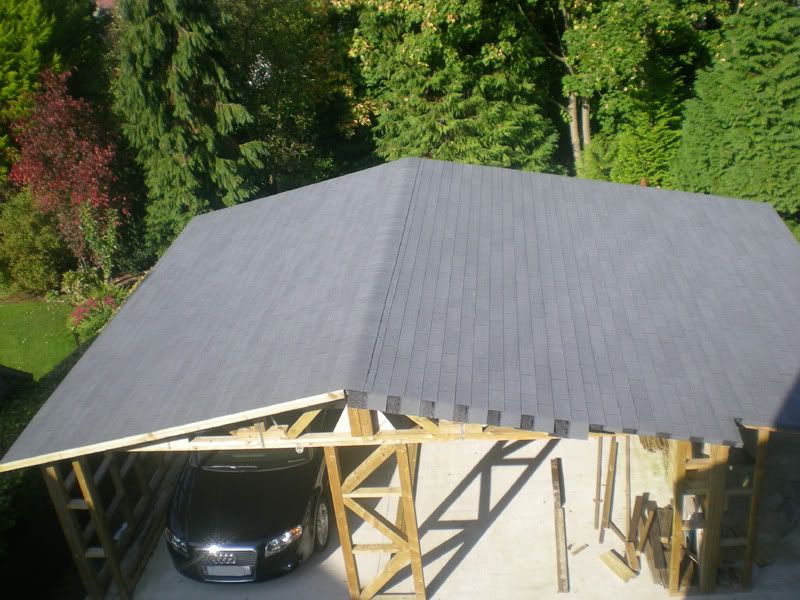

I shingled my new garage roof in October last year. The place I ordered the shingles from advised that an underlay wasn't 'essential' with a pitch of 24° and unfortunately I penny pinched my way to accepting this advice. :oops: :cry:
I followed the cover guidelines to the letter and laid them very carefully, including sticking down the corners of each tab, but the roof is leaking profusely. :cry: :cry: :cry:
I'm not 100% sure how the roof is leaking or how the shingles seal - I'm 'guessing' that some capillary action is drawing water up from the top of the slits between the shingle tabs. :confused:
I appreciate that the shingles haven't been subjected to a proper hot day yet and I'm hoping/praying that this might sort it, but it doesn't seem likely to me that the bitumen adhesion strips (lower down the shingle) will prevent water ingress at the top of the tab slit on the shingle above??? :?:
I'm bricking it, because I don't relish pulling 60 M2 (£700) off the roof for the skip and relaying it with a felt underlay. :evil:
Any words of comfort along the lines of "Proper hot/sunny day in June will sort it." :?: :p :cool: Or should I just go get 5hit-faced tonight and rip it all off this weekend? :rolleyes:
Thanks in advance for any help.

Five minutes measuring + two mintues calculating = two hours thinking of an excuse. :oops: It's a while since it was calculated and the ridge height was lowered from the original intention, which was considered as a part way excuse, but I think I've realised why..
It's cos I'm thick as pig 5hit. :rolleyes: I've suspected this for a while, but I'm now convinced. :(
So, going forward, WTF can I do? :?: Obviously I can't change the pitch (it's 14°/24%), is there no option other than re-shingling with an underlay?
Will a hot & sunny day help at all?

It's very visible from above Matthew, the rear garden is a floor lower than the front of the house and the pic is taken from the dining room. :cry:

I've measured it properly at 13.8° and the shingles are supposed to work from 15°......
Never mind waiting for the sun to be hot enough ;) get up there with a hot air gun - spend a morning and a
£ot of electricity ( or if you`ve got economy 7 do it @ night) and thoroughly warm up / roll with a wallpaper seam roller - as many shingles as you can . Then the next day test your "repaired" area with a hose :idea:
I would be inclined to warm the shingles up and see hat happens.
they dont need much heat to bond... am surprised at 14 degrees..

Your cheapest option might be to get your local "sympathetic" roofer to "torch on" some 4mm green mineral for you, it won’t look as nice but it will be dry and will work at that pitch.

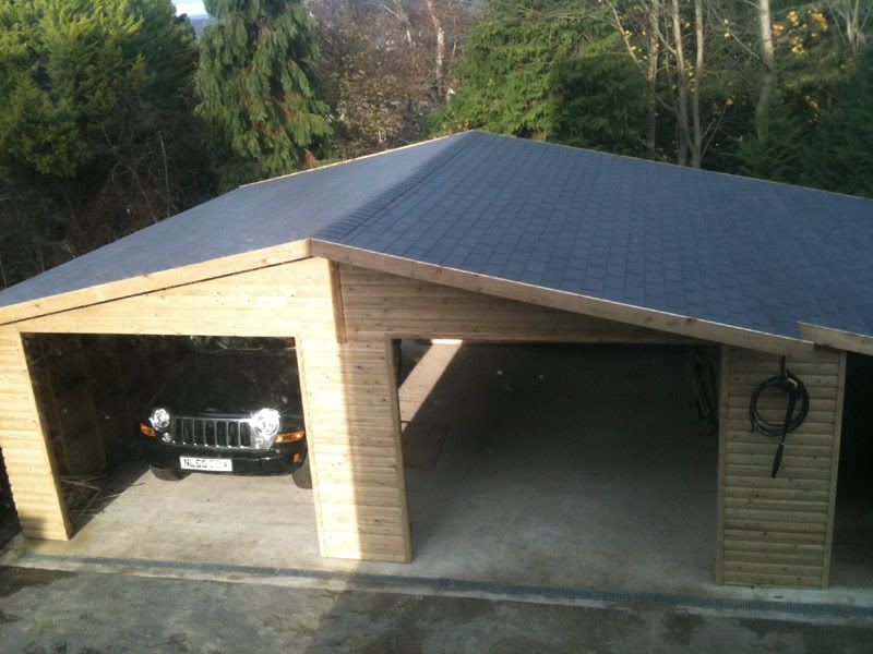

Thanks for all the suggestions - I took the lazy option and decided to give nature a chance, which seems to have been very successful. :eek: :cool:
I ratcheted the timber deck together while screwing it down and I can't believe how much it's shrunk; the shingles have buckled slightly due to the deck shrinking, but the roof is almost watertight now.
If it survives the prolonged damp assault of winter without leaking much, I'm hopeful that it might seal up 100% if we get a proper session of heat/sunshine next year.:arrow: Even if it doesn't seal up 100%, it's been acceptably dry enough so far this year.
