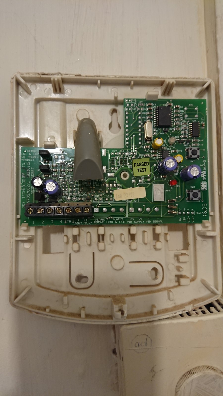

Good afternoon,
I have recently moved in to a property which has a communal Intercom system installed but the handset in my flat was ripped off by previous tenant (for some unknown reason :mad:). I have bought a new handset which seems to be a upgrade of the last one (possibly discontinued) & "copied" the wiring from old one as no instructions were sent & now just get "Tel Disconnected" on the display of the external unit.
Privacy button sounds & illuminates when pushed.
Entry doesn't open the door but can hear a fast "engaged"/disconnected line tone through the handset speaker.
Housing Association won't help as I'm in a Private Let property in their complex. Landlord unsure of where to start so here I am seeking any & all advice.
Old Unit - GDX5
New Unit - GDX 23150
Pictures below of old unit wired in to ports 1-4 & same with new unit.
Thanks in advance (y)

Looks like it may be the wrong handset.
Your new GDX-23150 handset is intended for GDX GDX1/GDX3 2 system.
You probably need a 23121 handset for a GDX5 system.
https://doorentrydirect.com/gdx
https://doorentrydirect.com/gdx-23121-2-button-handset
I'm not sure, but the system might also need your flat to be 'turned on' at the control unit.

Much appreciated, I did see your post earlier but been busy with work & new baby but did automatically order the one you recommended.
All is now working as it should be just by copying the input from old unit, thank you very muchly :)
