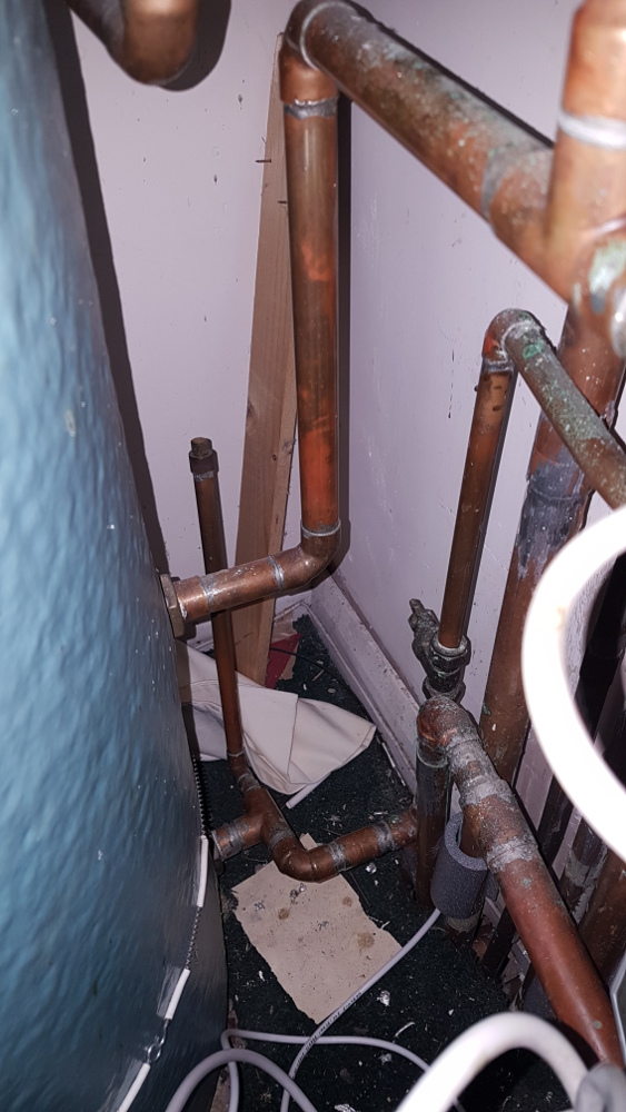

Alright, got a picture, would welcome a second opinion on if I'm giong crazy or not. I took a photo of the backside of the pump and there is an arrow pointing down, so I have assumed that is the direction of water flow.
I mentioned earlier about a bypass between the inflow and outflow on the HWC coil. Actually this bypasses the radiator circuit, but due to where they branch off before the motorized valve, and go to the HWC outflow, both the HWC coil both the HWC coil and the bypass effectively act as bypasses to the radiator circuit...
Also there is a boiler optimizer device in the shot (energy minder auto), which is supposed to have temp sensors on the inflow and outlfow of the HWC coil, that appear to be on completely the wrong pipes. Not sure if the kids have been playing around with those.
With that dangerous wiring you need to get it sorted ASAP with kids! :eek: No cover on the enclosure, cable without strain relief not clipped, so if they pull it they could have exposed live wires flapping around!
Regarding the pipework it seems it is as we said before(y)
