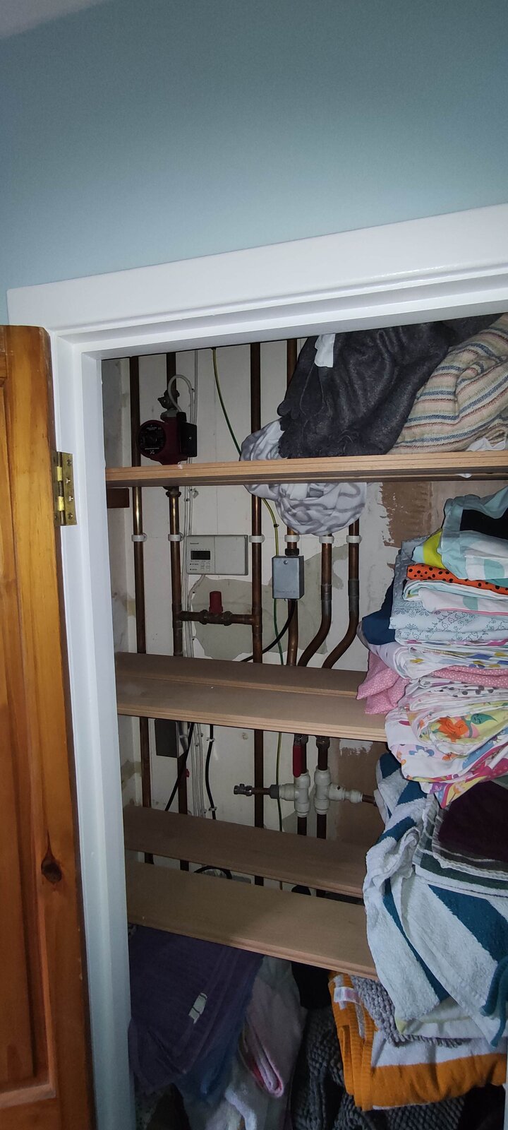

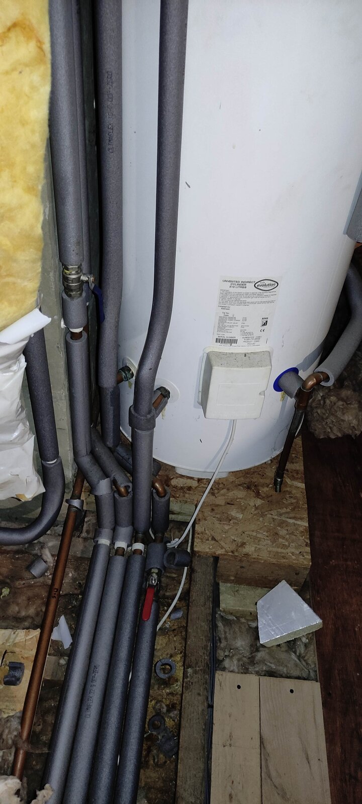

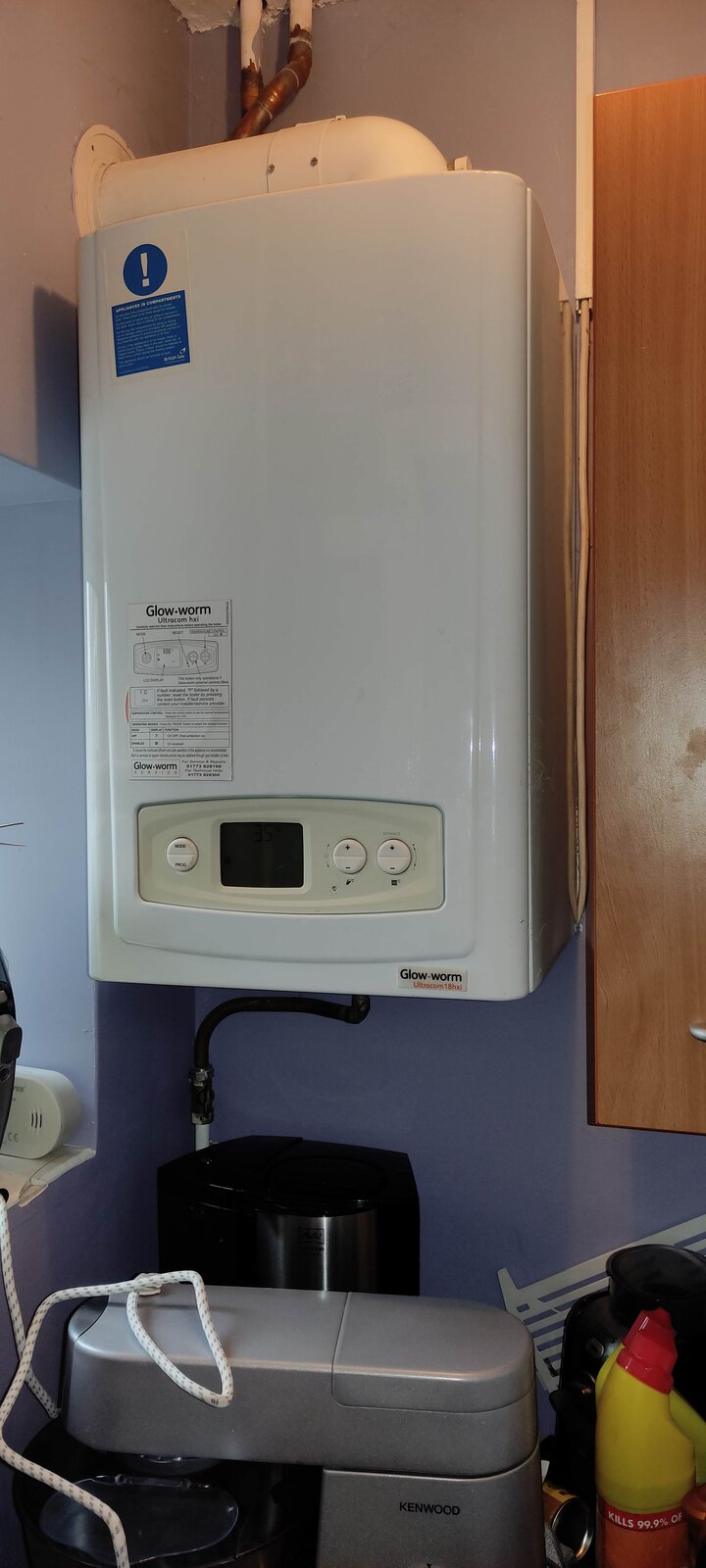

you have an airlock, your system will have motorised valves (Zone valves) these should have been latched open to maual during draining and re-filling, that is what that lever is there for
post some pics of your valves and boiler and pump and HW cyl so we can see exactly what setup you have

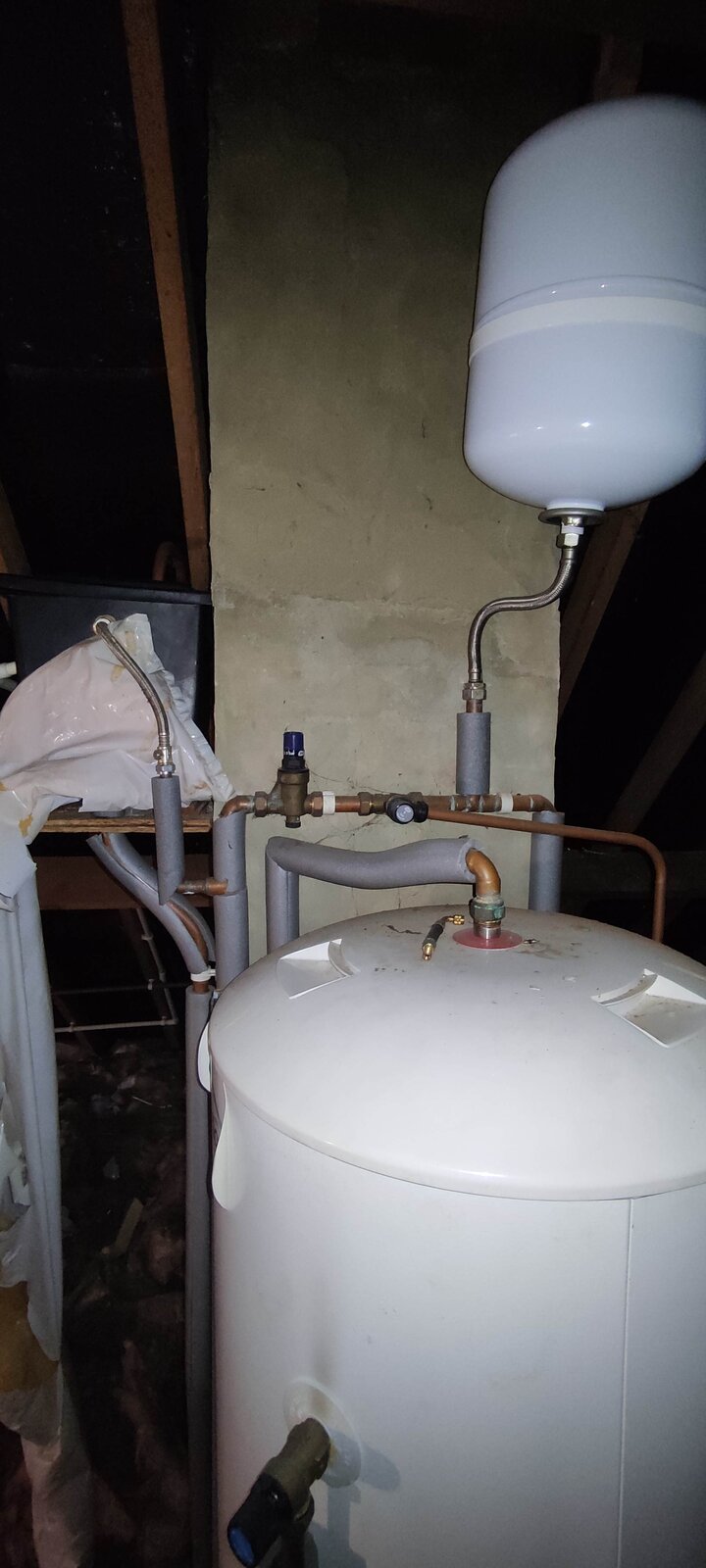

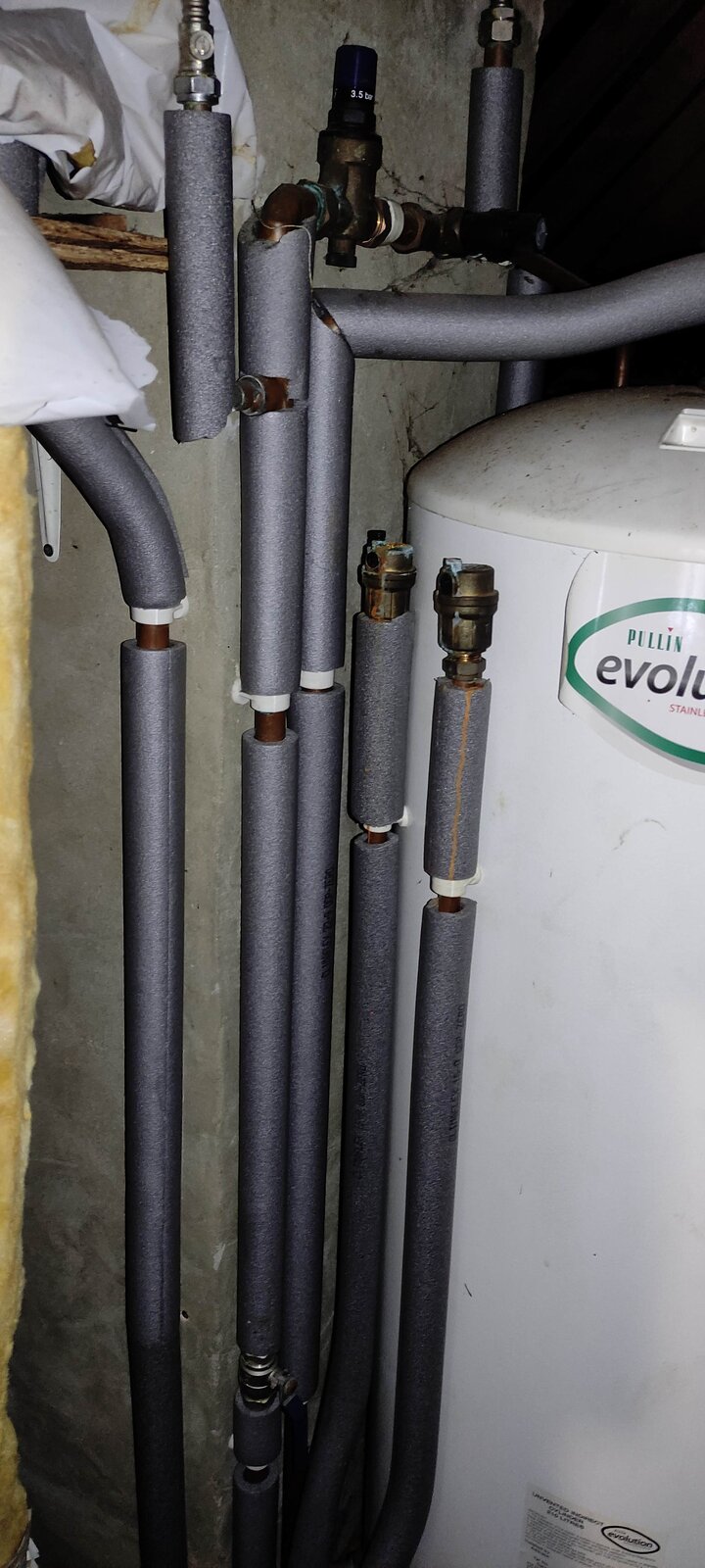

Here you are. My plumber (who by his own admission is not a heating engineer and did not realise that we had motorised valves that needed opening - this all started last year when he first drained the system...) went up into the loft just now and bled the left hand pipe on the third photo - loads of air came out.
Suspect more air in system still though, so any advice would be greatly appreciated.

Letting the air out hasn't made the heating any happier - it fired up at 5 flames, got to 70° quickly then shut off. It then came back on at 3 flames, ran there for a couple of minutes getting to around 64° then dropped down to one flame where it is now sitting. It occasionally tries to run at 3 flames but then drops back down to one flame and the temp on the boiler display drops quite significantly.
The boiler is giving fairly consistent s53 codes, so there's a blockage somewhere restricting flow.
