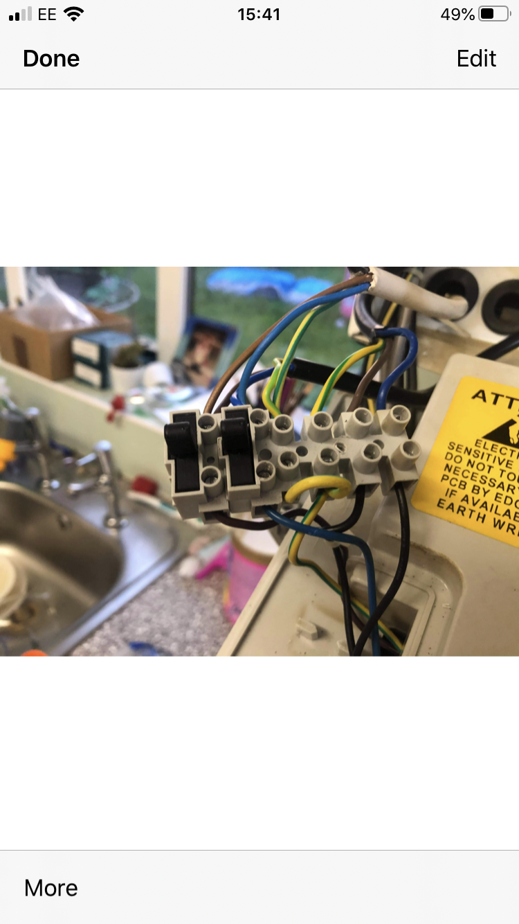

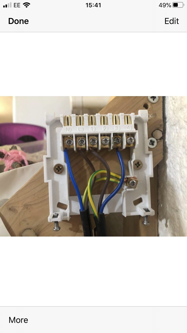

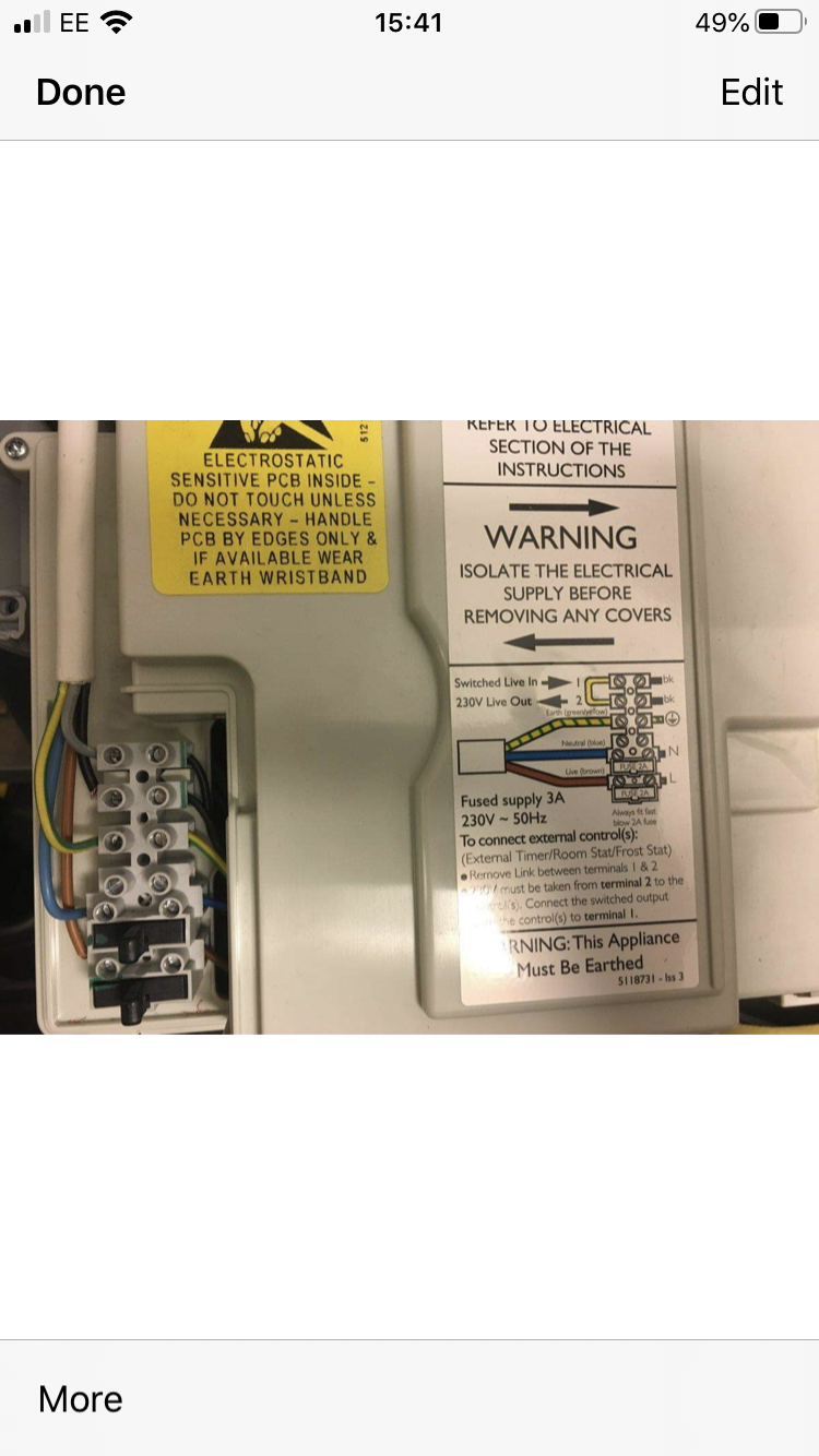

Hi I am trying wire hive with baxi boiler I have wired live/neutral and earth Then BK1 to hive number 1 and bk2 to hive 3 it all finds thermostat but when turn heating on nothing the light comes on the hive receiver but doesn’t fire boiler up ???
Although just a switch, try BK2 to common on Hive (number 1) and BK1 to Normally open on Hive (number 3).
And you have it on heating on the selector switch? Timer set to on? Boiler stat up?
Hi tried all this and still no joy could I wire straight where thermostat is as that has 4wires
Post photo of existing wiring configuration at the boiler and what is is you propose.

Any chance you got the black flex cable mixed up? As in the brown or blues mixed up?
