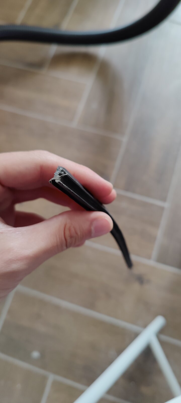

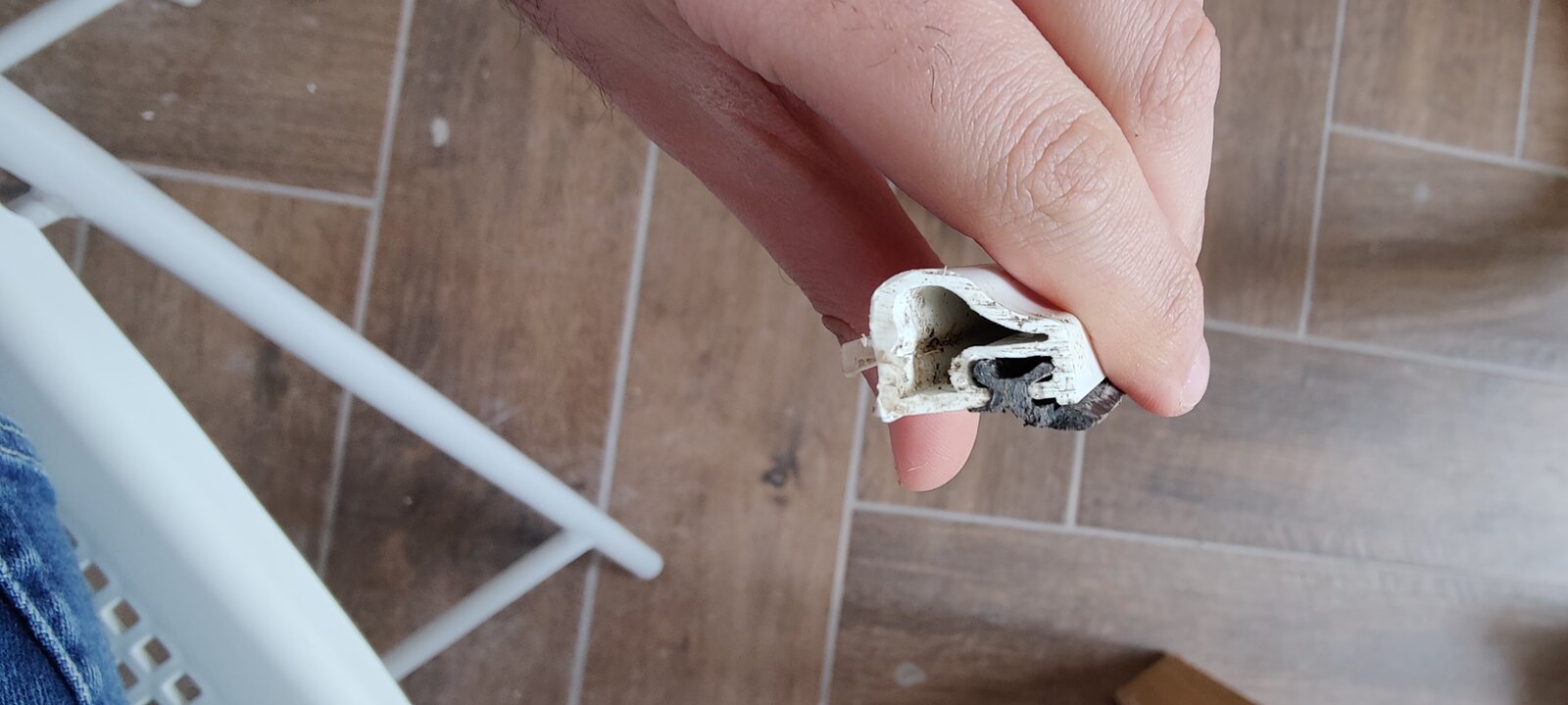

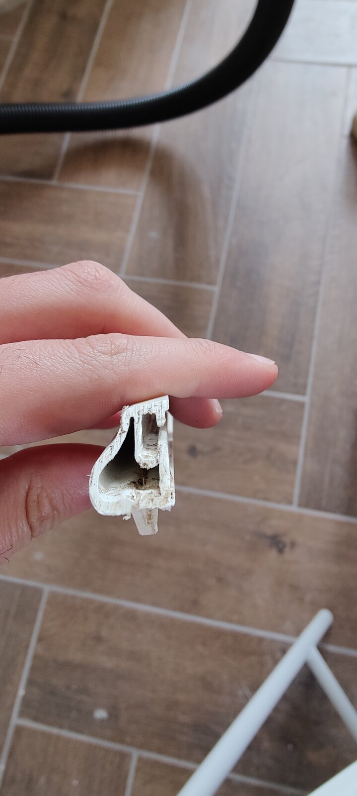

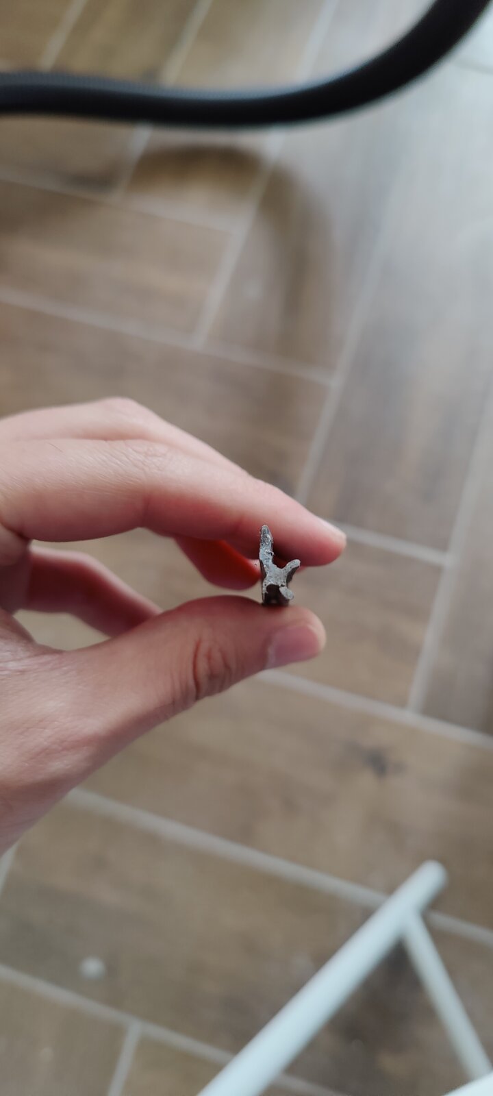

Hello all:)
I just moved into an older property and a lot of the seals/gaskets on the bead of my windows are deteriorating.
Can anyone help me identify the type of gasket or where I can source it from?
Cheers!
I have put fresh gaskets in some of my UPVC d/glazing no problem - got them from ebay where some of the traders offer dozens of different profiles, just go there and type UPVC gaskets in the search box.
If they are internal bead seals just replace the outer ones which will be easier to match and the ones that do most of the sealing
the closest i can find is this:
However it is not the same :/
I hear you my friend but will it do the job you want which is of course to exclude draughts of cold air I presume? If it will then use it eh? I have in the past found all kinds of plastic items which are "not the same" but still did the job so NP.
After looking inside the frame I found that they are from KBE.
Central extrusions had what I needed:)
