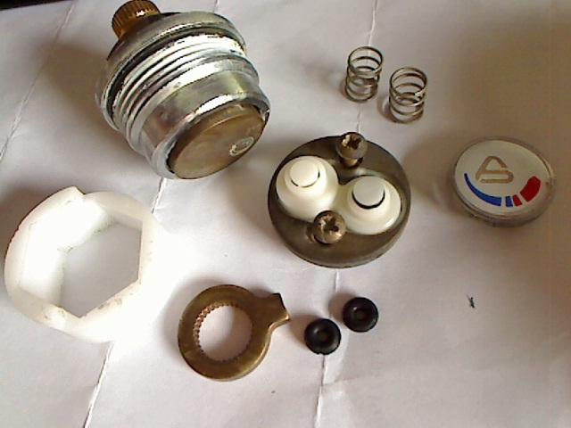

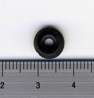

Hi - we have a disabled toilet with a small lever operated mixer tap which is leaking continually.
The tap has some very small rubber o-rings internally which need replacing, however they seem to be a non-standard size and I'm having difficulty getting hold of them. The o-ring cross-section is 3mm, with a central hole of about 2.5mm making the whole thing only 8.5mm across the diameter.
If anyone can tell me where I can get o-rings of that size I'd be grateful!
Alternatively can anyone identify the manufacturer so that I can contact them - this is the logo but I'm not sure what it is (it looks like "AS" so I thought Armitage Shanks, but I can't find any trace of them using a logo like that online).

Measure the exact size, OD, ID, and thickness and go to one of the many sites that supply O rings. Just Google O rings.
I have - the size appears to be non-standard as it does not fit the size of any of the BS/ISO o-ring sizes I've been able to find.
It's the internal diameter that's the problem... nothing comes close to an internal diameter of 2.5mm, with a cross section of 3mm (or nothing that I've found). Anything with that cross section, seems to start with an internal diamter ("hole") of about 3.5mm - which is clearly way too big.

What does the o ring actually do, i realise its a seal but is it on a moving part? If the rubber or whatever its made of is hard then if you have the skill try cutting down a tap washer. There are washers with no holes in the center so it can be drilled to size and i've ground them down against a disc cutter with a spindle through the center hole so fingers are away from the disc.
It actually provides the seal on a little plunger... this photo shows the innards of the tap, and you can see two little plastic plungers which are pressed down as the tap is turned on, the o-ring goes around the bottom of the plunger so when the tap is off, the spring forces the plunger up, and it creates the seal.
So it would have to be very precise to make the seal appropriately!

The tap is an Armitage Shanks Spraymixa S7445AA and the seal kit is available on part code E960186NU £10.54 excl
