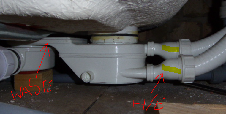

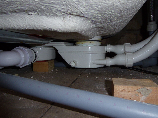

Please can someone help me identify the make and model of bath trap that has been fitted in the property I've just moved into. I've attached a few photo's. It is a low profile thing that has 2 flexible tubes running up the top of the bath and also a cable running up to a knob on top of bath by taps. The bath / shower is draining slowly. Many Thanks
Ok. I will be the first to admit that I have never seen anything like that (I can sense everyone googling it:D).
I'm not surprised that the bath is draining slowly with that trap. I want to suggest changing it for a standard trap and extending the waste pipe but I can't work out where the overflow is. Is it on the top of the bath? Perhaps I am just looking at it completely wrong.
Hi squeaky, thanks for the reply, I was guessing it has people stumped :( Unfortunately there are no identifying marks on what I can see.
From what I can see there is no overflow. I think this trap / device is some sort of zero water thing with a diaphragm.
Sottini trap, part of Ideal Standard. Absolute PITA to assemble and work in a strange way. Overflow is built into the plughole and pipes carry water up and out to waste and drain outlet is activated by magnet if I remember right through same plughole.
The two white pipes that rise up to where the taps are is the overflow. Its effectively an upside down u-pipe.

It looks very similar to the type of waste that are fitted to Villeroy and Boch baths.

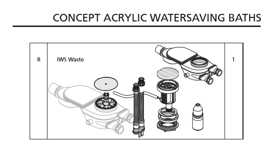

An Ideal Standard waste it is :) Seems it's part of their water saving low level bath range. I've found the attached image on a 'concept' install instruction guide.
Is there a new direct replacement spare part for this, that operates using the same concept without the need for an overflow outlet. I guess I'm stuck with that option?
If it helps anyone else I finally got round to removing this trap to take a look see what was the problem. As cozzmic said the plug is controlled by a strong magnet which repels the plug when it is positioned directly under the plug by means of a lever controlled in turn by the cable and dial. The main issue was / is that it becomes very stiff to turn the control dial at the point where the magnet positions under the plug. It was because of this that I did not want to force the control dial to the point where it pops up the plug. Now I know how it works I know that this is what I have to do because it is still stiff even after taking it apart and cleaning it all out. Thanks again - at least I didn't have to buy a new one which I was not looking forward to at £127 a pop! I was staggered too that it did not leak when I put it back :)
