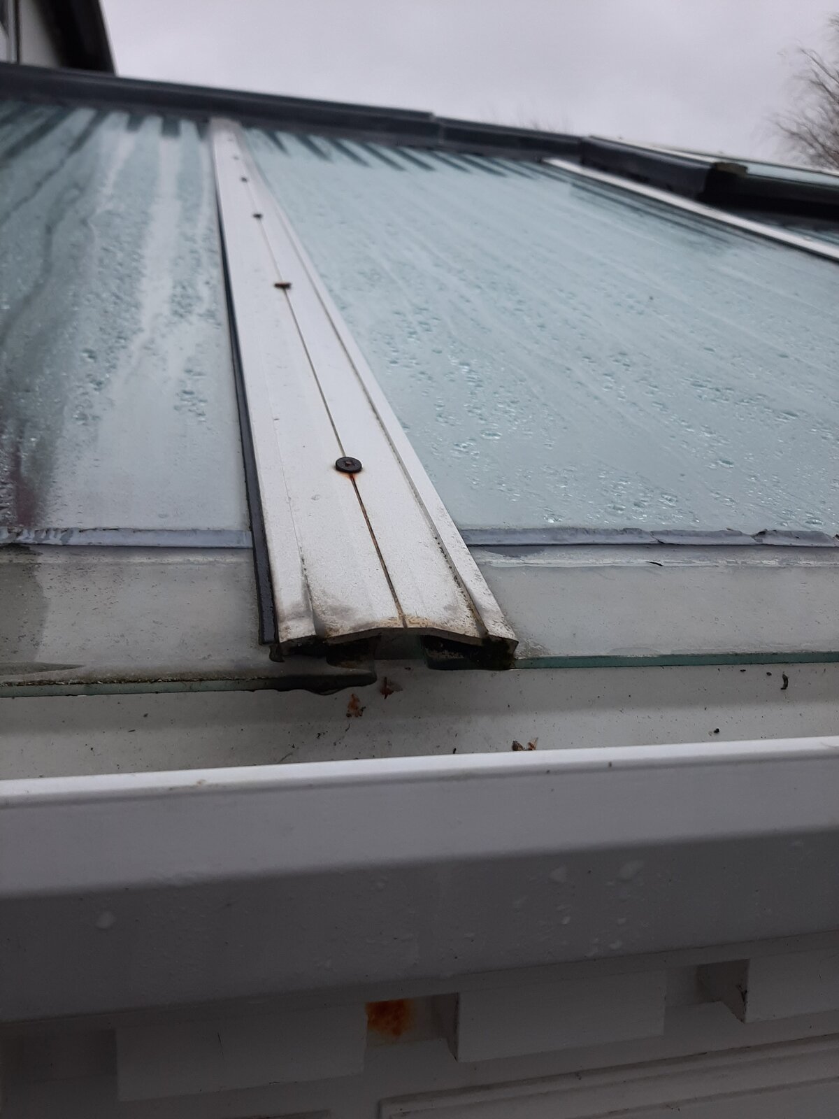

Hi,
would anyone recognise these roof bars from our conservatory please. I think it's about 15 years old. looking to replace them like for like if possible as we freshen the whole thing up.
thanks
Chris
Those are screw down timber supported glazing bars instead of snap down. You can’t get those anymore. The nearest alternative would be a sunwood 50mm screw down timber supported glazing bar. The difference would be they come with a bead to cover the screws that hammers in place.
I don’t have a tape measure mind, so make sure you check.

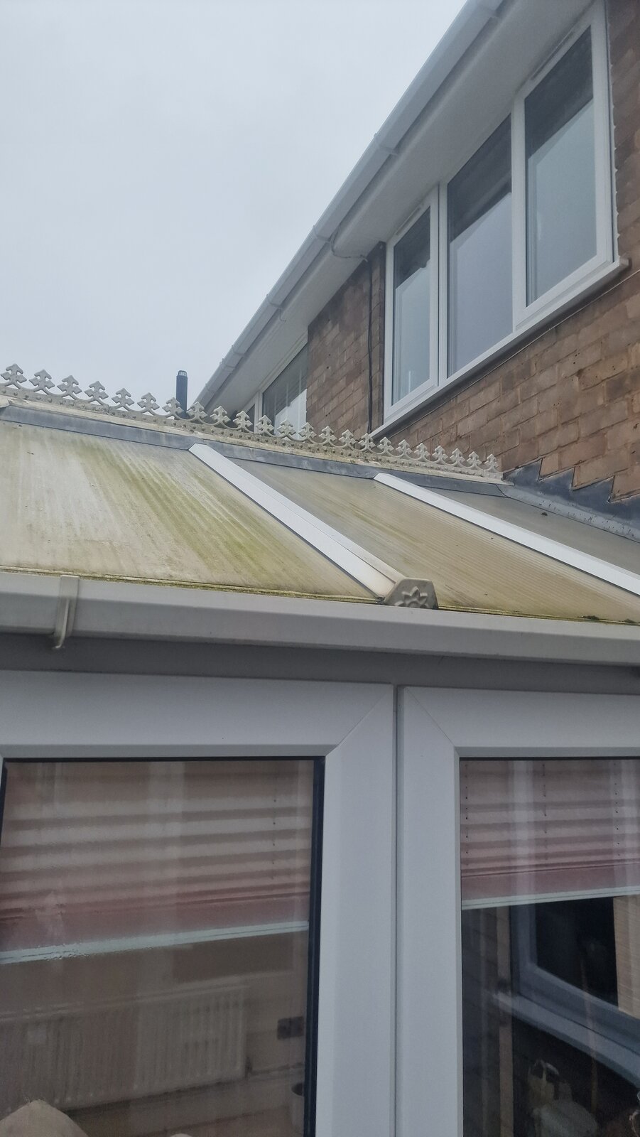

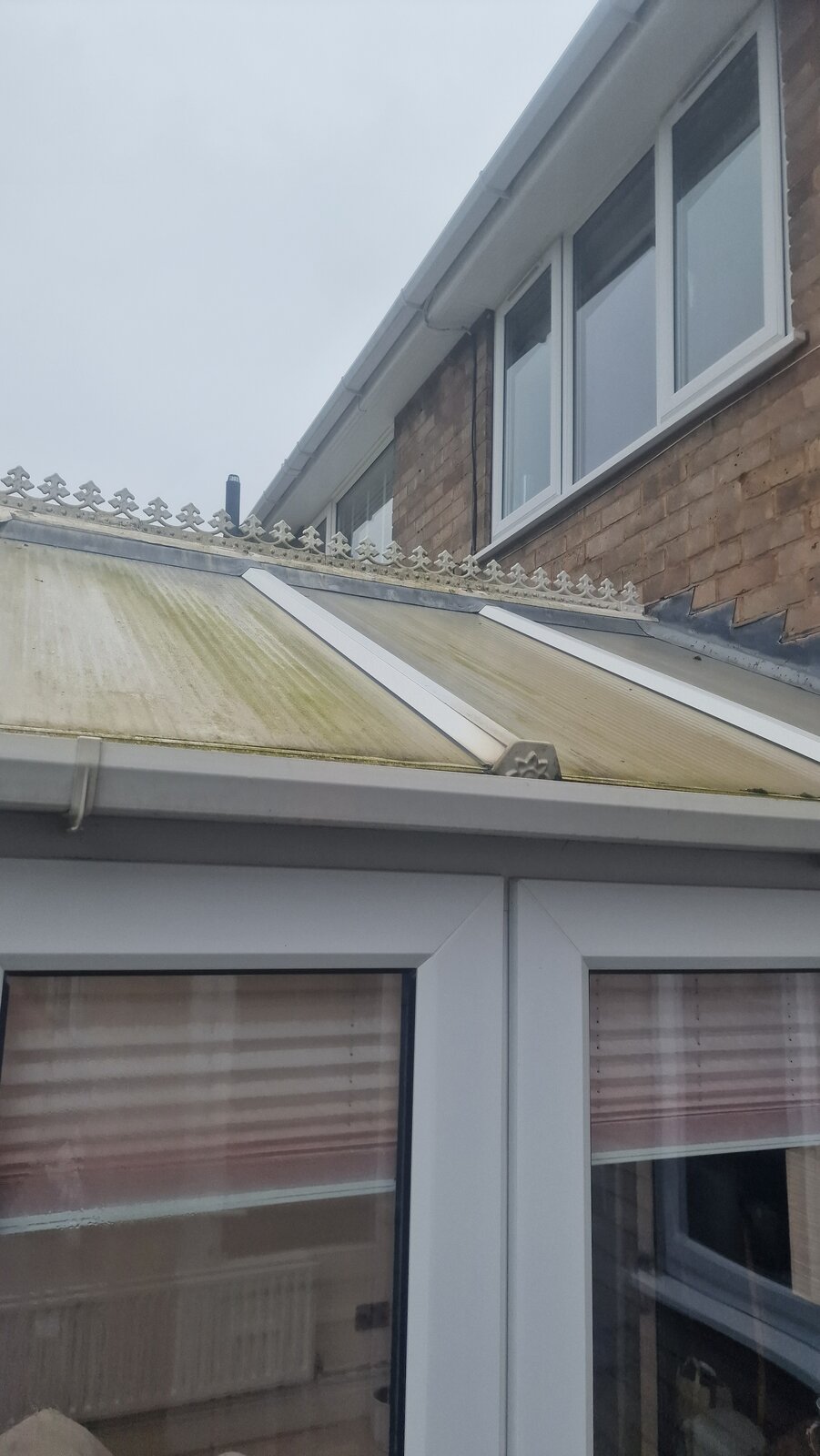

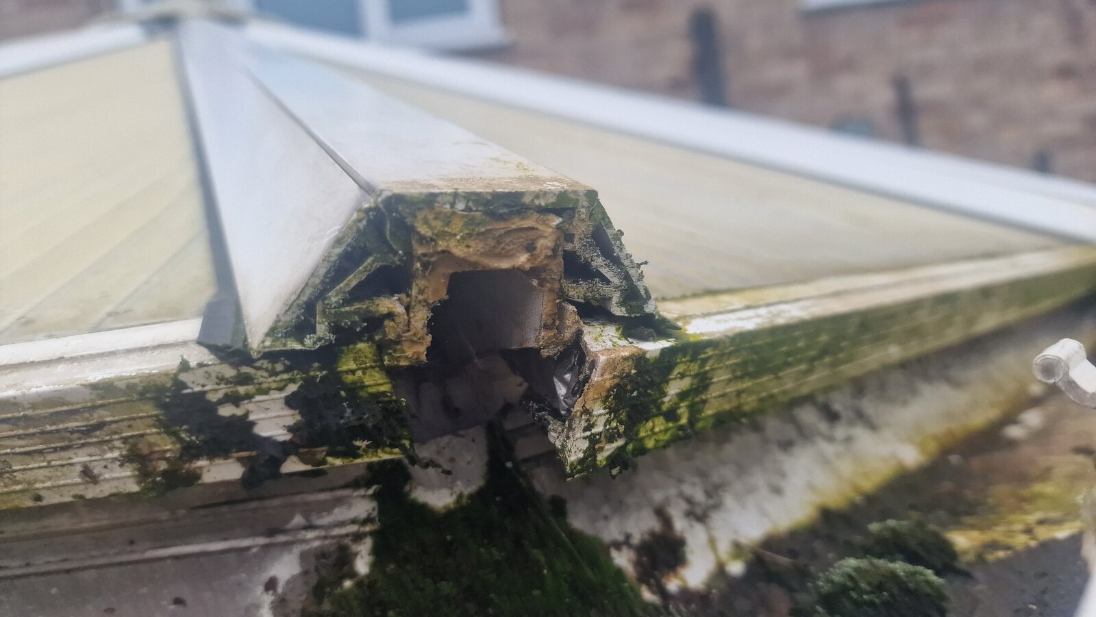

I have a similar problem identifying these roof bars! Can anyone help? Thank you

You need to take one off and see if it’s a snap down type or not
You might not get the type but probably will get one to fit
You might need to replace the bit it snaps into which requires deglazing
