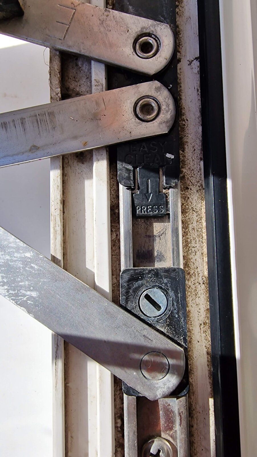

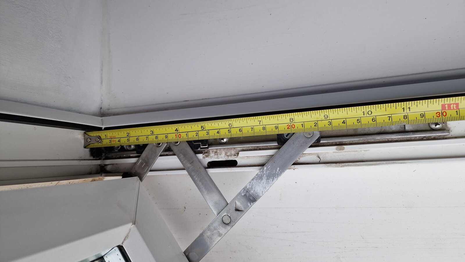

Help identifying uPVC window hinges - easy clean 12" / 311mm 13mm - would like fixing holes in the same place :)
9 Mar 2008
64
7
Yeovil
Hi, I've some broken window hinges that need replacing. To simplify the process I'd ideally like to change like for like, so fixing holes are in the same place (measured from the edge on the frame side they are at 36mm, 134mm and 305mm). Windows will be approx 11 years old new at construction. Would someone please be able to identify from photo/s. Thank you. P.S. the glazing units are 40cm x 80cm 4mm glass so by rough calculation the window should weigh around 7kg? does that sound right? so manageable without removing the sealed unit?
might be these looking at the pics BUT I've never come across a company providing the sctrew hole spaces before ... maybe worth emailling htis particularly seller. Just looks to me like the ' slide button ' is the same style
Hi, Thanks for your reply Ronnie, but your link went to door handles. Regardless I think I've cracked it - they look like Yale EDSE12 to me :)
