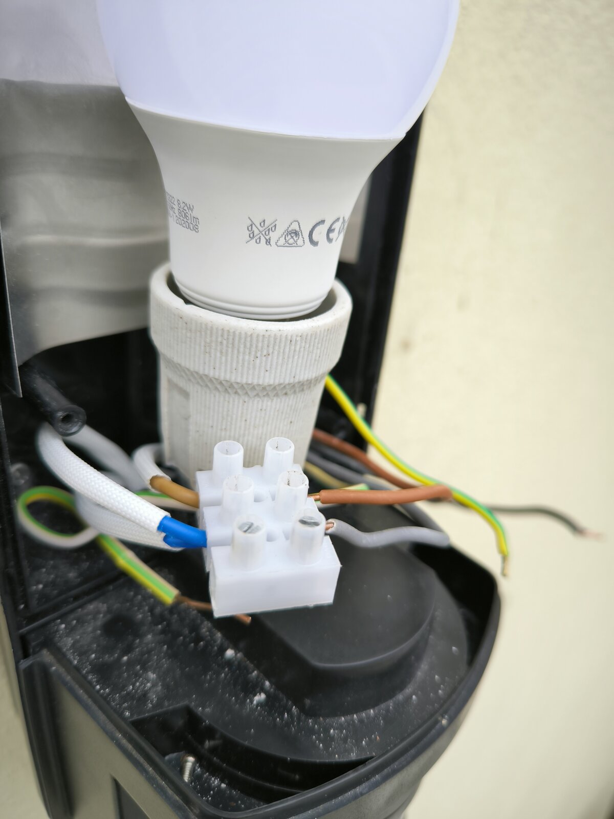

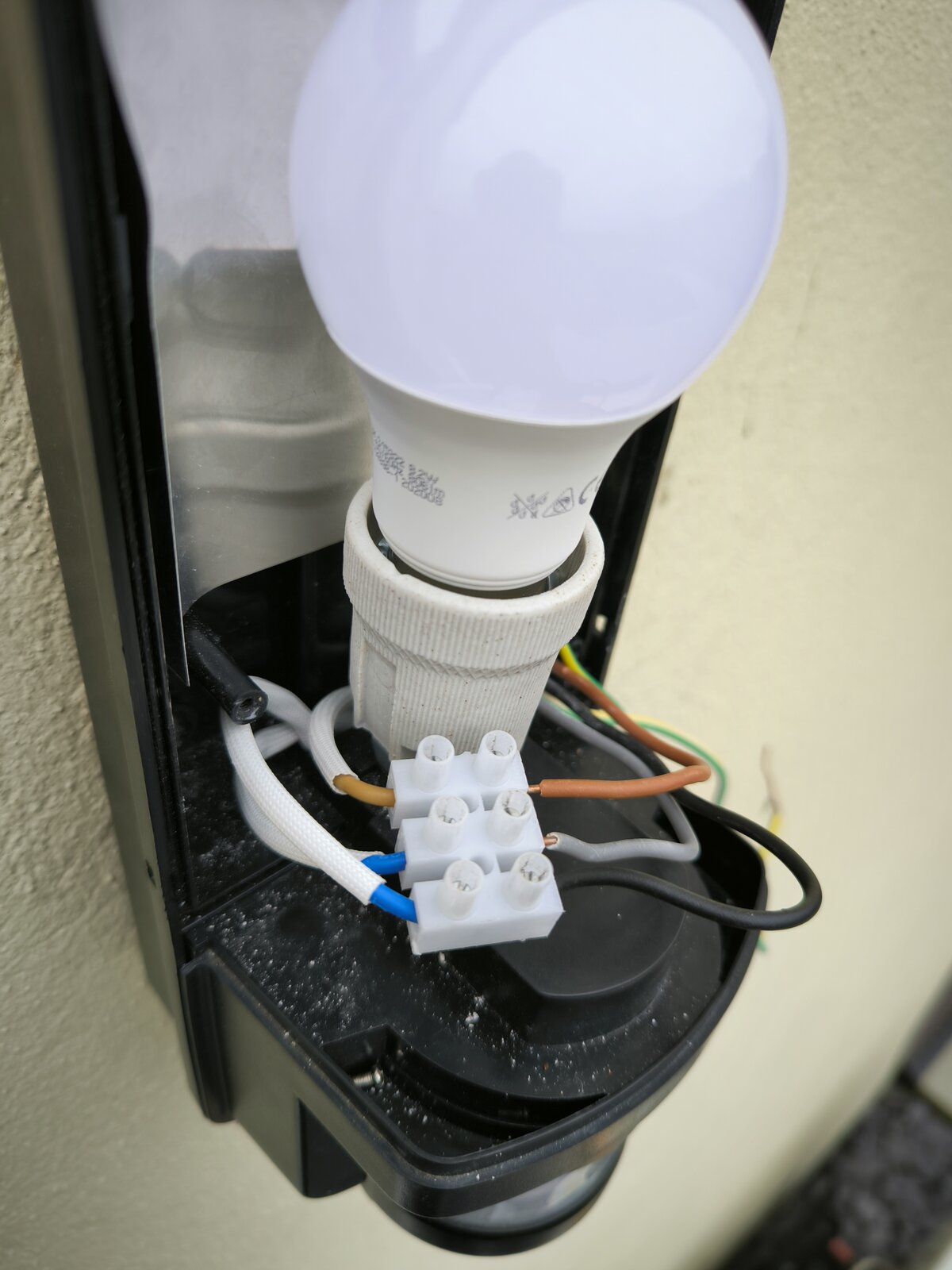

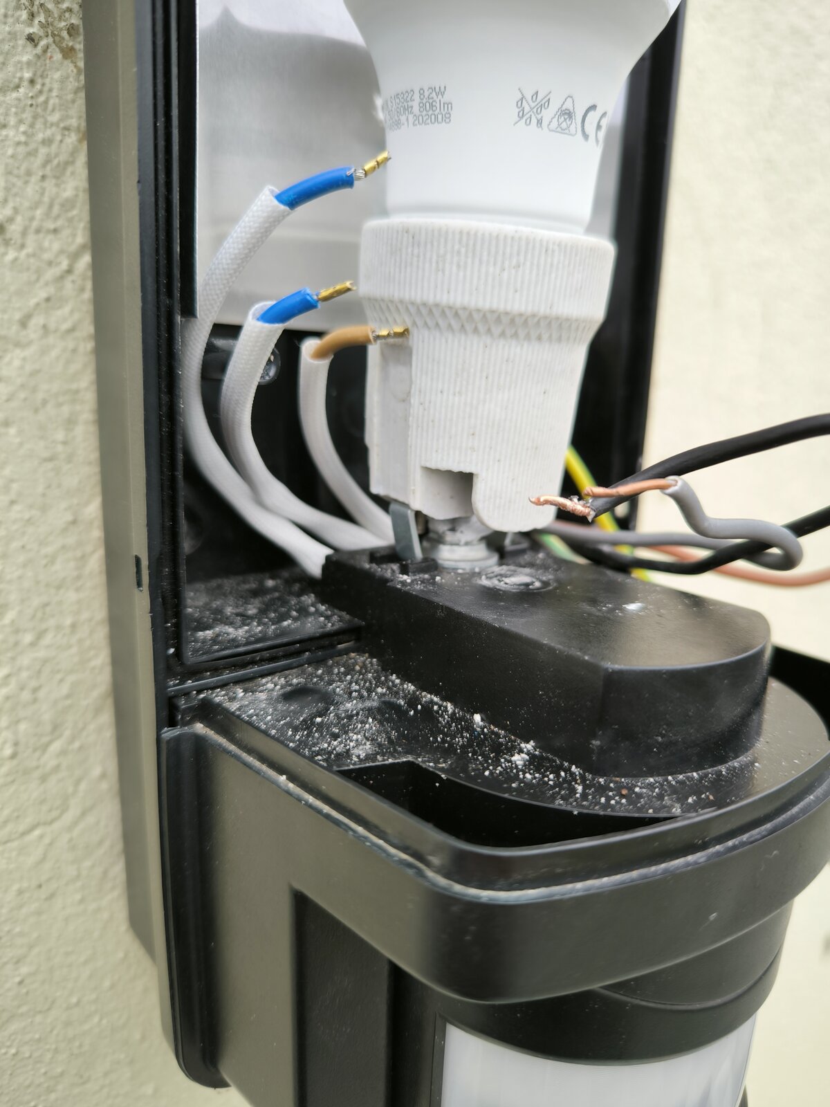

Hi everyone I'm at my wits end with this one I've removed a light from the front of the house and wanted to put it at the back of the house it's a pir sensor light but we don't have it wired up we just use it as a normal on off light from the wall switch at the front it worked fine but I'm having issues hooking it up to the back I've connected brown to brown n to n and it makes a click noise when I turn it on at the switch now the actual light fixture has 2 blue wires and a brown and by the looks of it one of the blue is meant to be the live I've tried all combinations of the wiring but I've come up stuck so any help would be appreciated

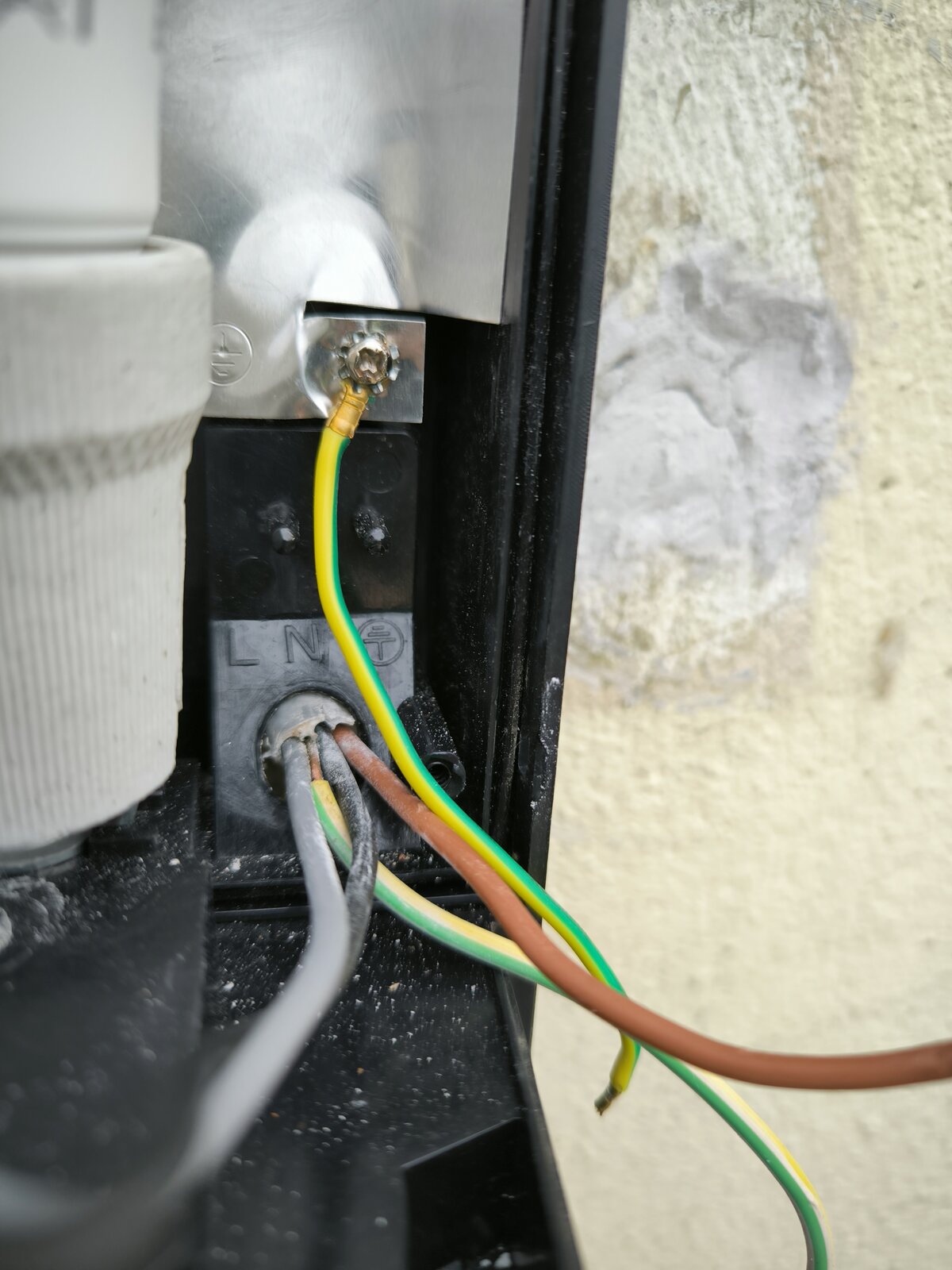

Where would I even connect the earth cables to
I would guess that the click is the PIR driving a relay during its settling period on first power.
I would doubt very much that either of the blue are meant to be live connections.

I am just wanting to confirm which colour wire is which. I would assume that grey is N and black is SL but it is an assumption without knowing for certain.
Lamp information might be useful as I have a lamp that does not specifically have an over-ride connection but it is possible if you know what you are looking at.

You will need a separate terminal block for the earths from the cable and backplate
Grey is neutral and yes black is sl but was not connected to old lamp nor was it connected to this one out the front
I am finding it hard to understand how it could have worked as a straightforward on / off lamp with the wiring available internally. My best guess would be that the fitting has a relay that switches the L to the lamp and the two blues are permannent N to the fitting and lamp. So I would connect the blues togther and L or SL to the brown. See if that works. I guess that the switchhing of the supply to the fitting causes the timer to start giving the impression of being switched by the internal house switch
I suspect that putting L onto a N may have caused damage
So the 2 blues that are attached to the unit go in to the terminal block together and on opposite end I put the n?
Good. Just pop the earths into the spare way and the connections to the L / N could do with a little tidy to remove the exposed copper
