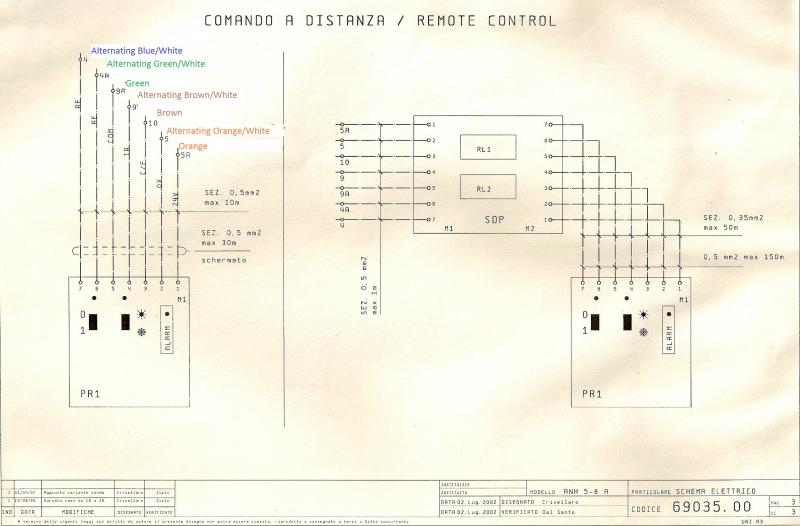

So, my question is this: How do I wire the CM927 to my heat pump? Once again, its an Aermec ANZ0507HA, of the Italian manufacturer Aermec. I will provide you with the wiring scheme I received when the installer installed the equipment and the "remote controller". This remote controllers is actually a very simple device which is wired to the heat pump directly, and provides me with very simple controls (one switch for ON/OFF and one switch for HEATING/COOLING). This is a picture of how it's wired:
And this is the scheme I received when they installed the remote:

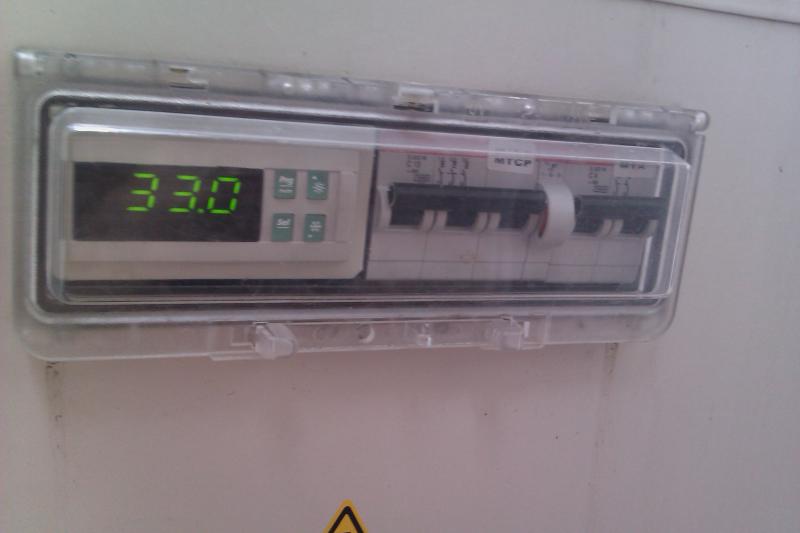

If I want to change some parameters (like water temperature or something else) I have to go outside and use the controller that's built in in the heat pump. This looks like this:
So can anyone advise me how to connect the CM927 in order to control the heat pump?
