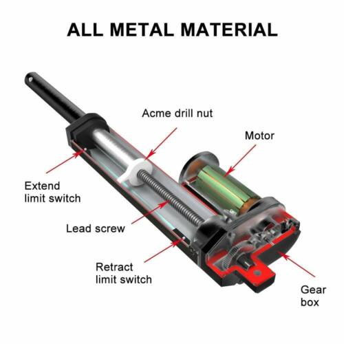

Right, linear actuators are looking like the way to go. Similar "format" to a hydraulic ram but no oil to leak out of them. Lots of different sizes available. Can pair them easily enough. I understand electronics more than hydraulics.
Just need to work out how many Newtons I need. I assume they're just a big threaded screw inside as the load and speed are proportional on all of them.

As often used on steerable satellite dishes. They can provide positional feedback.

Have you considered a long threaded bar, running on a bearing at the top, nut fixed to the work surface and a reverse-able motor to turn the rod?
I looked at lead screws and the associated bearings, blocks, etc but wasn't sure how to size them. However, it seems like a "linear actuator" is essentially all of that in a package.
From an Aliexpress listing:

2x 450mm 1500Nm linear actuators have done the job. They don't track each other perfectly and they're a bit loud, but they work.
Should have expanded on that a bit...on the test bench they move at slightly different speeds and one is 15mm longer than the other at full extent. But the "carriage" I built that slides up and down is quite rigid in that axis, so it doesn't make any noticeable difference.
