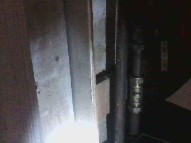

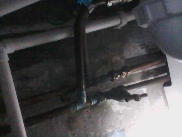

  • One red gate valve (main cold water feed) in a high cupboard outside and above bathroom door A stopcock under the sink on 15mm cold feed pipe and hot water pipe under the sink has a 15mm check valve on it Mains fed water but when I turned both stop cocks off the hot water still runs which makes me think that the attic or somewhere in the building must have a water tank.
  • I did find another stop cock in the kitchen it is boxed in another wall near the bottom of the boiler pipes but when I turned it, it didn't do anything perhaps it was used when the old hot water system cylinder was used.

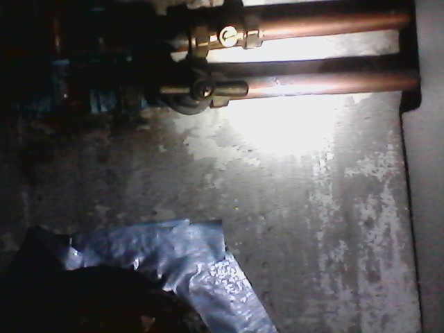

  • There are two 22mm pipes in the high cupboard and cold water pipe has a 22mm NRV on it but not the hot one.

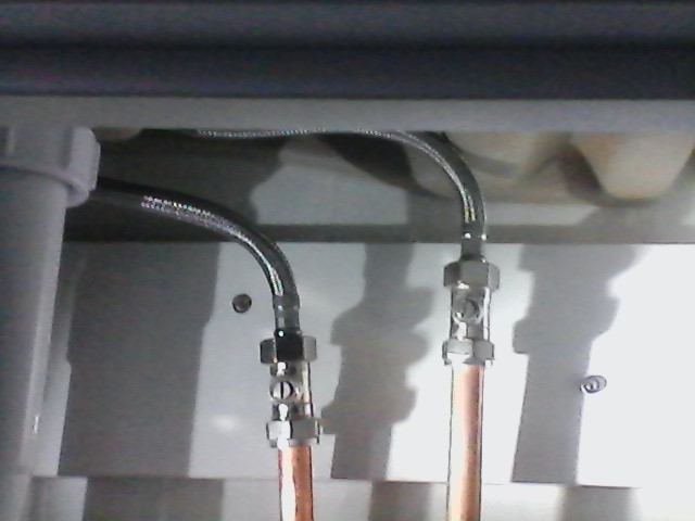

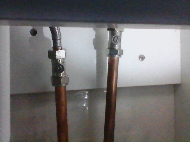

  • The cold fills a 8 litre bucket in 20 seconds the hot 8 litres in one minute I have single lever mixer taps in the kitchen and bathtub and basin The bathroom and kitchen used to have two hole single taps.
  • Both in the kitchen and bathroom have pipes with isolation valves Do I need check valves of any kind in the bathroom basin and kitchen or does it seem legit as from what I can see I just have isolation valves which turn off the water.
  • When I run the fountain mixer taps in basin and bathtub, when touched one side of water running is cold and the other hot, do I have the right taps for the system as the kitchen tap has a single lever round tap and when I touch the water both sides are balanced e.g warm or hot water and their is no hot side or cold side to the water.
  • Do I need check valves of any kind in the bathroom basin and kitchen or does it seem legit as from what I can see I just have isolation valves which turn off the water.
The kitchen hot pipe feed under sink has a check valve and the basin isolation valves I think, see pics.

If you do indeed have a combi boiler, then check valves are not normally required.
