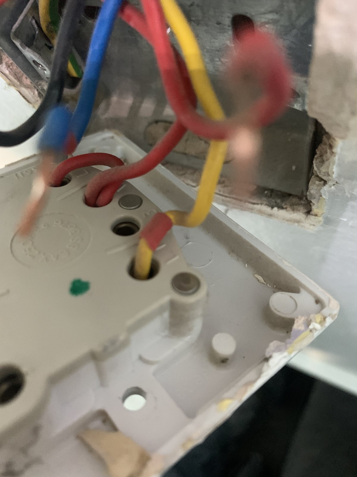

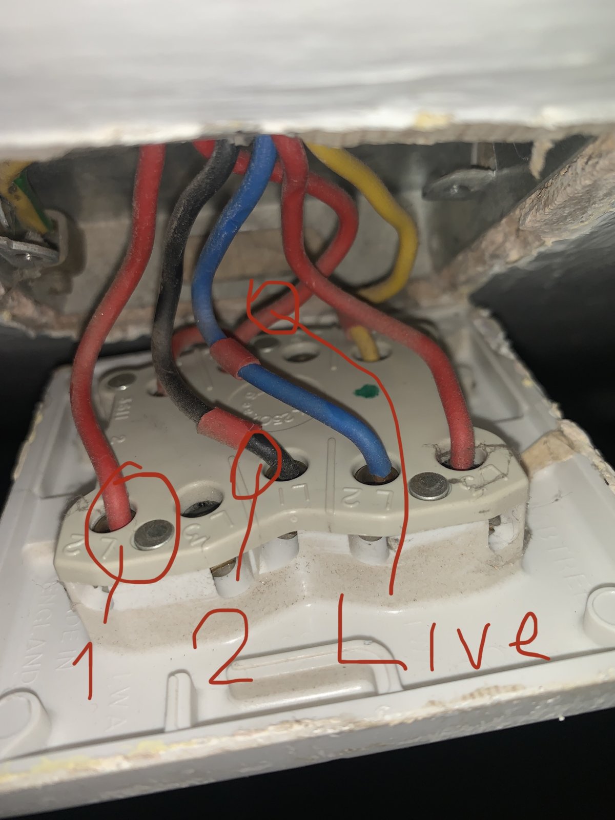

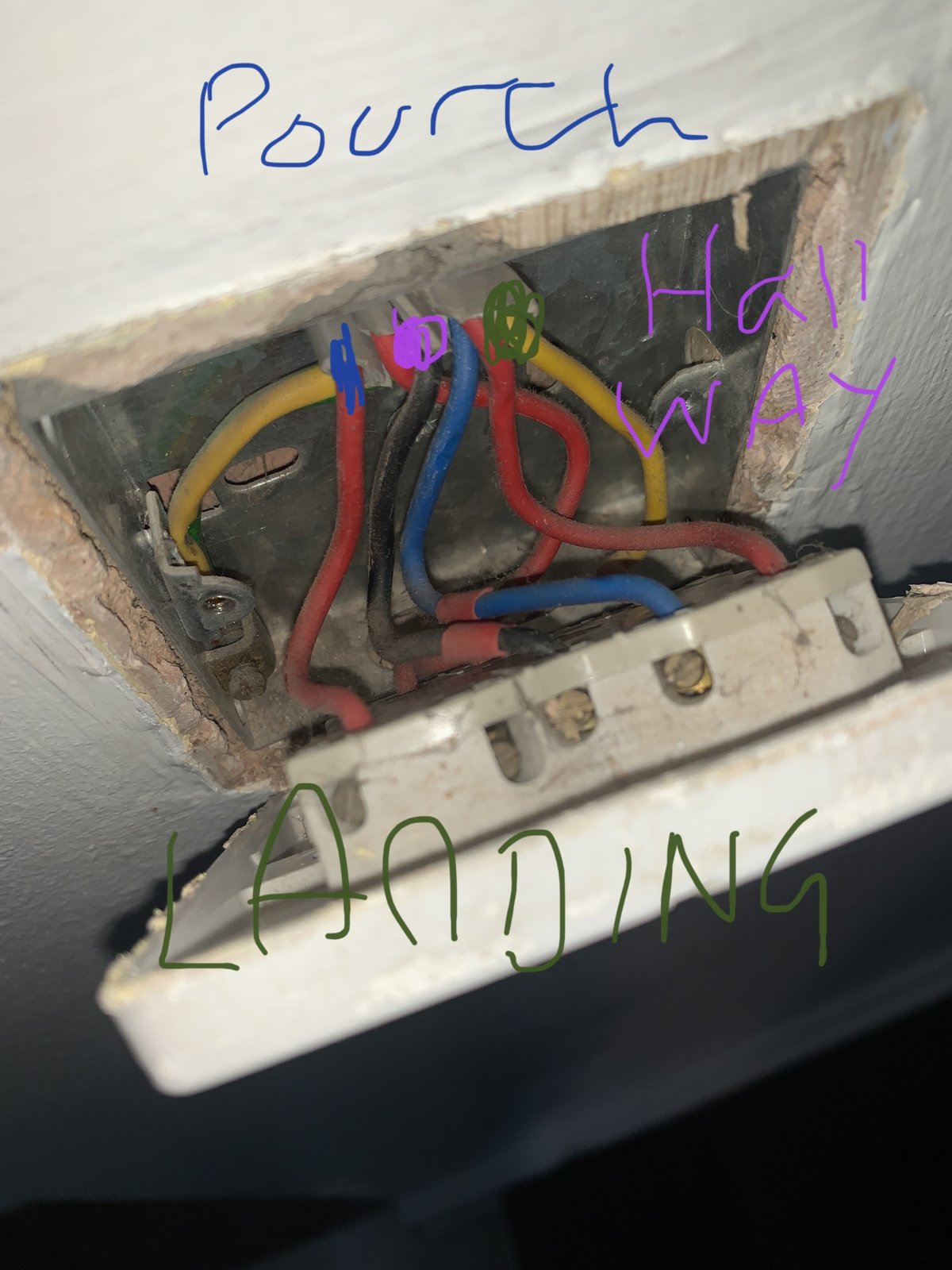

So id like to have some smart light switch's installed. A 3 gang to control a pouch light a downstairs hallway and a upstairs landing light plus a 1 gang to also control the landing light.
So i unscrewed the 3 gang switch just to see if i have a neutral as most uk homes dont have a neutral as i dont i went and ordered these two switch. Thinking it would be a straight swap im a little lost on whats what? Now iv figured out which ones are the porch and hallway light but lost on what the blue with red sleeving is yellow with red sleeving and the red as this would be for the upstairs landing.
Now looking at the light switch upstairs it appears i have a neutral but not 100% sure if it is then why are blue and red in L2
There aren't any neutrals at those switches. The blue /yellow / reds are all live conductors / Strappers for the two way switching.
You know what iv been banging my head to figure out whats what but now realised they are more likely 1 ways. (Doh) Now trying to find a 3 gang 2 way and 1 gang 2 way that dont need a neutral :mad: :confused::confused:

If using those switches, it's essential that all of the lights are on the same circuit.
If there are separate circuits for up / down, then you can't use those switches even if they don't require a neutral.
Also unclear how the 2 way switching will work with those one way devices.
Yeah I realise now that they are one way and that it’s hard to find any 2 way switch’s. It also makes sense that they would need be on a same lighting circuit.
So my question now is how would anyone control a upstairs landing light on 2 different light circuits using 2 2-way smart switch’s?? I’m pretty sure iv seen some that sync together. I’ll have a look at them lightwave brands.

Danny B - What you have is not going to work as you don't have a neutral
Choices
a) Get Smart bulbs and don't touch the switches ever again
b) LightwaveRF - You would need to buy master and slave set up - the link between them in a 5-volt connection (https://www.amazon.co.uk/Lightwave-...=lightwave+master+slave&qid=1575910859&sr=8-2)
Problems - Lightwave let through a little bit of electricity to power themselves (they are on a very little bit all of the time) - if you get the wrong bulbs eg LED ones that require very little power they mat flash
For this country, smart lights are a bit of a nightmare
