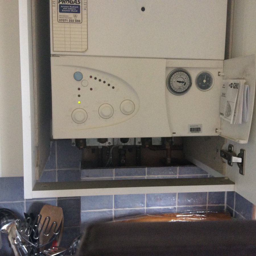

Hi all we have an ariston microgenius 23/27 mffi
Lovely chap came yesterday to do annual gas safety check (which it passed with flying colours)
However now we have no heating or hot water
If you switch hot water tap on, the boiler makes all the right noises and then the red ignition failure light comes on. There is no pilot light on when we look through the viewing hole. Have pressed the reset many times to no avail. I'm sure it is something simple he may have forgotten to switch back on but as its the weekend we are unable to get an answer from the office.
We have gas to our hob so I am guessing the supply is on...
Hope this is enough info for someone to help!
Many thanks,
Mary

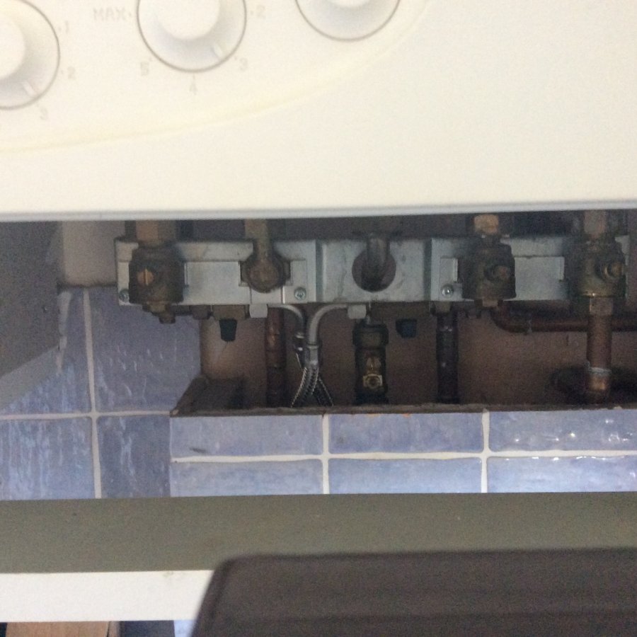

Forgot to say that all the valves on the pipes below are open except the 2nd from the left which from the manual is the domestic cold water inlet? Also pressure is at 2
Check gas inlet tap is on. Apart from that you will have to wait for Monday. You could try texting him with your problem he may pick up.
I think your right, was just wondering if it was something I could do - can I ask where the gas inlet tap would be - manual says it ps the pipe in the middle (in the pic I posted) the screw bit is showing open (sorry have no idea what it is actually called) :rolleyes:
Have tried texting but no luck
Oh my goodness you're a rockstar, the valve was switched off!!! Thank you so much, just made our families weekend so much better :LOL::LOL::LOL:
Phone him Monday and tell him off.:) Pressure to system should be approx 1.2bar with the system cold reduce pressure by bleeding a radiator.
