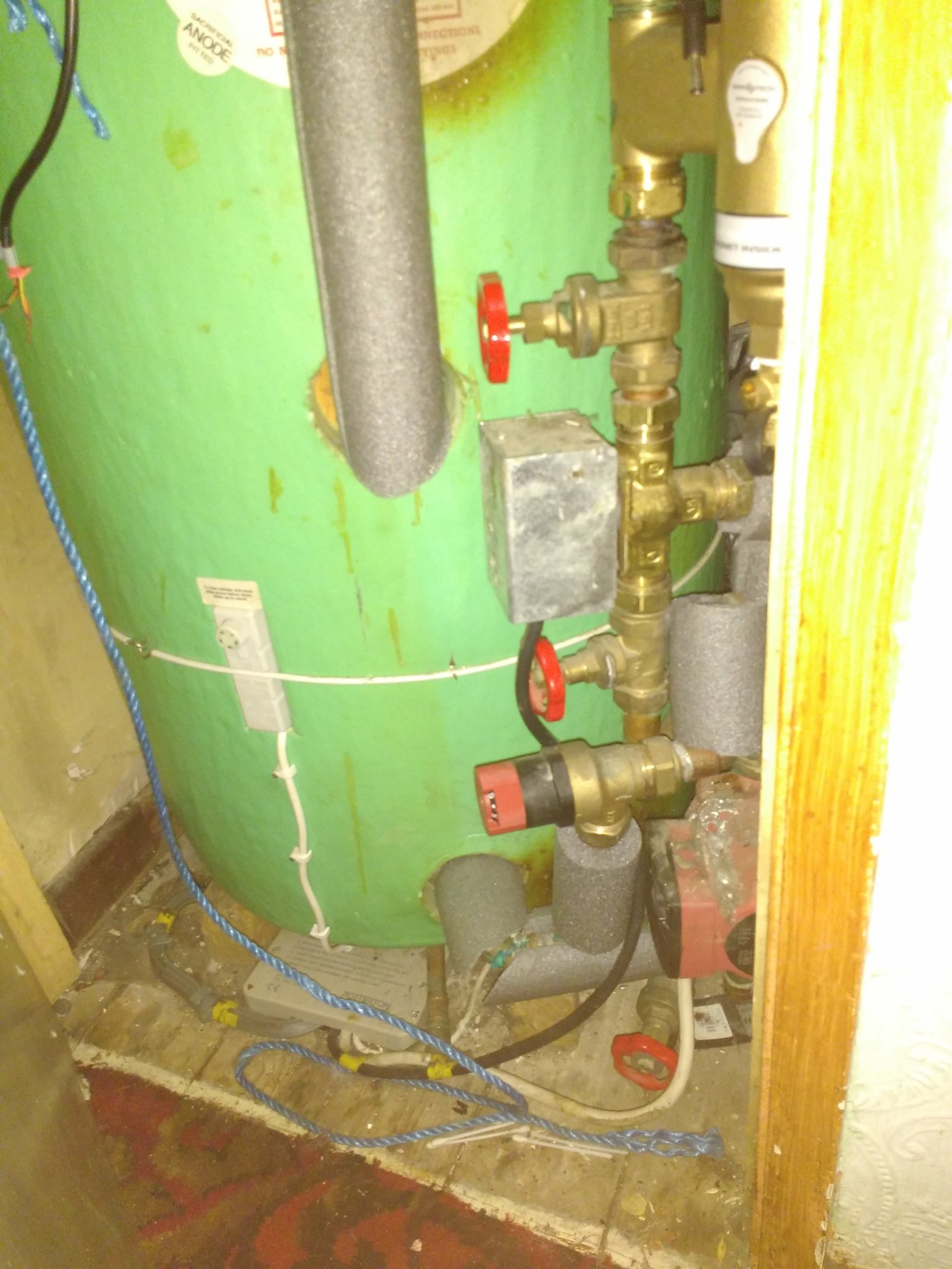

I think we have a combi boiler, i turned the three red stopcocks clockwise on the boiler to stop the hot water supply.
Ive gone to turn them on and no water from the hot tap?
A picture of the valves/pipes would be useful. Make, model?

Done, i think it might be a airlock as i put something over the cold before (months ago) and the water started to come out of the hot but now i'm having no success just spray everywhere.
Tried turning red cogs all anticlockwise also.

OP, you 99% don't have a combi boiler but a system boiler on a Y plan.
Bottom valve to the bottom right of the picture may be the cold feed to the cylinder. It may be stuck/broken?
You say hot tap? Is that singular or all of them?
The two above are pretty much redundant and only isolate the 3port valve.
The red one withe the cap and numbers is an auto bypass so leave that alone.

That's a hot water storage cylinder not a combi.
The upper 2 are central heating not tap water. Lower one would have to guess.
Look up "airlock" or "Air Lock".
If you have a mixer tap in the kitchen and are fairly strong-handed, turn the HW tap on, then the Cold, with the middle of the palm of your hand HARD over the end of the tap. Cold should push its way up the HW side to fill the pipe with water. Take your time. When you let go, the HW should run.

Ah I have been trying with the two taps upstairs, thanks I will try on the mixer tap downstairs also well tomorrow :).

If you Happen to have H and C washing machine supplies, join them together with a hose and open both taps for 10 seconds.

'Tis worth trying to remove a possible airlock, but my money is on you having snapped the shaft of the valve on the bottom right. If that is the case then you may have to dig in to your (or your mums) pocket for a plumber.
Was that valve easy to turn or was there quite a bit of resistance?

Were all easy to turn, turned them off as wanted to try to remove old taps in bath to install mixer taps.
Given up now though especially as hot water is gone, it happened before on two occasions then i had done nothing so might be something other causing, just this time the blocking one tap the cold and opening the hot isn't working.
Yeah i think i may just call a plumber tomorrow as its not turning out as simple as it looked.

Thank you thats a tip i will note :). The tap method didn't work this time despite the times trying but this did, only 20 seconds too.

The other method's an aquavac on the tap. Sorry I should have remembered!
Do yourself a big favour and get rid of the red handle gate valves, well known for coming apart inside, had this problem more times than I can count over the years something like changing a tap washer turns into a much biger job, Replace them with FULL BORE LEAVER VALVES simple to do for an experienced plumber
