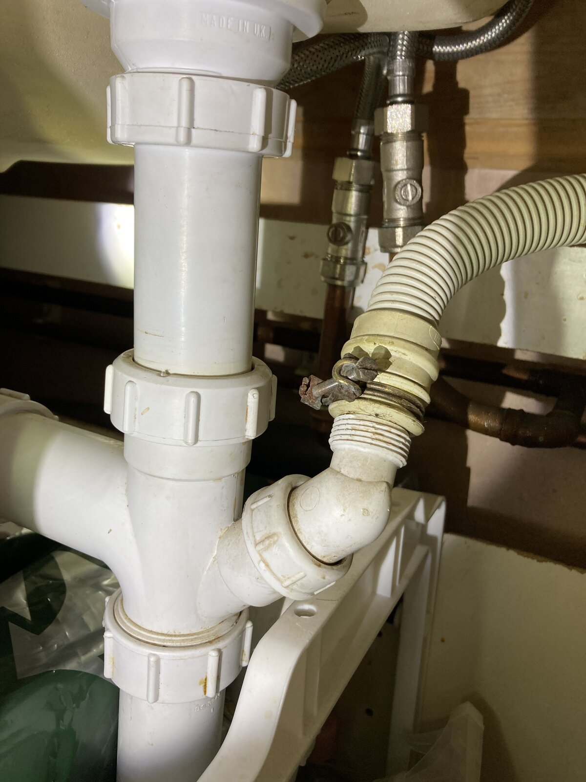

I cannot see any obvious none-return valves on your appliances, but the above should protect them all. Possibly the back flow, was just a result of several discharging water at the same time?
Looking at the dishwasher connection in the top picture, there is an arrow on it so I’m assuming that it must be fitted in the direction of flow so possibly a one-way valve?

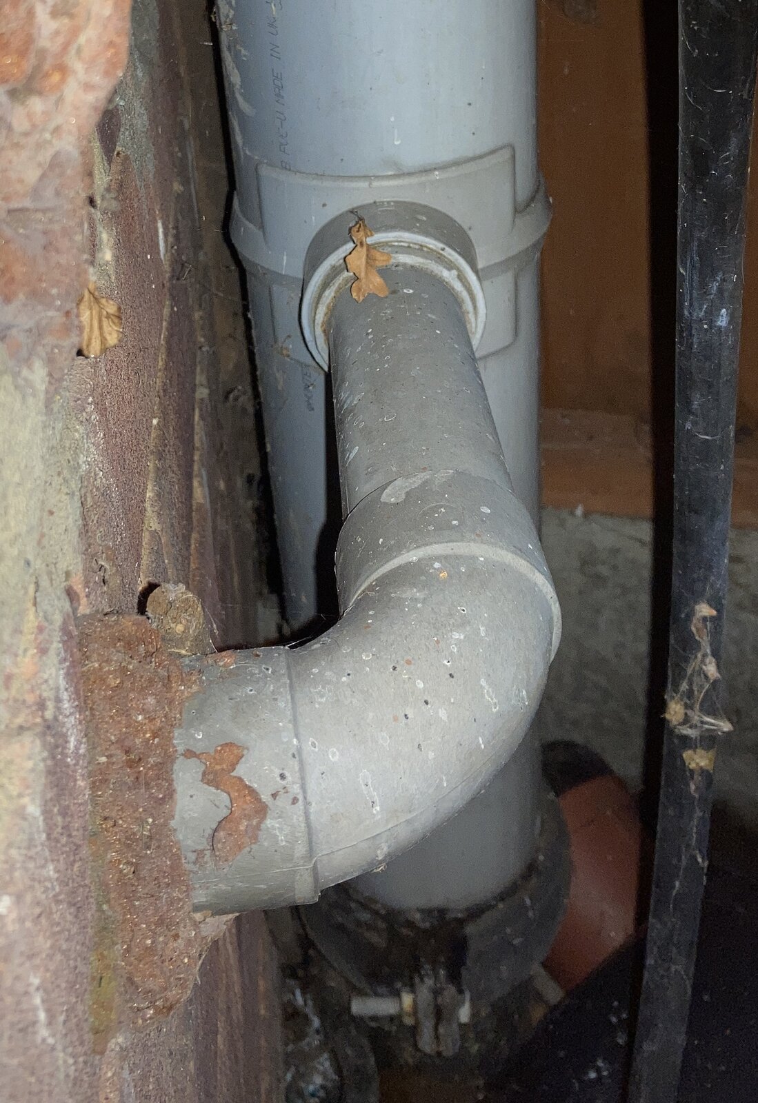

That’s good because I have two of those - one inside and one outside. Might have to fit it inside though as the outside one is only about 6” long with glued ends and fixed where it comes out of the wall via a 90° bend and the soil stack with no wiggle room to get it in.
I'd be careful trying to cut into the external section in your picture, it's all solvent welded, and looks rather weather worn, may shatter once you try and cut it. Although it does appear you have a plastic stack going into a 'Timesaver' type joint onto the cast, so be prepared to replace a section of the 110mm if the worst happens.

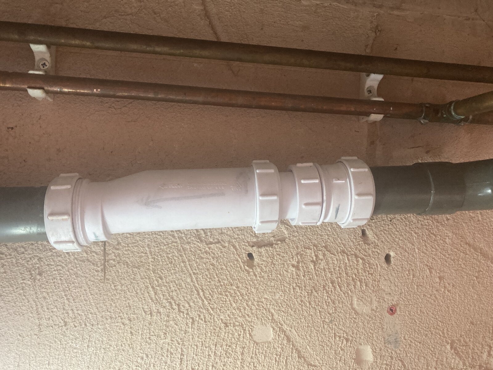

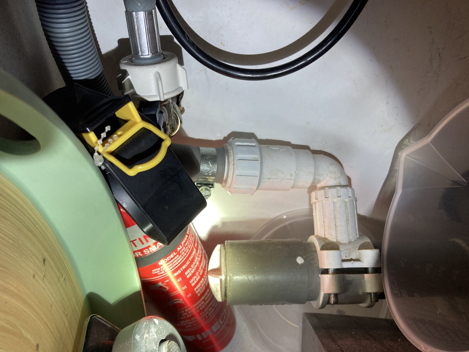

I was talking to my mate about it and he said he'd fitted a non-return valve to his shower waste to stop smells coming up but it didn’t work - the water wouldn’t flow away. Looking on the instructions, he then saw that it wasn’t suitable for showers so he took it off. He gave it to me - THIS ONE.
I've just fitted it to the pipe going from my sink waste to the soil stack. Water from the sink and washing machine flows away fine. At least I have something there that should hold back the flow of sewage should the drain block again. Fingers crossed!
Sorry but you would of been better of fitting the first one imho.
Sorry but you would have been better off fitting the first one imho.
Apart from regular maintenance, the first one had to be fitted on a horizontal pipe and the only horizontal pipe was too short to fit it in. Hopefully this is only a temporary solution until the drains are fixed properly.
