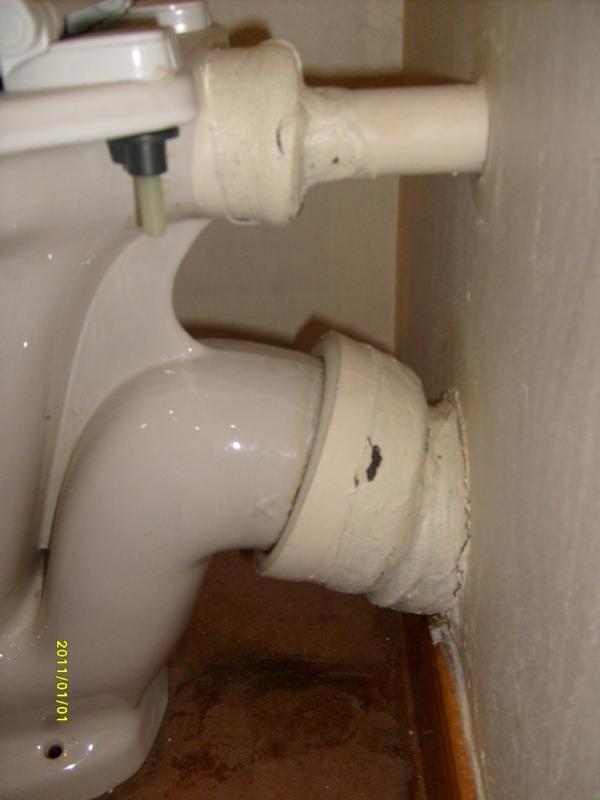

Realised I needed to replace rusty screws holding down the loo (never noticed before - scuffed stained cork can be useful!) But they had rotted away- like carpet tacks - worried how to get new screws in cos rusty bits will still be there, also I would need to try and slip the vinyl tiles under -not ready for flooring yet - so left it unscrewed....
Small person has been climbing - and pulled it away from the wall - both joints are now leaking...
Flush pipe I can handle (famous last words) - the waste is more of a problem..

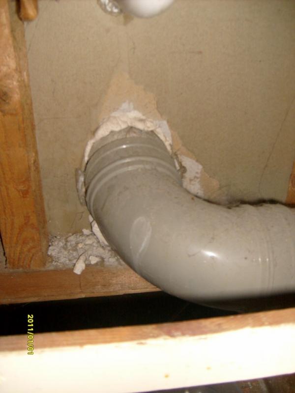

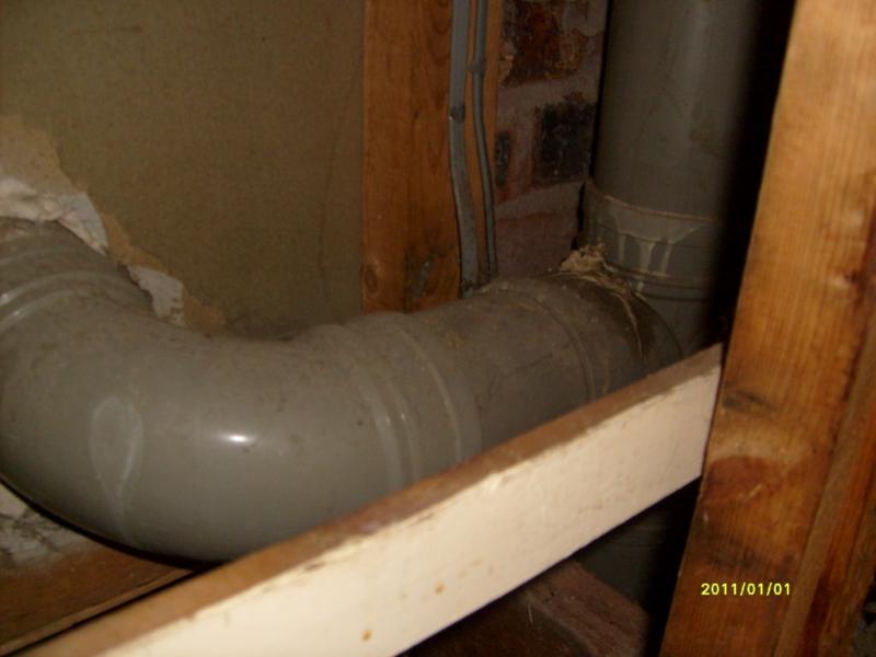

Waste pipe finishes just inside plasterboard wall. Approx (denso in way) top of soil pipe is 21 cm from floor. Top of waste outlet from the toilet is 25.5cm from floor - distance between toilet outlet and wall is approx 9cm.
I suspect the loo is the original from 1970 - soil pipe connector is plastic - are they likely to be standard sizes (only loo in house - want to get everything ready before attempting- can't pull it to pieces to measure just yet)
I know I can buy a double offset at 40mm...will I get away with that? Is there anything bigger? Also how long are they - is that all I'll need? Bearing in mind rusty screws and leaking flush pipe - I can (probably should) move the pan a bit - probably closer would be better (could shorten flush pipe..) . Also noticed on the pan is a 'K' current connector is not on that far (see photo)
