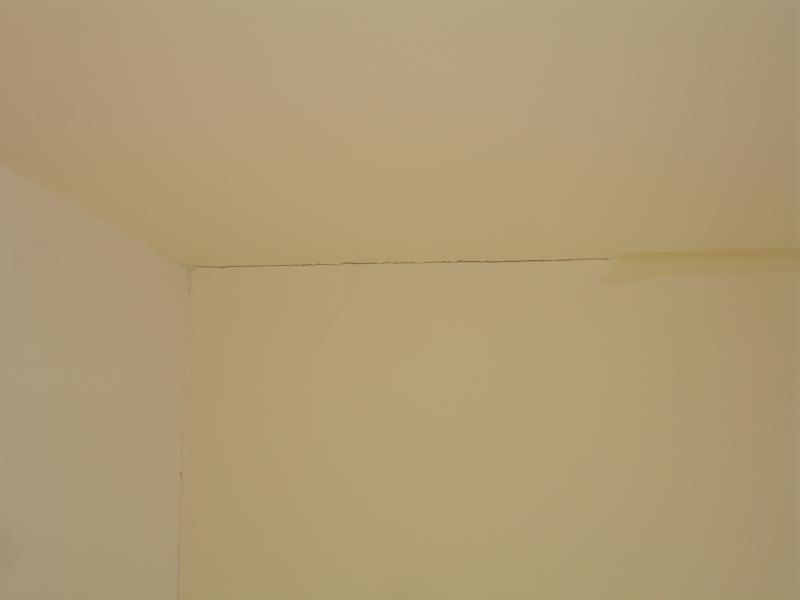

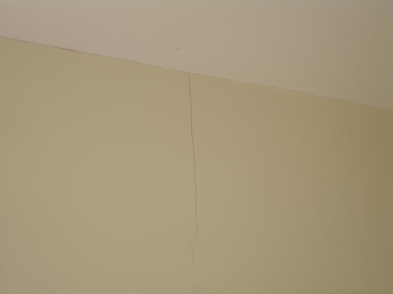

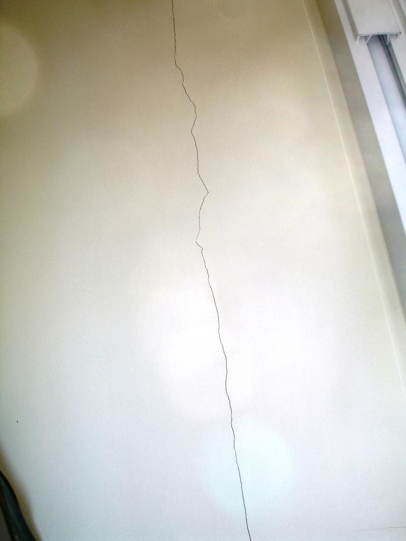

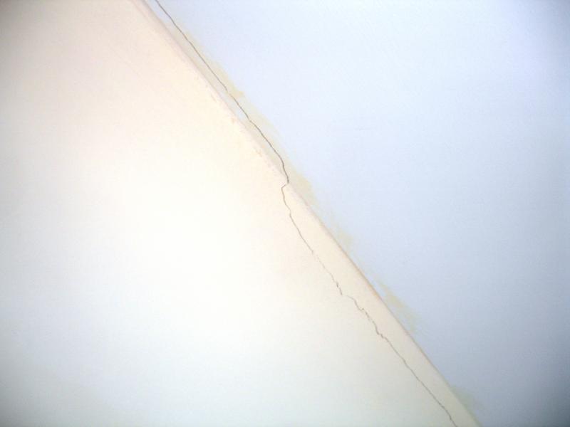

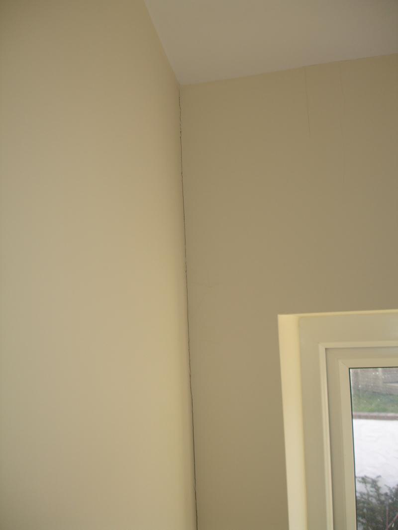

Hi all,
Hope someone can help and easy my worries! Basically I bought my first house last May and up to now all seems to have been fine. However I have started to notice quite a few long horizontal cracks on the walls about an inch below where it meets the ceiling and sone cracks that weave onto both. In other rooms the crack goes along the wall/ceiling join and sometimes vertically down the corners of the room. The house was built in 2001 and I am presuming that the walls are covered in plaster board or simular product. Some of the walls look like they have already been patched up in the past. I have heard that this can be commmon in new houses due to settling but I am also worried about subsidence and foundation problems.
Does anyone know much about this, is it something I should be worried about? Any help is much appeciated. (can provide pictures if neccesary, but new to the forum so don't really know how at the mo!)

Try to get some pics up for us to look at Katy...And dont Panic......
If your walls/ceilings are made of plasterboard, it sounds to me as if your tapes are coming off. Rub the back of your fingernails up the affected corners, if it sounds hollow underneath, the tapes are loose. The solution is to remove the loose tapes and have new tapes fitted.

Now you have some pictures up, it does look a little more than just tapes coming loose. I think most of them could be due to some slight settlement/movement within the property.
Roughcaster.

Hmmm not sure about your plasterer; sounds like he was covering his arse to me :LOL: That stuff isn’t going to repair cracks like that I'm afraid & I’m with RC; difficult to say from the pictures but there seems to be a bit more going on there!
Thanks everyone for your advice, I understand pictures can't tell everything but I really appreciate your advice. Still not quite sure what to do next. Have sort of come to the conclusion that there is movement, which is very worrying but kind of hoping that because the house is only 8 years old it might still be settling, fingers crossed anyway,
