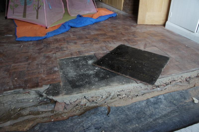

I have recently had one of my rooms extended. The room has parquet flooring. It is finger parquet that comes in 460mm squares and is about 10mm thick. It started from where the old wall used to be and is gradually creeping further and further in to the room. I haven't extended the floor into the new extension yet but I'm now worried that it will all have to be relayed. Has anyone got any idea what's causing this? There was a leek from the radiator when it was removed from the old wall and this does seem to be where the problem originates from. What I don't understand is why it still sems to be progressing across the rest of the floor. Any ideas ? :(

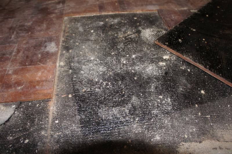

The mosaic is the old floor, that was fine before the building work began. The new area hasn't been laid yet. The screed for the new area hasn't even been laid. The old floor was laid with some kind of black glue - it doesn't look brittle enough to be bitumen. The glue has obviously been applied with some kind of notched trowel but very thinly.
I thought so. Bitumen, the old adhesive, is getting brittle and the leak hasn't helped.
It is loosing the grip with the mosaic and will keep doing this.
Lift the floor, remove all traces of the tar, repair the concrete where needed and fix down again with modern adhesive (F.Ball B91 is a good one for this)
Holy flood gates. That sounds like a big job. Do I need to lay a liquid DPM as well? And will I need to shot blast the bitumen off or just scrape off as much as I can? Thanks for your help

The mosaic is laid with a very thin layer of the black stuff - it's not brittle which is why I wondered if it actually was bitumen.

If the tar is only on the back of the mosaic you might be in luck. Some mosaic came with tar paper to be stuck down on the concrete.
