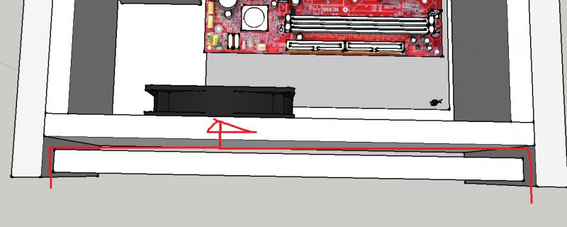

Hi people as you might of guessed from the title im attempting to building a desk which will enclose my pc tower so you will only see the monitor. as its going to be enclosed in say a wooden box. I'm planning to have 2 intake fans on one side 2 fans inside to help push air from one side to the other, and 2 fans at other end blowing what should be warm air out... this is the plan. I also want to be able to control the 2 intake fans via software or hardware and control 2 inside fans and the 2 fans blowing out all separately. so i have full control of my air in / out and airflow inside my desk if that make sense.
So to control all 3 sets on fans am i better off using software or hardware and what hardware ? I know you can get fan controllers but will they allow me to control 3 sets of 2 fans individually or is there some software on my motherboard that can do this?
Is this my best option : http://www.overclockers.co.uk/showproduct.php?prodid=BB-006-AK&groupid=701&catid=2331&subcat=189
also am i missing something or over looking other ideas?
any feedback will be most appreciated
Pc mobo: MSI-Z77-Z77A-GD65
Fans: ASASA viper s-flow 12cm 4 pin connector x 6
550w PSU

A solid wood enclousure will significantly dampen noise, the problem is air inlets/outlets.
If you cut out a round hole for the fan and face it outwards, that is a direct route for sound to travel through, there will still be some reduction but you might find it dissapointing vs the effort.
Creating 'funnels' where any sound has to do a 90 degree turn to escape will help much more, you could just make little rectangular boxes so that fans are offset away from intake/exust grills.
Foam at the thickness you can practially use doesnt really dampen sound, it does help to capture it (stop it bouncing) into the mass of the case / desk, so the mass of the structure is what matters here.
Thanks for the picture, that would be a possible solution with my design, how much effect on the efficiency on the fan would that have ?
I made sure the slits for ventillation added up to the same surface area as the fan.
It doesnt have any appreaciable affect on the airflow.
On one experiment I made smaller slits, it didnt seem to affect the fans output but it did create a suction noise.
