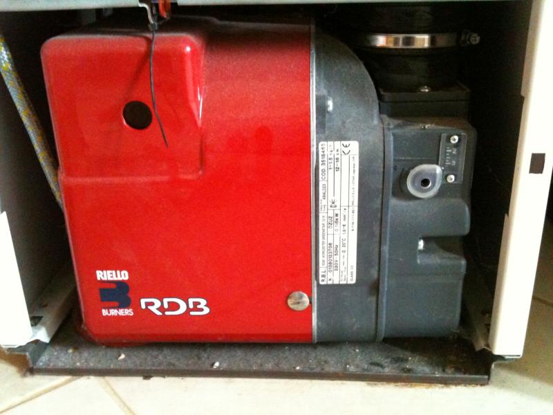

We ran out of oil at xmas time and unfortunatley i left the boiler running and it went onto lockout. We turned it off as we could not afford oil. We have now just had some delivered but when i press the reset button the boiler starts up with power but dosn't fire up.
I have heard there is likely air in the system and it needs to be bled out. Could someone advise how this is done? I would rather my partner had a go at it if it is simple to save on a callout from a plumber.
I have attached a photo of the pump.
It has on it Riello Burners RDB RDBI Worcester Greenstar 12/18
I understand i need a plumber but would like advice on how/if we can bleed it ourselves to save some money.
Thank you
Can you see the silver flexible oil pipe just to the left of the red burner?
The pump is on the end of that.
Remove the red cover (you can see the screw on the right) and crack open the nut on the end of that flexy pipe 1/2 a turn - air and oil should come bubbling through.

It may well only be air in the pipe!
But it could also be as a result of sludge from the bottom of the tank blocking the inlet filter!

Remove the Red Cover on your Burner, at the left hand side you will see the oil pump, there will be a Hex extension Brass or steel stcicking out of the pump towards you (under the black plastic control box, in the end of the extension is a 4mm Allen plug, hold some paper towel around the hex and remove the 4mm plug, untill oil runs free, (it won't gush out just a trickle) refit the 4mm plug, after ensuring that the little "O" ring is still attached to it, tighen up press reset and away you go!! ;)

My OH knocked on a plumbers door up the road and said we could not afford a call out fee but could he come look and he did and told us how to bleed it and its all working now. He said just what you guys said.
He said we are missing a filter which we can buy for a few quid.

Maybe you will have noticed that the tank outlet isn't actually at the bottom of the tank - this is to allow settlement of any sludge / water.
When using the dipstick, you have to take this into account.
John :)
A fuel line filter is always a good idea if you are going to let it run out of oil often to prevent sludge blocking the burner assembly.
When run out, if the tank has not been drained for a while its a good idea to let out any water collected at the bottom. There is usually a drain plug to help that. Also wait a few hours after refilling to allow disturbed sludge to settle.
