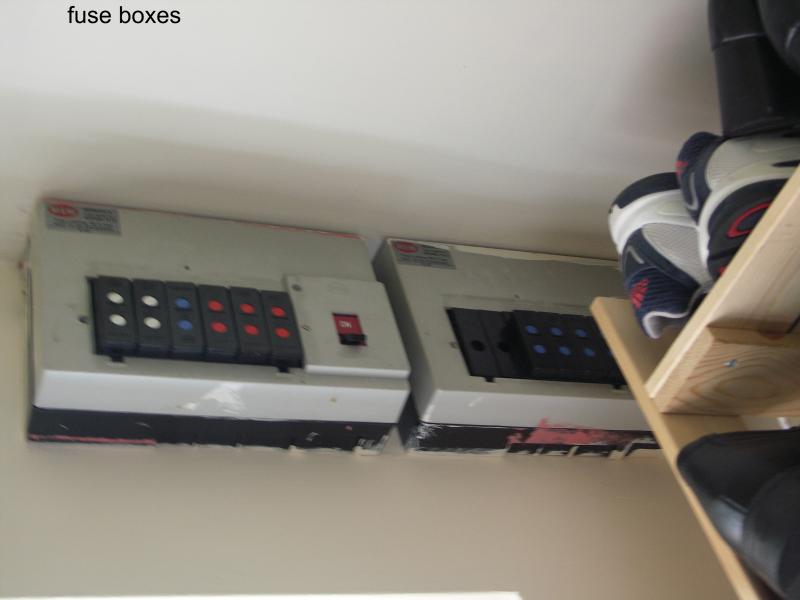

I've taken out an storage heater recently and wish to put a main socket point over the existing supply point.
what else do i have to change? do i have to replace the fuse on the fuse box with a higher amp?

the fuseholders with blue spots are (should be) 15 Amp. there should be only one heater on each circuit. if this is so you can put one single or double socket in place of each heater.
However, I presume you are doing this because you have insufficient sockets, and the CUs are probably in the region of 20 years old, so the guys want to know the age and condition of your installation since it might be due for renewal.

The RHS board ? Is it 6w, 7w or what (can't see far RHS die to storage obstruction).
That is obviously the storage heater CU and as such you would need to identify the cable that feeds the position you want to change to a socket.
Once done you would then have to take the cable out and move it over to the LHS board and wire it as a direct spur from the 30A (red) fuse position that corresponds to the floor ring circuit.
It's all a bit too fudgy for my liking and isn't a DIY job.
Is there not a socket near bye on the ring that could have a spur wired from it to the intended area, it's likely to be easier.
Although not unsafe, fuse wire carriers are a bit 60's / early 70's and I'd be thinking of a wiring update, a CU change to a 17th ed board with twin RCD's as a more likely priority first.
Could I suggest you have a PIR (periodic Inspection report) done to confirm the overall condition of your wiring is good, then if it is £300- £400 should get you a new fuse board / CU with the modern safety requirements of RCD's and switchable MCB fuses.

Can we see a pic of the meter(s) and any timer please? What Tariff is you electricity supplier charging you on?
