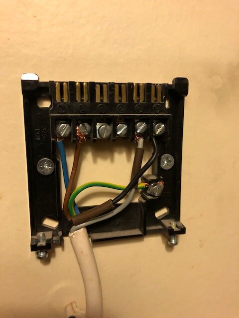

I can re-use the same wall plate which currently has blue going to the N terminal, brown going to the L terminal, no wires on terminal 1 or terminal 2 and then grey going to terminal 3 and black to terminal 4. Earth wire goes to earth.
When i take off the existing controller from the wall plate and replace it with the Hive controller, the Hive controller lights up at the appropriate time (so no issue with the Hive connecting to the thermostat) but the boiler doesn't fire up?
Can anyone tell me how I need to swap the wires around on the wall plate to make the Hive controller talk to the Alpha boiler please

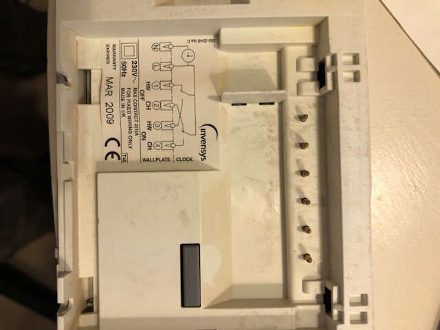

The current controller (the one that I am replacing) is a Drayton Tempus 7 which currently has blue going to the N terminal, brown going to the L terminal, no wires on terminal 1 or terminal 2 and then grey going to terminal 3 and black to terminal 4. Earth wire goes to earth. I think I need to change the order of the wires around for the Hive controller to work??? Thanks

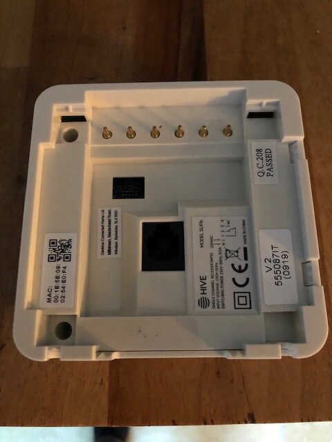

Drayton Tempus 7 appears to be a dual channel, eg heating and hot water? Do you have single or dual channel Hive?
Move the black wire that is currently in terminal 4 to terminal 1.
Done.
Hi Johnmdc. I had REALLY hoped that your suggestion would work but having moved the black wire from T4 to T1, boiler still doesn't fire up (the thermostat is on full and the green light is on on the hive controller) ??? Sorry. Any other suggestions please. Thank you so much

Also as others have asked can you confirm that you have the single channel Hive receiver.

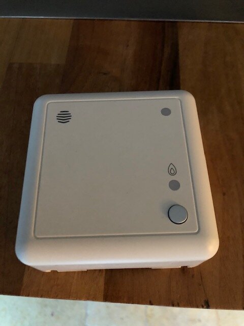

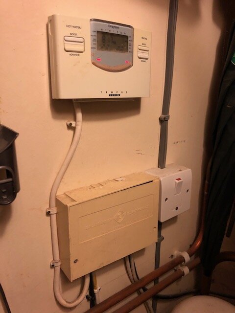

Hi Chris_W. Photos attached of existing Drayton (front and back)/ photos of Hive (front and back) and photo of the current Drayton in situ hard wired off to the Alpha boiler.

Okay your old clock was a 2 channel clock so it's a bit different to the Hive.
What you need to do is put the black wire in terminal 3, the grey wire (which won't be doing anything) in terminal 4.
Then you need to put a short piece of wire in to link L and terminal 1.
What have you done with the wire where the old room thermostat was? As I said before you can't just disconnect it.
It needs linking out.
As suspected and John says, you’re Drayton timeclock is a 2 channel (for heating and hot water control), which is why I asked if your Alpha is a combi boiler. John has provided with what you need to regards wiring, if you don’t have a combi boiler, you will lose any hot water timing periods, and consequently no hot water. If it’s a combi, you’ll be fine to follow John’s wiring and set existing thermostat to maximum or link out.
I wasn't sure what you meant about linking out the old thermostat so I have just set it to maximum.
