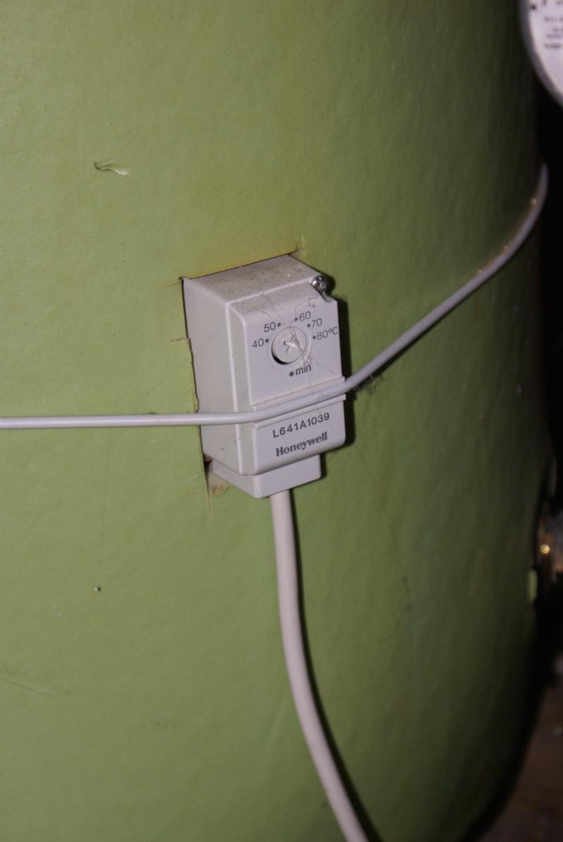

I have a tank stats on the hot water tank which goes to the programmer.

I have a tank stat on the hot water tank which goes to the programmer.
Do you mean something like this?
View media item 10596
,If so. it's probably there to stop the cylinder overheating in the summer. Would need to know how it was connected in the programmer.
It is an oil fired boiler with two pipes going to it as far as I can see.
Very unusual for a GHW/PCH system. Can you post a pic of the hot water cylinder and surrounding pipe work etc.

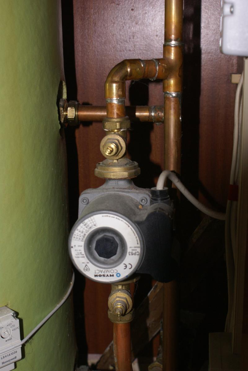

Thanks for your help here are the pictures. If we have a pumped system and replace the programmer then decide to upgrade later by adding a motorised valvle will we need to replace the programmer again, as I have an urgent need to get the thing up and running. so a quick fix then an upgrade I think might be the best option.

Presumably the connector at the top is the backplate for the existing timer.
On the back of the timer, there should be a switch. Can you say what it is set to?
Yes the connection at the top is the back plate for the existing timer.
There is no switch on the back of the timer or the bas plate.
There is the wring diagram that just says for fixed wiring
I would need to have more details of how your system was plumbed together to be able to make sensible suggestions. So all I can suggest, at this stage, is that you get a local plumber/heating engineer in to see the system and advise what you should do. You can then talk through the options and costs with him.
