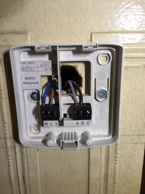

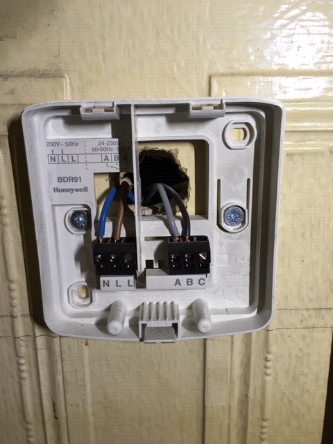

The existing thermostat is a Honeywell CM900, wired like this:

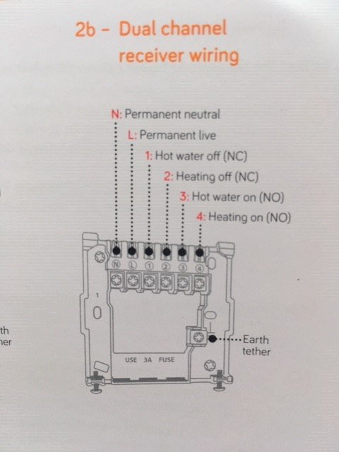

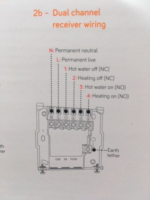

Using the Hive diagram

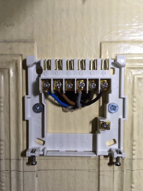

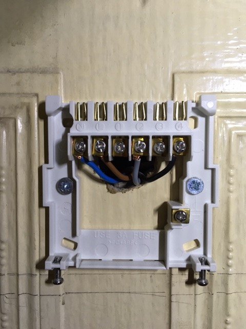

I have wired up the thermostat like this:
Does this make sense? I wasn't sure if the black or the grey should go to heating on, and whether a connection to heating off was needed.
Thanks in advance for any advice!!
Your wiring is wrong.
Before connecting anything, you need to find out where the black and grey wires are connected in the boiler.
The dual Hive may not be suitable, and even if it is, guessing will most likely result in things being destroyed.
Thanks for the response flameport, how can you be sure that it is wrong?
So I should only have one wire connected to heating on? What should the other wire be connected to?

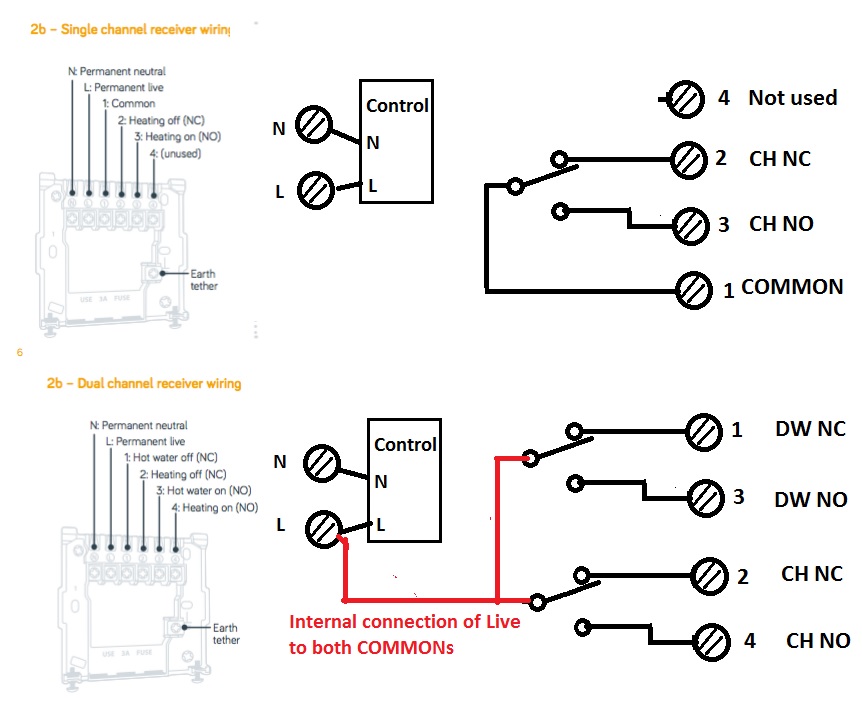

The dual and single are NOT the same.
The single channel unit does NOT put Live ( 230 volts ) onto the terminals that connect to the boiler.
The dual channel unit DOES put Live ( 230 volts ) onto the terminals that connect to the boiler.
Ok thanks Bernard. I guess I will try and return the dual channel hive and replace it with the single channel.
Once I have the single channel thermostat, which terminals (1-4) should I attach the grey and black wires (A/B) to?
Terminals 1 and 3 on the SINGLE channel receiver if the boiler requires Volt Free contacts. But check with the boilers instructions as to the mode the boiler works in ( Volt Free or Switched Live )

DO NOT power up the system as you'd connected it - this is almost certain to destroy the controller board in the boiler. The connections for the thermostat need what is termed "volt free" switching - this means that the external switch simply makes or breaks the connection but does not impose any voltage on it. In this case, the boiler uses an internal extra low voltage (24V) for control and this is unikely to be fully protected* against "misconnections". The dual channel device you have puts the full mains voltage onto the switched outputs which will blow the board in your boiler.
This is why it's not enough to just look at how the existing stat is connected. You have to look at how the other end is connected AND the manuals for both the boiler and the new stat/controller to ensure that they are compatible.
* Personally, If I were desiging such a device I'd at least attempt to make the circuits such that permanent damage wouldn't result from stuffing mains up the connections - and TBH it wouldn't be all that hard. But in these days when they want to shave every last ½d off the price ...
Also, DO NOT power up the system with the stat/controller removed from the terminal plate. There's lots of exposed bits of metal there, some (or at least one) of which will be live whenever the system is powered up. You don't want to risk someone inquisitively sticking their finger in :eek:
