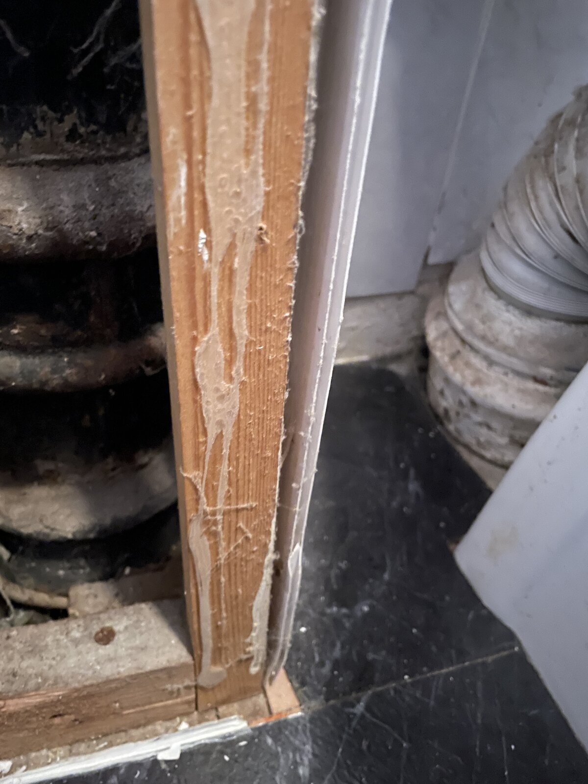

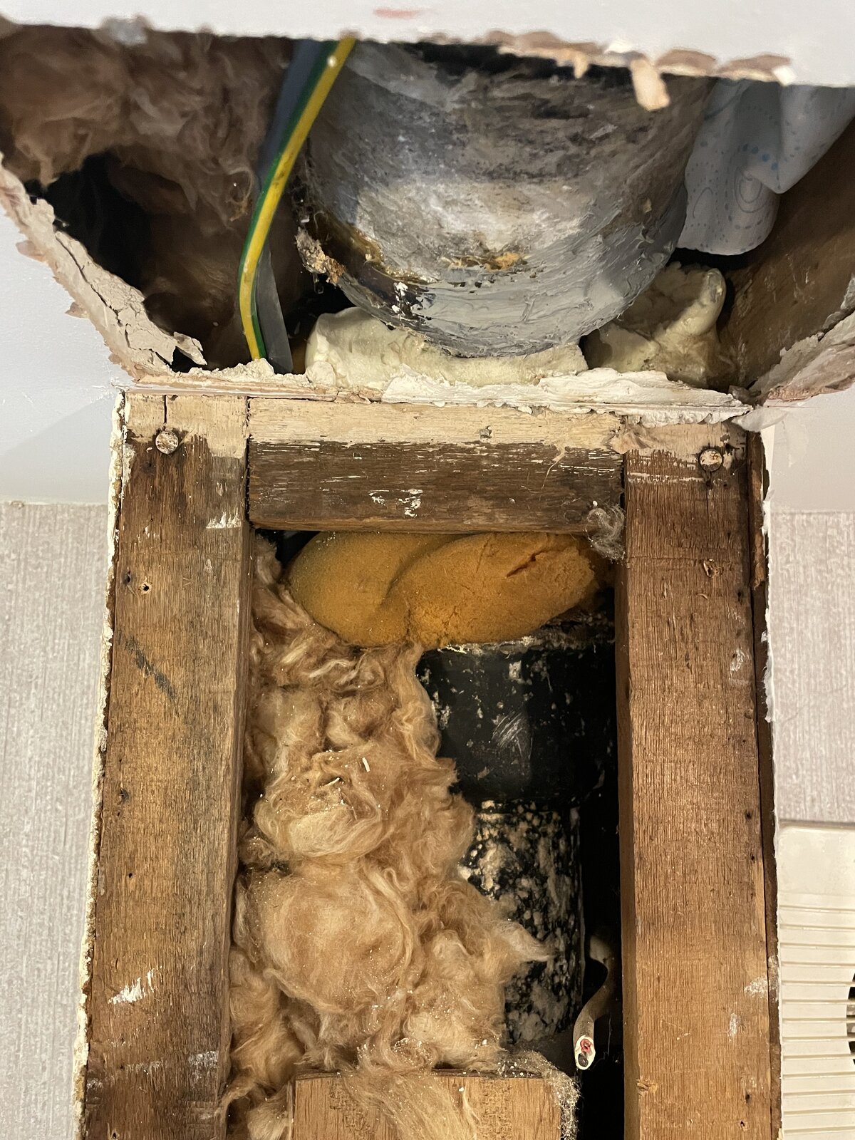

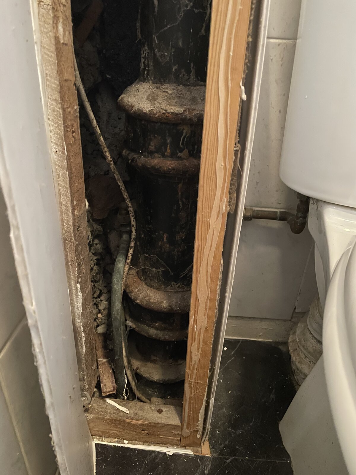

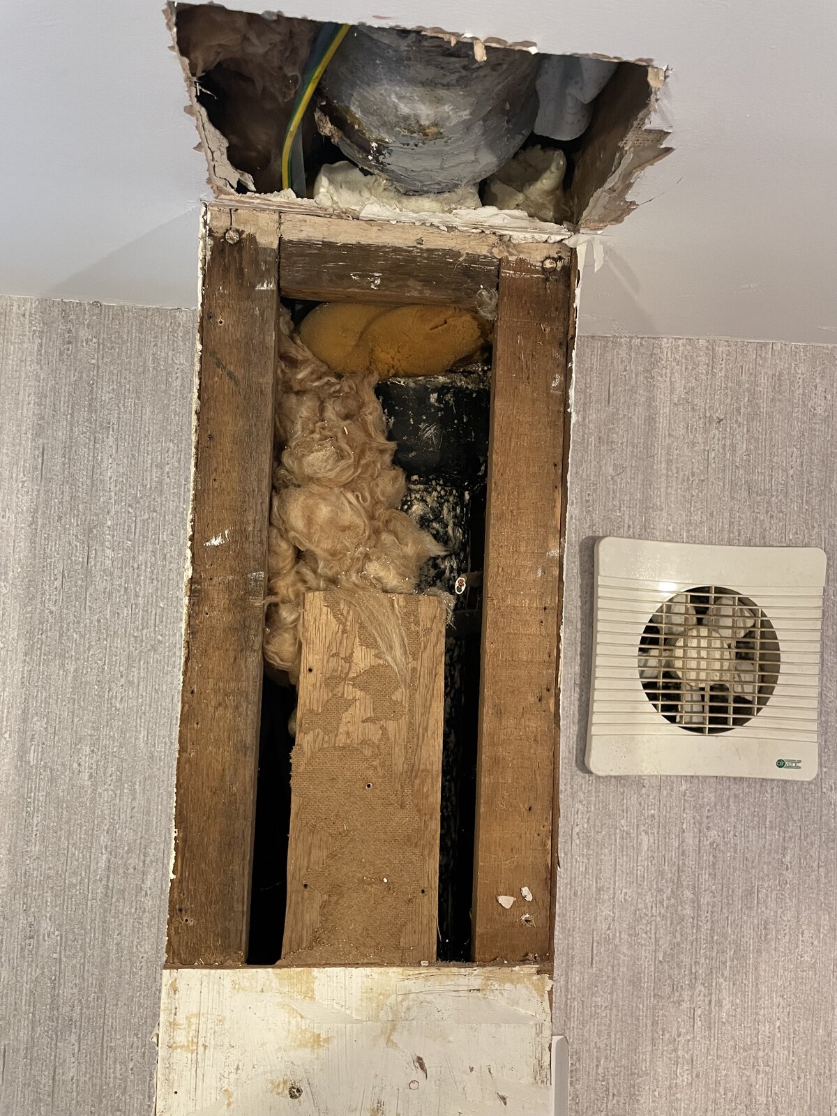

Internal soil stack of 1950’s built house. Comes up through a collar on kitchen floor and is boxed in to ceiling. There is an elbow coming off the soil stack that sweeps up into a collar in the first floor toilet. A flexible toilet pipe then joins this to the toilet. The soil stack itself continues up towards the attic. Parts of the stack seem to be cast iron, other parts are something else.

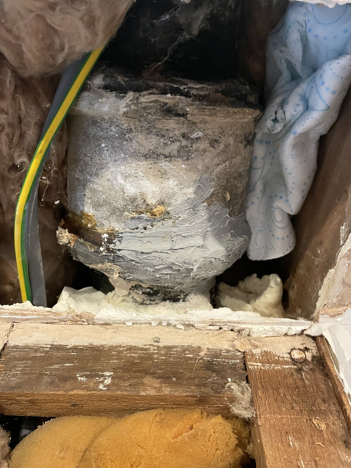

Water marks on the kitchen ceiling led me to investigate. There is weeping around the joint of the elbow from the stack to the toilet, it can be seen that this has had an attempted ‘fix’ previously.
Is it possible to remove this elbow and replace with a shiny new plastic one? If so, what would be the best way to go about this, as in how much of the elbow would need to remain in place to connect a plunge fit connector in order to add the new plastic elbow?
The toilet is getting replaced so now would be the time to make the plumbing right.
I’ll add pictures to make clearer what I’m trying to ask advice about.

Yep - certainly looks like a cast iron stack - not sure what that gray section is - maybe someone tried to wrap it and then seal it up. Only thing I would be concerned about would be asbestos but never seen anything like that type of repair in that material, maybe a bit of lead?
Only way to check properly though would be to strip it all back to the pipe and see what's what. Are the 1st three pics once the floor's been opened up but it's the same place as the last three with the stack and the pan connector to the right?
Hi Madrab, the first three pics are ground floor, you can see the main stack and the bottom of the elbow that comes off it that goes up to connect to the collar in the toilet floor. The second three pics are first floor in the room with the toilet.
If I tap the pipes or use a magnet, the stack on first floor seems like cast iron but the stack on ground floor does not ring out and does not take a magnet, neither does the elbow. Thanks.
Ah right - the first 3 looking up through the ceiling at the elbow Cast out to the toilet but the lower section of the stack in the wall that may not be cast, the 2nd 3 is the cast heading upwards into the loft.
That lower section in the wall could be asbestos painted black, again though hard to be sure without being on site, is the black section of the elbow beyond that grey bit magnetic?
No, not on the ground floor. I’ve looked everywhere I can and can’t see anything referring to a soil stack that is asbestos (possibly) on the bottom half and cast iron on the top half. Not something I’ve seen before. Got me stumped. The stack itself seems in reasonably good health, the elbow is a little worse for wear and looks to have had a smear of putty at some point.

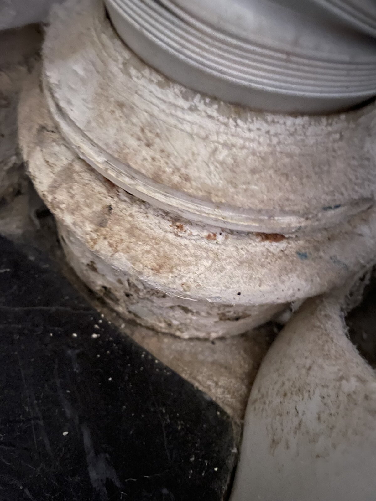

50's was the era for Asbestos cement products, plenty of properties built using AC soil pipe, rainwater and guttering. Looks very much to me in the picture like at least some of it is AC, the shape of the collars gives it away, and would explain why it's not 'ringing' when tapped and the magnet is not sticking.
Given I strongly suspect it is AC, then unfortunately there isn't much you can do with it, other than replace. I would be very wary of messing about with it, particularly as it's internal.
I'd hazard a guess, it has cracked at some point, and a repair has been attempted with some kind of sealant, although it does look rather like gap filling cement, used for plastic pipework where a solvent welded joint has partially failed.

Afraid I think 'with great difficulty' would be the answer. Not entirely sure how they made the joints with that stuff, but I'd imagine it would be a similar method to that previously employed with cast iron, i.e. some sort of rope gasket being stuffed into the socket, and the gap filled with mortar, putty or molten lead.
My worry would be, getting the joint apart without breaking the AC, (which is obviously the last thing you want to do.)
