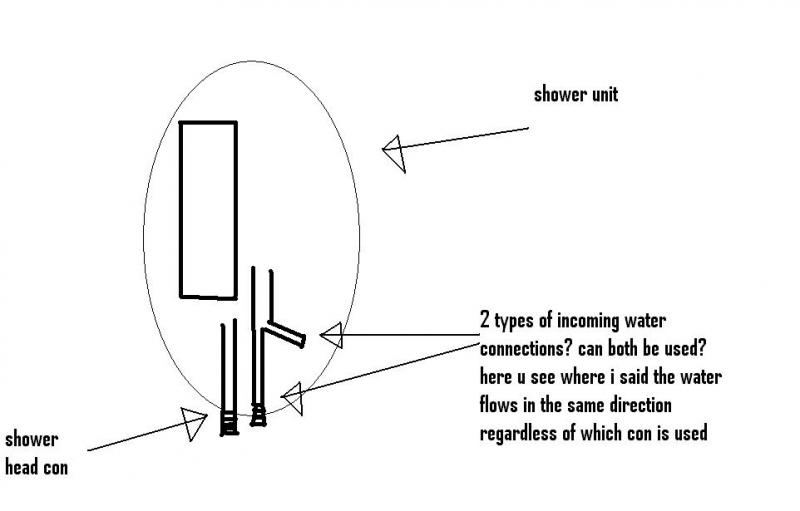

hi, can anyone help? i recently put an electric 8.5kw triton shower in but it wont cut off the water when its turned off by the stop button? water contiues to come out the shower? i read the manual and it says faulty stop button. I just wanted to verify this before i take the shower back.
Another thing i noticed is that there are 2 places in the shower where the incoming water supply can be connected to. each one has a different connection, one has a thread and the other is a push on. then of course theres the connection for the shower head itself. so theres 3 connections. can any of the 2 incoming connections be used? thanks.

yea the water flows constantly when the shower is turned off at the shower unit. I dont think Its nothing to do with the electrics. The 2 water connections that im on about are right near eachother in a sort of L shape so which ever one i connect the incoming water to, it will flow in the same direction. its quite hard to explain. Its just that if only 1 of these can be used i will have to get new plumbing parts. i agree with icgs, triton are not very good. heres a quick daft upload of what it looks like.

water running constant when just isolated at the on/off switch can be a fault on the solenoid or on/off switch or pcb.
isolated at the main pullcord will indicate a faulty solenoid only.
