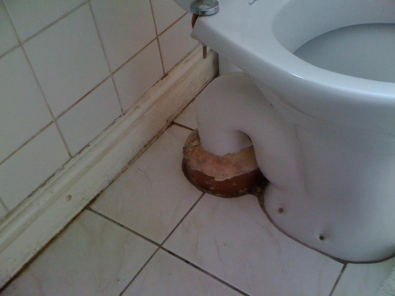

help please urgent toilet soil
29 Jun 2010
2
Devon
Right below you can see my toilet soil, it has a concrete/clay colar i have asked all my work mates and they say so carefully knock it out but i was thinking could i just cut it at floor hieght and place a pan connecter in there?
[/img][/b]
When you have taken the old pan away put an old towel or cloth down the pipe to stop any large bits of ceramic blocking your drains.
And watch youreself on any broken ceramic :!: it`s like a razor
I did a job like this at home the other month. I was really worried that the old pipe in the floor might crack lower down so I cut the toilet off at the u-bend then with more room disc-cut the collar to floor level (with rag in the pipe). Also helps as many new toilets will not have room for the bulky collar.
