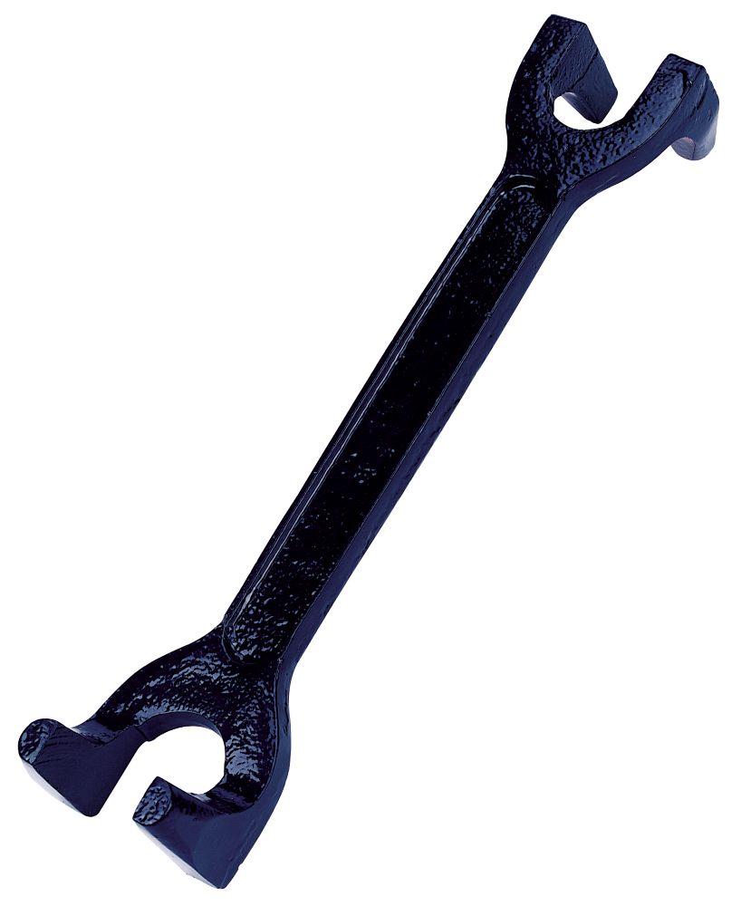

Hi, I'm struggling to remove some very old bath taps. Access is tight, I can remove the tap connectors but the back nuts are bigger than my 32mm box spanner, has anyone any idea what size they might be so I can try and source another spanner. Any other suggestions for removal would be welcomed.

Thanks for the suggestion, I already have one on these but it's too small to grip the back nut. I think there are larger versions but as I said there isn't much room.
Google "tap back nut box spanner". About a fiver from Plumb center. Would provide link but on phone so not easy to clean and p.
Thanks for trying but that's where I started. I have one but its 32mm and too small, back nuts are non-standard size; possibly 1 5/16 but I haven't found a way to get an accurate measure yet.
how about a basin wrench

BW: If a standard back nut box spanner does not fit, that won't either. I thought back nut's were more than 1 1/4, but then, I am not a plumber
